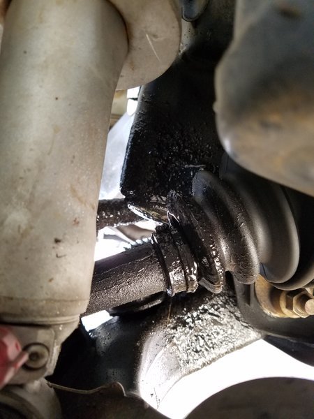

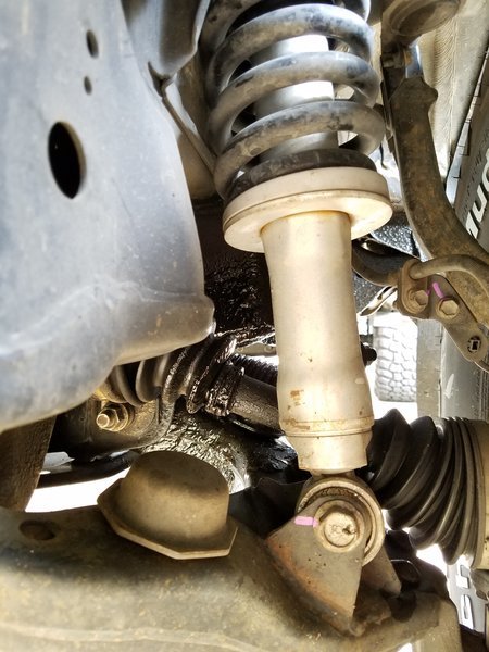

    Hey guys, i have a few questions. I have a 04 DC with a camper with a roof rack on it and bed drawers. If i had to guess between 350# and 450# when loaded with all my gear. On the front i got an addicted offroad bumper im planning on installing soon with maybe a winch too. I currently have stock, springs, shocks and leaf springs with a spacer block lift. I needed the lift to fit my new 33x12.5x15 mud terrains.Yes spacers suck, but they gave me the look i wanted. (See current pic)
    BUT at a price. Both inner cv boots shit the bed. They blew out at the smaller clamp end at the inner axel side.
    Cheap fix (approx $300 in parts and tools + my time: replace the boots and add a diff drop. Then cross my fingers that this fixes the issue.
    Pricey fix: trash the block spacers. Invest in some height adjustable shocks and rear leafs to maintain the height need for my tires to still fit and support the added front and rear weight.
    What set up would you guys recommend I go with?
