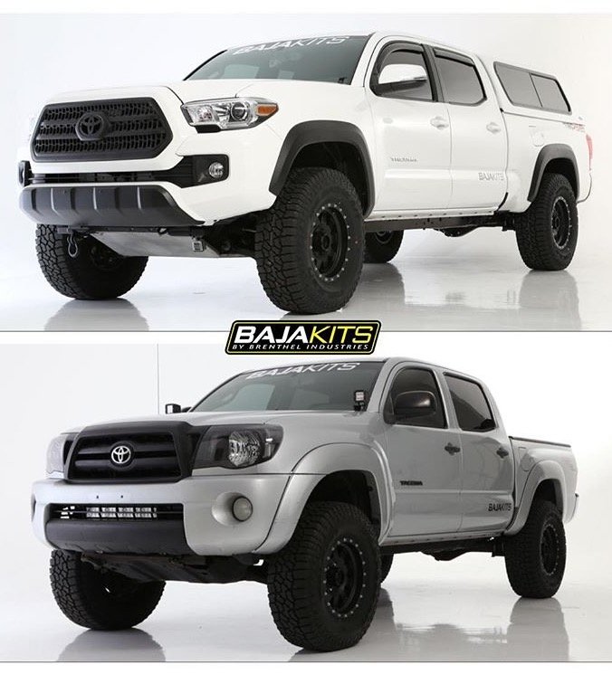

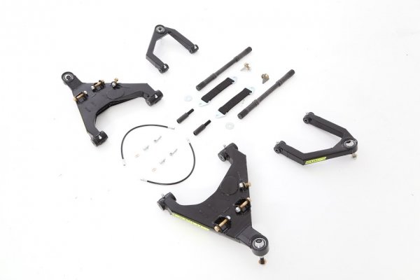

    Does any here run or know someone who is running the Baja Kits - kit?
    http://www.bajakits.com/i-26499173-...4wd-2-prerunner-kit.html?ref=category:1339668
    Some info on the kit:
    Description
    Baja Kits Plus 2 suspension is just that a bolt on 4" total wider track width making for more wheel travel, increase on and offroad stability, ground clearance, larger tires and shocks. This kit is made to fit perfectly on your Toyota by replacing the stock rubber bushings and ball joints with Trophy Truck quality zero deflection Delrin Bushings and Uniballs, the strength and handling qualities are substantially increased. We also increase the caster angle to get rid of the loose front end feeling that often occurs with mid to long travel suspension kits. This kit is designed to be paired with 2.5 coil overs and optional 2.5 bypasses which can be installed upon initial install or later down the road (Bypass mounts will require welding)
    The Baja Kits Advantage:
    - CAD designed boxed UCA
    - Trophy Truck grade Delrin bushings with grease fittings for industry leading durabilty and a quiet, no squeak ride
    - 1" Hi angle Trophy Truck grade uniball's replace the weak stock ball joints that fail under hi angles and loads seen from normal offroad use
    - Our CNC machined corrosion resistant misaligns have a tapered snout to adapt your stock upright/spindle with ease
    - We've increased the caster angle that you lose when lifting a truck with stock arms to regain on road stability, handling and alignment
    Technical Specs:
    Track Width - 2" Wider each side
    Wheel Travel - 11"+
    Lift - 3"-4"
    Product Requirements:
    Shocks - Aftermarket Replacements Shocks, Custom King Shock, Bypass Shocks
    Tire Size - 33" are recommended for most, 35" Are possible but an aggresive option
    Wheels Size - 16" or 17" with Max Backspace of 4.75"
    Fenders - Fiberglass Fenders or Trimming of stock fenders is needed (35" will require fiberglass & significant body mount mod and trimming)
    Parts Included:
    **Kits come pre assembled and ready for install, as seen in product photos**
    Boxed Upper Arms
    Baja Kits Badges & Rivets
    Delrin Bushings
    4130 Crush Sleeves
    Zerk fittings
    1" uniballs
    Countersunk Top Misaligns & 12 point bolts
    Tapered Misalign Adapters
    Boxed Lower Arms
    Delrin Bushings
    4130 Crush Sleeves
    Zerk fittings
    1" Uniballs
    Shock Bolts and Nuts
    Additional Items
    Brakelines, Fittings,Adapters and Copper Washers
    Zinc plated CNC Steering Extensions
    Limit Straps with Hardware & Weld on Frame Tab
    Extended Heat Treated Axles (4WD trucks only)
    Install Guide
    Baja Kits Sticker pack
    Install Information:
    Level 2 Install, Bolt on (Minimal Welding Required if Adding Limit Straps)
    Install Time: 8 hours (Times will vary depending on knowledge and skill level)
    Pictures of the kit (shown on both a 2nd and 3rd gen:
    Catfish21 and JT@Bajakits like this.

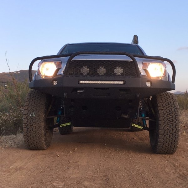

  5. Sep 11, 2017 at 10:52 AM
    #1225
    JT@Bajakits
    JT@Bajakits Well-Known Member Vendor
    Jan 26, 2016
    #176129
    607
    JT
    Race Trucks and Off Road Suspension
    Here are a few of my customers that have ordered the kit.
    @DannyBFresco @LTDSC @WVUManiac97 @buyobuyo
    You can also jump onto Instgram as we have a few customers that have our kit as well...IG: @maxx.powell and IG: @trd_superpro
    if you have any questions, please let me know!
    JT
