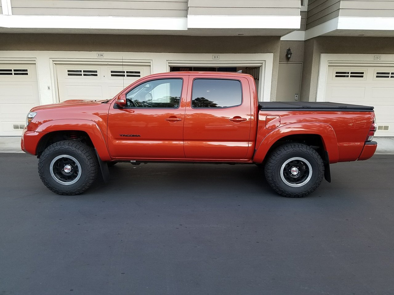

    @HeadStrong Off-Road.....I just bought a stock 2015 TRD PRO with 23,000 miles and want to "correct" the rear squat cuz it just plain bugs me. I measured the center of the front hub to the bottom of the fender well and it measures 23" and I did the same in the rear and it measure 22.50" which means the rear squats 1/2". I measured with the bed empty except for the Extang Solid Fold 2.0 tonneau cover. The only thing I did was install new BFG KO2 265/75/16 tires.
    I was think about installing your front HS 1/2" Top Plate Spacers - TT05512-TPS which would raise up the front 1" as well as installing the HeadStrong 3 leaf progressive Add-a-leafs with u-bolts - HS-TOY055-3AL WITHOUT the stock overload which would raise up the rear 1.5". If I do both of these then not only will the truck be raised up but it also should be level right?? I think this slight lift should look great and if it levels the front to back then my OCD will be happy!
    Also, what is the difference between the Headstrong AAL and the Icon 1.5" Progressive AAL-51100? Is it worth the additional cost for the Icon AAL versus the Headstrong ones? I want to keep the stock shocks in back and also I want to keep the stock coils and struts in front. If I install the HS 1/2" top plate spacers and the HS 3 leaf progressive aal do I need to change the stock front struts or the rear stock shocks? and do I need extended SS brakes lines for the front and/or back?
    I look forward to your reply & Thanks for all of your help!!

    Very nice looking truck you have there. PM Sent :)
