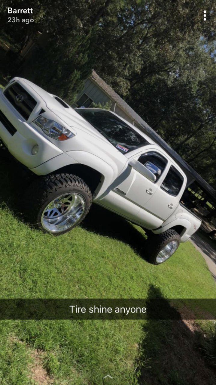

    Okay so I have a question for you guys, I have a 2009 Toyota Tacoma 4x4 trd. I have a pro comp stage 2 but I need more height to clear my 35’s. Can I run bilstien 5100’s with 3” cool springs and my pro comp spacer to get me to like 8.5-9.5” up front? Over the way less affordable but a lot better king, Fox, icon coilover etc. option

    You want 9" of lift to clear 35s? I clear my 35s with 2.5". You're doing something wrong lol.

    I have 14 wides with -63 offset

    Like I said :p
