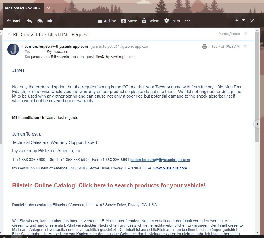

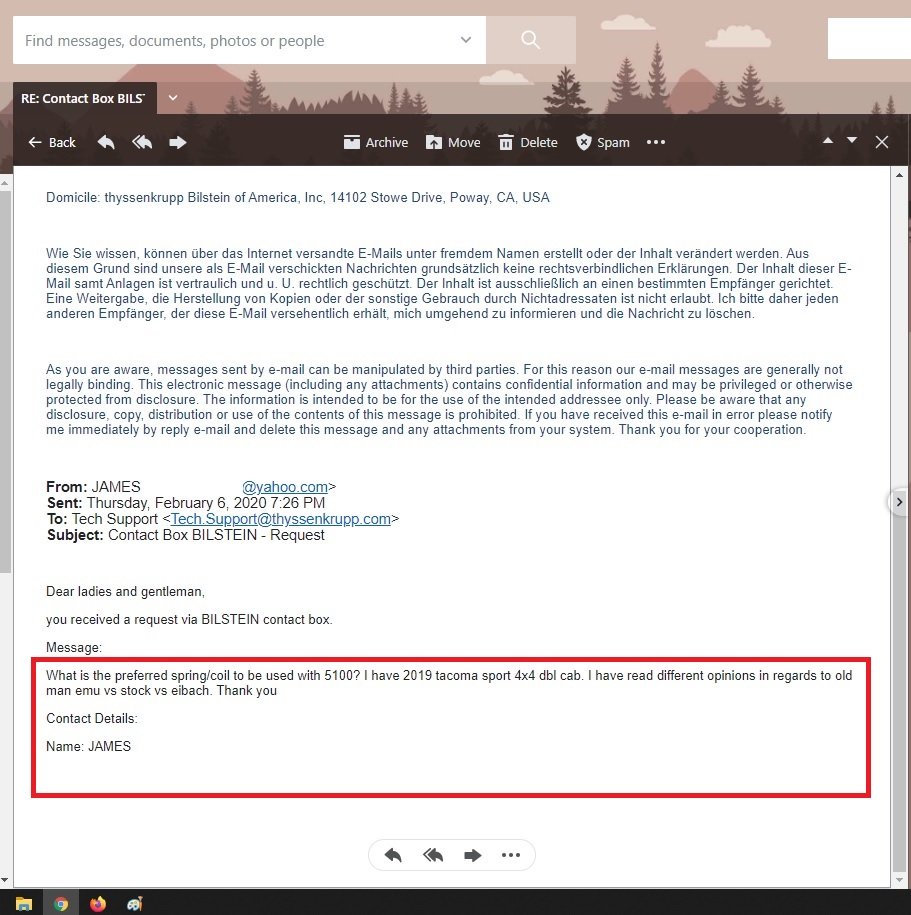

    I am a new Taco owner and love this site almost as much as my rig. Like many here I have been looking for info on suspension and lift so I emailed Bilstein and asked what is the recommended springs/coil combination with the 5100...see below

    GilbertOz and 71tattooguy like this.
