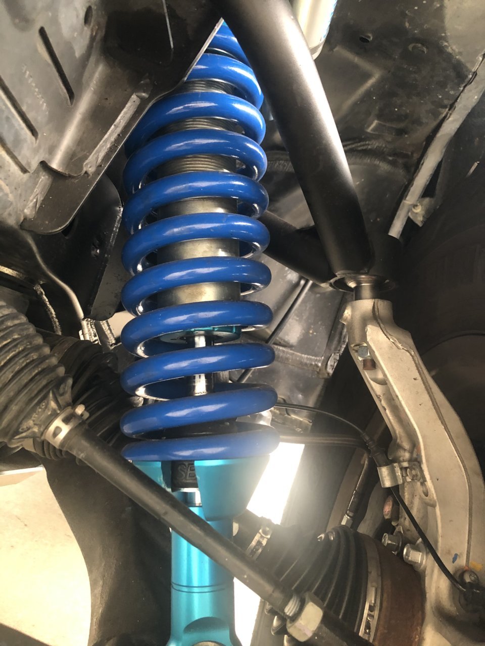

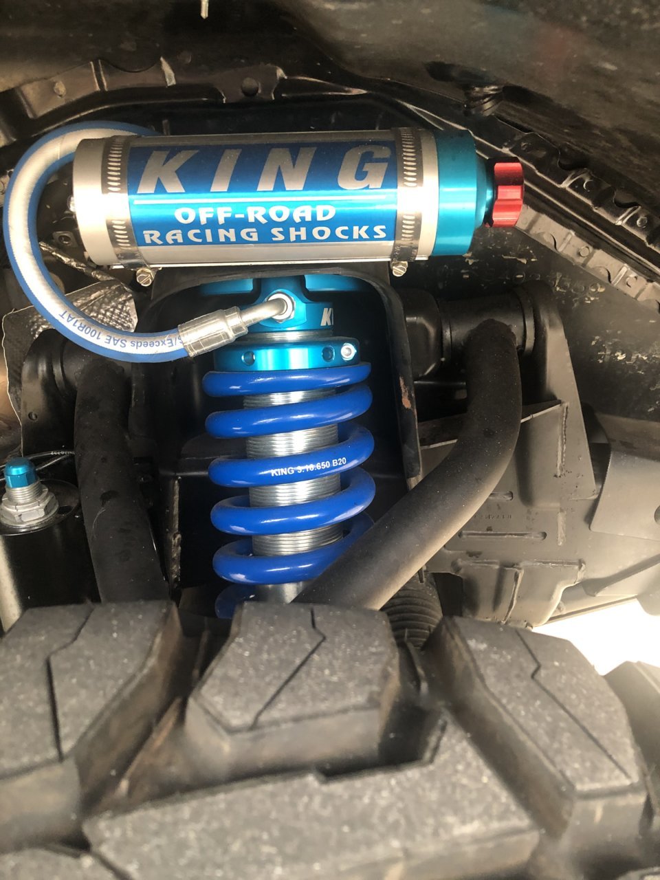

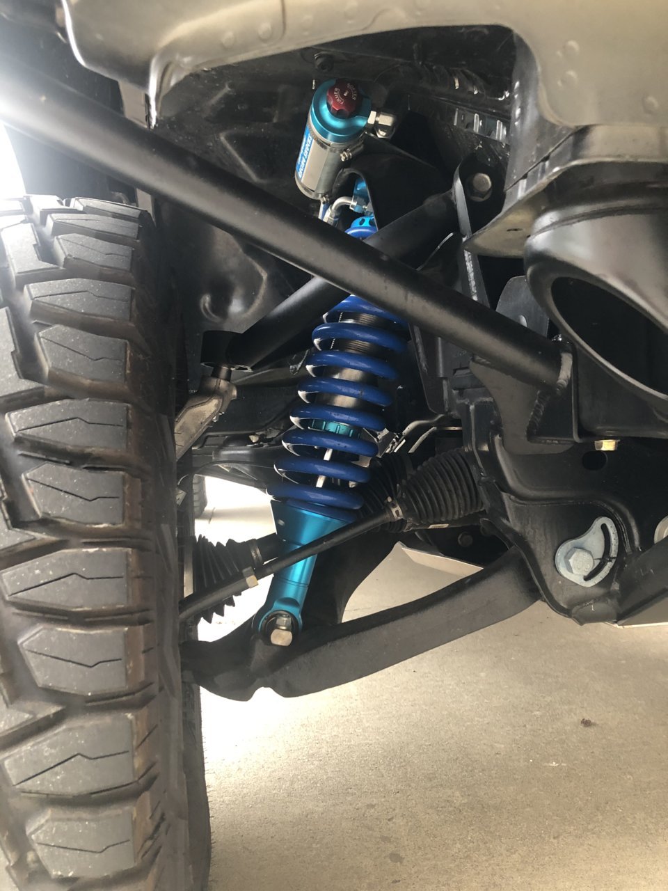

    I have King 2.5s with resis for front and rear (25001-121/25001-119 non-adjustables) with a Deaver AAL in the rear inbound.
    My plan was to set the front at 1.5" to match the 1.5" I will get from the AAL to keep the rake. At 1.5" of lift in front, I believe I don't necessarily need UCAs but if I did decide to go higher, my plan was for a set of SPCs. As for the rake, I don't really care for leveled trucks (just a personal preference). Mainly because they always "appear" to be squatting and I believe (personally) that appearance is significantly increased when the bed has load unless you throw on some seriously heavy duty leafs (aka $$$).
    I describe my goals as sort of like an "OEM+" lift without dumping money into stuff that looks cool but I won't get the full use out of. I want more lift and ability to fit a 33" tire (285/70R17). I am looking a better performing suspension for moderate off-roading without killing the daily drivability. I also want to increase the bed weight capability and/or tongue weight for towing to prevent squatting. All of that with respectable durability to keep the scheduled maintenance intervals spread out and any necessary replacement costs low (for instance an SPC joint is easy to maintain/replace than a uniball joint).
    Kings are expensive, but I got a smoking deal on them so I figured why not. They have one of the best reputations out there and I doubt I will ever do anything to put a dent in them but if do, rebuilding them is still on the table.
    NOTE: I am also a rookie with regards to Taco suspensions and am figuring this out as I go. The above is my plan (so far) and has been constantly changing as I go.
