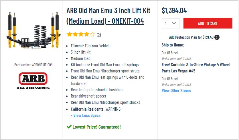

    Anyone running this lift kit? Was planning on getting ICON billet UCA's as well. Want to be able to slap some BFG 285/75/16's on my 2019 TRD OR.
