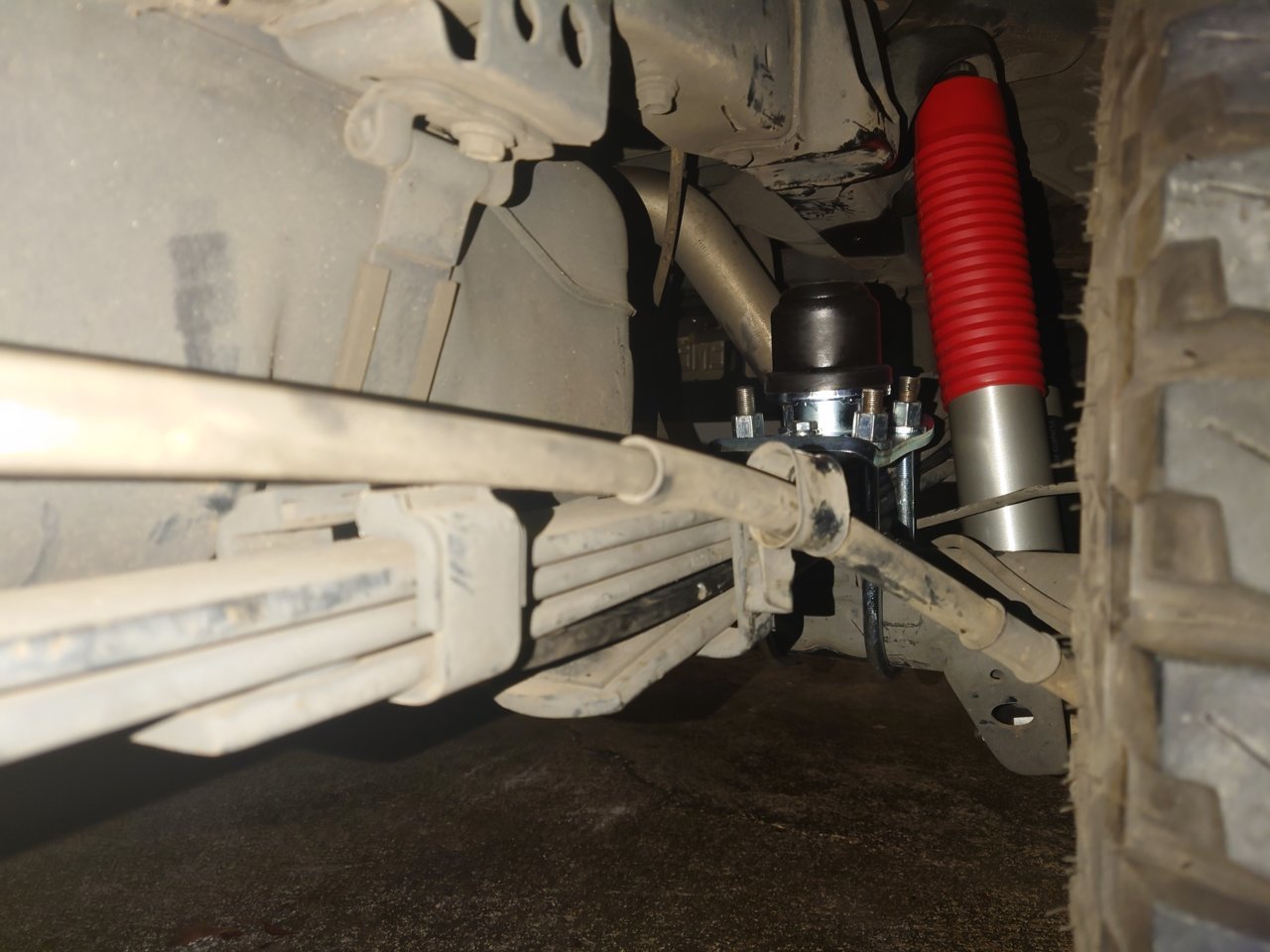

    So I just installed Wheeler's single 1.5" AAL and u-bolt flip kit with super bumpstop last week. Including 3/8” spacers up front. I have TRD Fox all around.
    The front sits perfectly even, however the rear left is slightly higher by an inch. Also when on a lift, the rear axle has a noticeable droop on the driver's side. Is this normal?
    I have gotten an alignment, and while it drives straight for the first couple of days, it will then have an ever so slight pull to the right by the end of the week. I have brought it back in for alignment to see what is up. The techs are telling me that while the fronts are good, everytime they align, bounce then recheck, they have noticed that the specs in the rear changes.
    For the AAL install, I did it will the leafs (leaves?) still on the truck. I have torqued down all the bolts and nuts to spec.
    One other thing that i did notice, is that the ubolt flip kits striker plate is slightly bent. Thus slightly bending the ubolt. Not sure how it got bent though, as the passenger side is fine, and i worked on that side first.20210110_213415.jpg
    However, Ryan from trailgear said it was fine, and that there should be no issues.
    If anyone is more knowledge on this matter, any help would be appreciated. Thank you in advance.

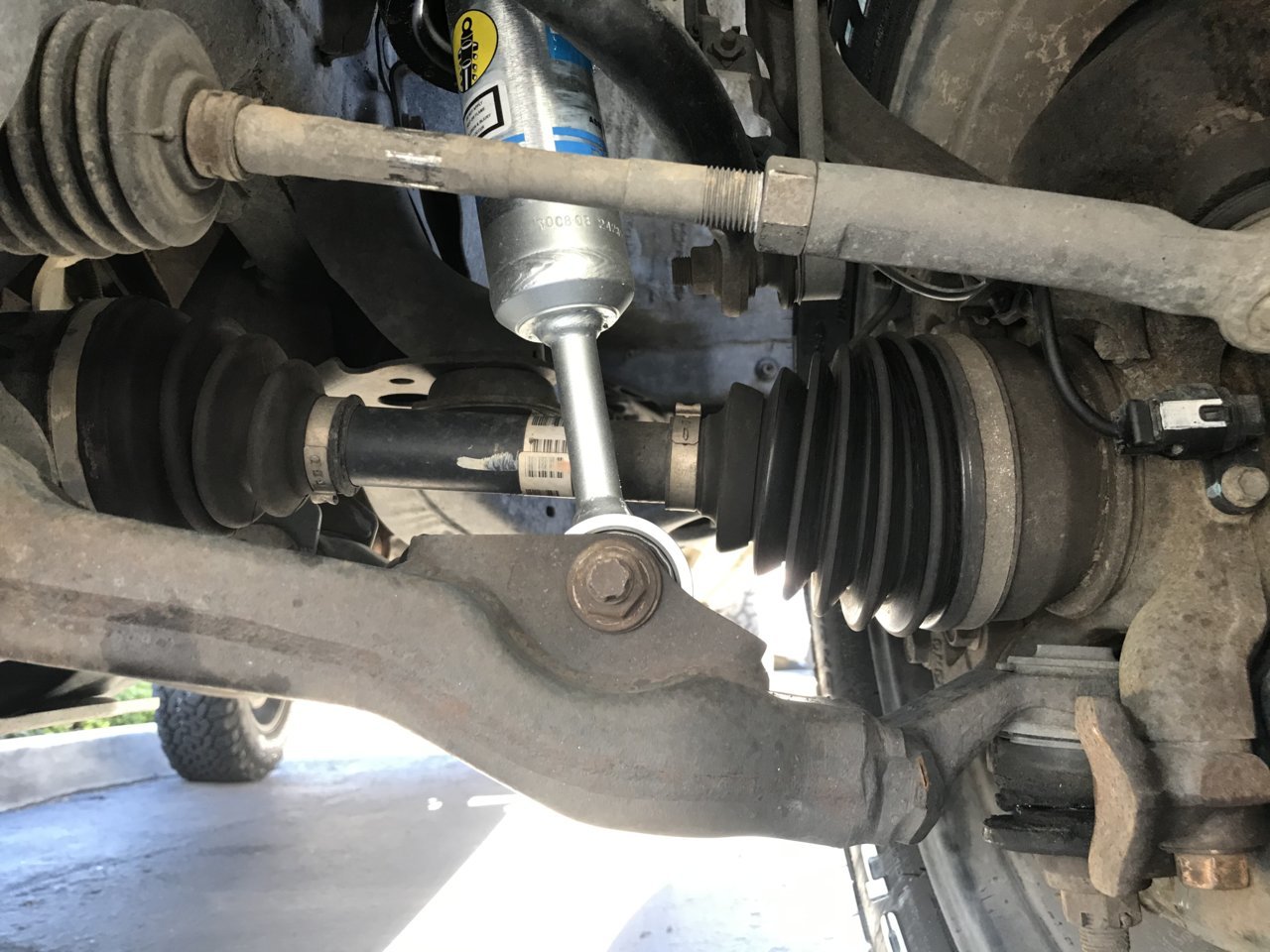

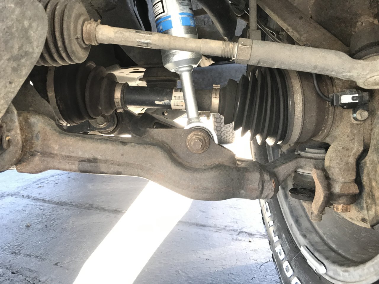

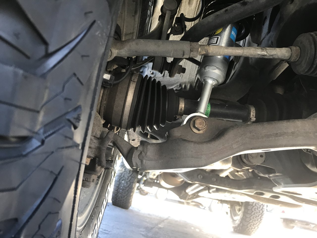

    I have a quick question that I wanted to throw out there about my 2011 Tacoma DCSB. Hopefully this is the right place/thread:
    2011 Tacoma DCSB w/ OR
    143,000 miles.
    265/70/R17 BFG ATKO2
    Previously had Eibach coils on 5100's set to the first notch (lowest setting) for leveling. That setup worked great, but started to sag so I just gave the suspension a refresh.
    Just installed:
    New 5100's on the lowest setting with OME 885 coils. Wanted to try something new.
    The truck is sitting a little prouder with the 885's which has me a little worried about the CV boots/axles/bearings etc, that everyone is always discussing on TW.
    Drives great, but I feel like there might be a little vibration (prob in my head), but IMO everything looks the same as before. I have attached a few pics of the CV axles to get opinions on whether or not the angles are too excessive.
    Thanks for the input.
    *****UPDATE*****2/11/2021
    After getting replies and doing more research I ended up replacing the ECGS bushing. I have had it in for about three days and all seems to be back to normal.
    Thanks for all of the help and suggestions everyone provided.

    Those angles don’t look bad. Did you have an alignment done? Is it a vibration or like a grinding feeling? If it’s a grinding feeling, have you tried locking it in 4wd while driving down the road at about 20 mph? If the feeling goes away then you need to get the clamshell bushing from ECGS. That’s a very common issue. When I had my ‘17 and lifted it, it started the grinding. Had the bushing changed and it rode smooth afterwards.

    Thanks - got the alignment done right after I put the coils, shocks, and tires on. All was good with the alignment.
    I wouldn’t say it’s a grinding - more of a vibration. It might even be the sounds of the new tires on the street. Idk.
    I will give the “4 wheel drive test” a shot and see what happens. When you experienced your vibration was it really noticeable? This is barely noticeable to where if ask the pax if they hear/feel it they can’t pick anything out.

    Mine was to the point I would have thought it was new bigger tires rolling, but fortunately I hadn’t put new tires on it. The new tires came in and I had the bushing replaced. It rolled quiet then.

    I ended up getting the ECGS bushing replaced and all seems to be back to normal thanks for the input.
