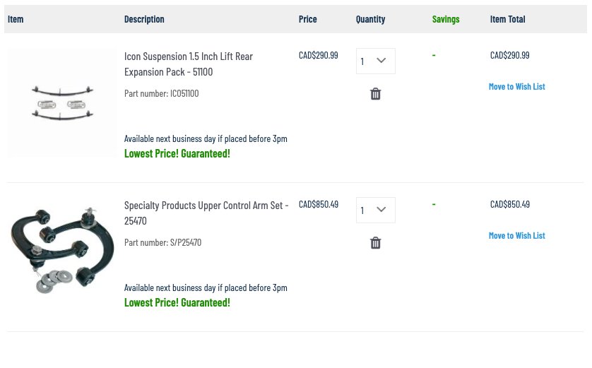

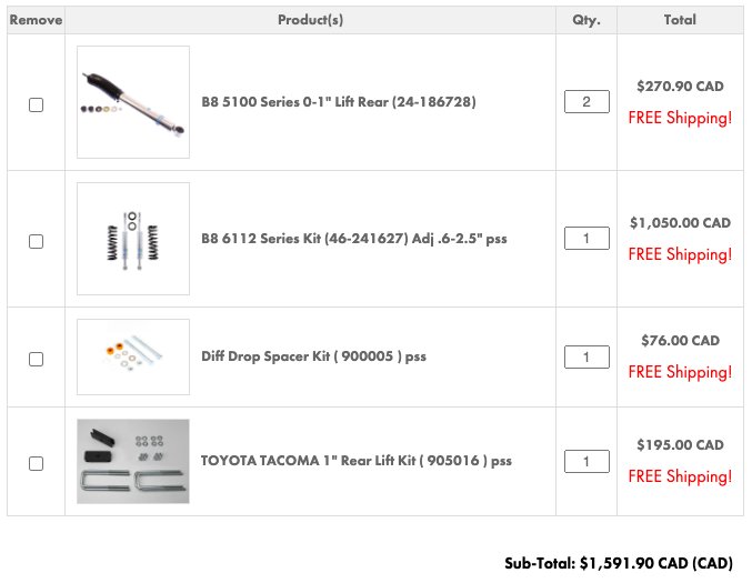

    Here is what I'm thinking for a 2 inch lift for my 2009 Double Cab Off Road
    Front
    Bilstein 6112 Kit with Springs (46-241627)
    Specialty Products Upper Control Arm Set - 25470
    Rear
    Bilstein 5100 Series 0-1" Rear Lift (24-186728)
    Icon Suspension 1.5 Inch Lift Rear Expansion Pack - 51100
    Bilstein 1" Rear Lift Kit (905016)
    Bilstein Diff Drop Spacer Kit (900005)
    H3llRid3r likes this.

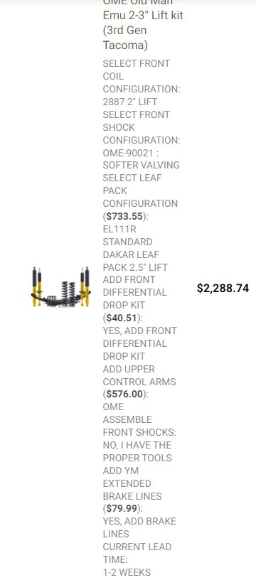

    So now I am looking at this kit...
    https://www.4wheelparts.com/p/arb-o...kit-heavy-load-omekit-005/_/R-BHWQ-OMEKIT-005
    Looks like it ticks all the boxes!
