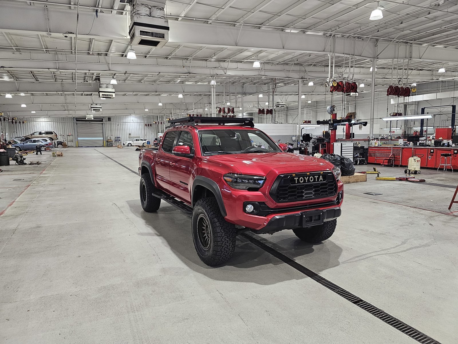

    So, I'm currently running a 3" level kit from rough country. I planned on doing a whole swap to maybe Dobinson shocks and old man emu leaf springs. Is there a way to predict what I would need to maintain it level and not return to a factory rake or a slight Carolina squat if I plan on adding a smartcap and front and rear bumpers and gear? I'm just trying to plan ahead so I can. Do it right the first time, also explaining anything in layman's terms would be greatly appreciated as I'm a sailor, not a mechanic.
  18. Apr 19, 2024 at 6:10 AM
    #1498
    Akguy
    Akguy Well-Known Member
    Jun 21, 2022
    #399830
    209
    way up north
    23' Silver OR DCSB
    DAMN! you have an awesome garage!
  19. Apr 19, 2024 at 6:18 AM
    #1499
