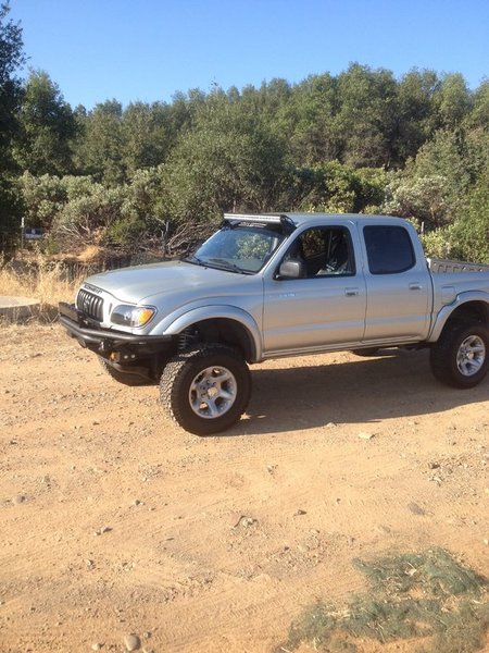

    I agree with everyone above with the exception that if you do get new Eibach coil springs in the front you'll have to adjust your setting of 2.5 to the stock setting on the shocks. But only if you get 3"Eibach coils. That's what I have in the front of my Tacoma. The adjustable 5100's with 3" Eibach springs only difference is ToyTec says to put them on the stock setting since you have 3" springs but I put mine on the 2nd setting for a little more lift. I also have Camburg UCA's too. 5100's in the back with a 2" AAL. The only bad part of lifting the front more than the recommended stock setting is I go through a pair of CV Axles every year. Even with a Diff drop. Just my opinion. If you use your stock springs in the front then that setting is fine
