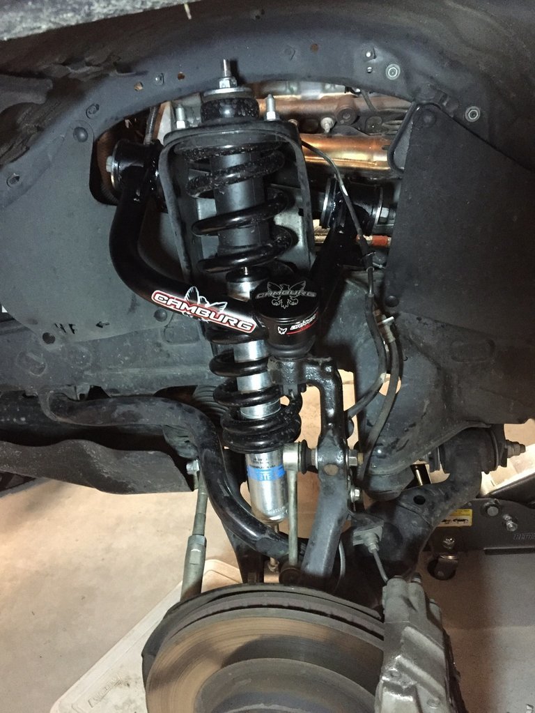

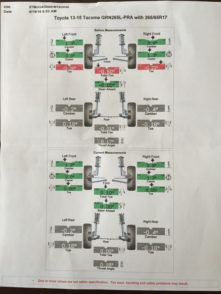

  16. Apr 19, 2016 at 4:48 AM
    #36
    Arpatton86
    Arpatton86 [OP] Well-Known Member
    Nov 9, 2014
    #142003
    233
    Ontario Canadia
    2017 DCSB TRD OFF-ROAD OV TUUUUNED
    Whelp I got the new upper control arms installed last night. I started with the passenger side and holy shit did that wheel well put up a fight. I literally had to beat it into submission in order to get the UCA cross bolt out. Driver side went in smooth/ very little bending of the wheel well. Getting her alligned now. 1125DDE5-9865-41C4-B0D9-F0E81BF80708_zps_d7d10d10f461a740e3ca35df6777bf4f30e50560.jpg
    E0A8D6DC-EFEA-4BC0-82A7-40A751AD68B7_zps_f0c813220d8d62e72c0096d37b6406fc6eb9d87d.jpg
