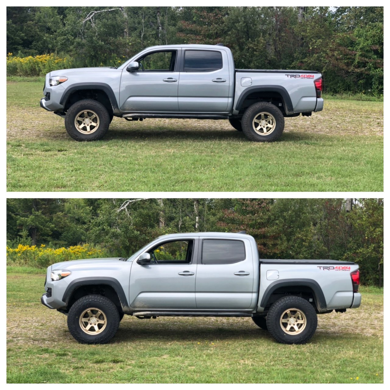

    You will need wheel spacers on factory wheels. 3/2 spacer 265 top pic 285 bottom. Also doesn’t rub anywhere and didn’t have to trim anything. I’m running 0 offset on these. 265s are SL wildpeaks and the 285s are E rated wildpeaks. The SL version is a crap tire.
