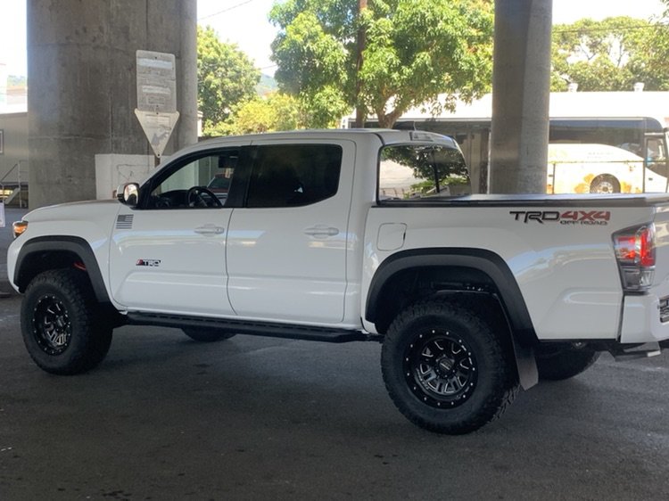

    Very easy to fit 33" tires. Contact Headstrong off-road they are in Cali. Not sure if they are near you? Don't go over 3" for a lift. (I'd do a 2"-2.5") Get some SPC UCA's and set them at "F" or "G" and have your alignment shop adjust your Camber with the UCA's. Should clear the cab mounts. (No need for a cab mount chop) May need to trim some plastic from the front bumper area but very minimal. Stay with 8" or 9" wheels with approximately 4.75" BS and you should be golden! I'm able to fully stuff my 33" tires no rubbing, on a 2" lift. No cab mount chop.

    Yes Wheeling. I built this Tacoma Specifically for mountain trails to go hunting. (Yes I have different wheels and tires now)
    This was my "mall crawler"
