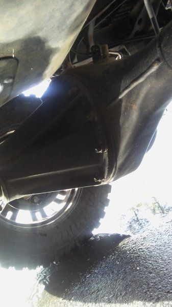

    Yeah those diagrams are all about the old stuff. It's not just grinding the little notch. 10mm studs/14mm nuts vs 8mm studs/12 mm bolts, different shaped diff cover and slightly larger diameter bolt pattern and flange....
    Yes, it can be done with a special jig and a LOT of fab work but it's not the fairly easy deal you have in mind

    I'll run the vin. But at this point you will need a full e locker axle, the wires that run from the axle to the truck, and an e locker 4wd controller if you want to swap one in. If you really are into off road and have $$ then just re gear it and put in an arb
