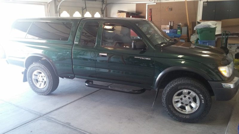

    Well, i fixed it. It was just 1 little tube I forgot to put on that was hiding underneath the top intake housing! It's in great shape for 16 years old, and I just detailed it after it was smothered in mud and dust. I got a pic of it.
