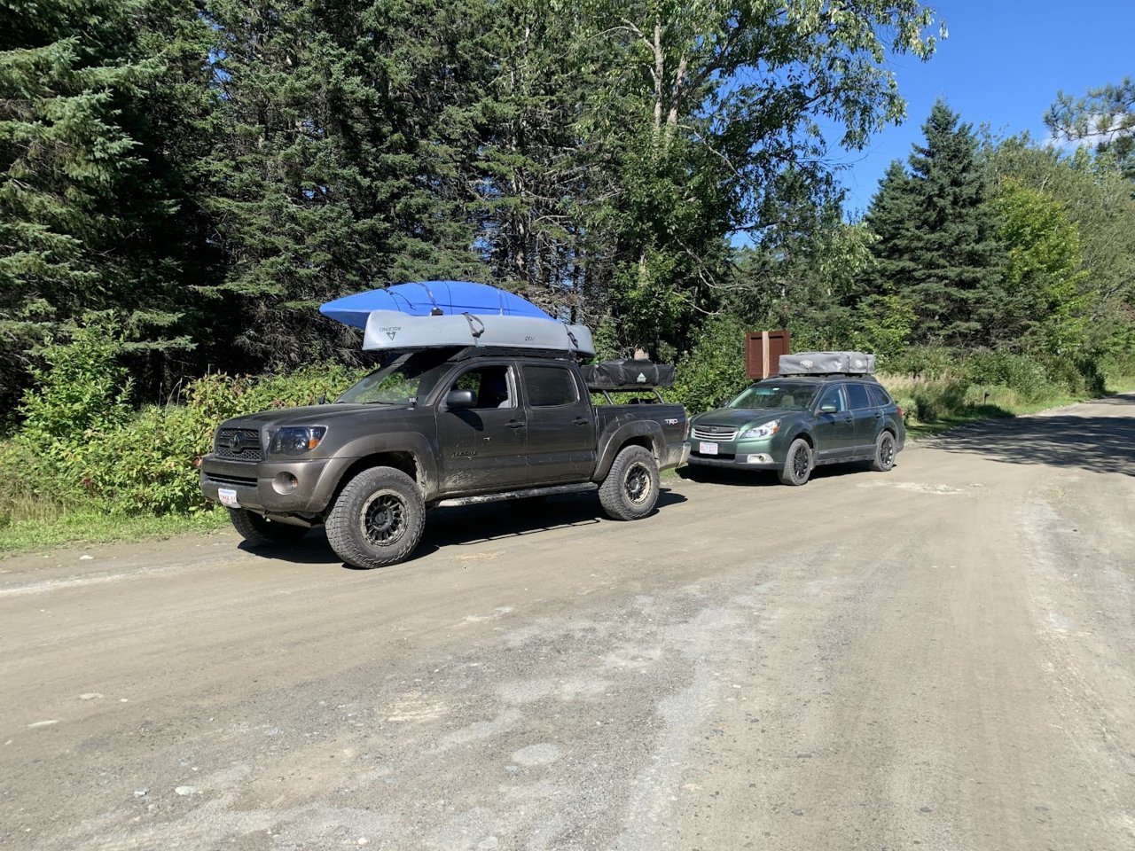

    With a low height bed rack I may have lost 1 mpg or maybe nothing. Hard to say. The kayaks bring it down to 15 or 16 though.

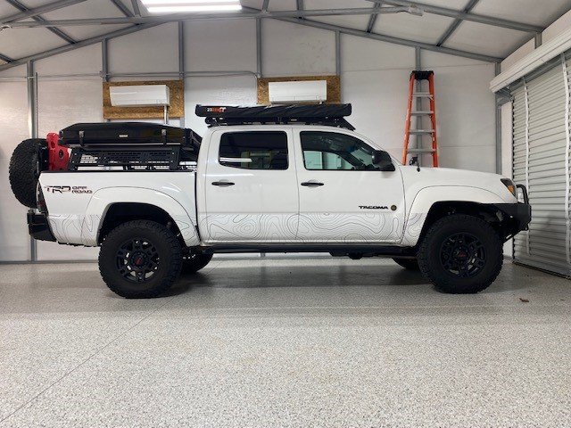

    Not to bad. I usually carry a kitchen bin, miscellaneous bin, a table and a chair with room to spare. My fridge is mounted in the backseat. If I want to make a dump run I take the 4Runner :)
