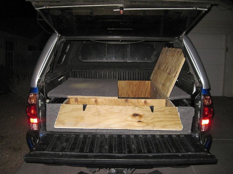

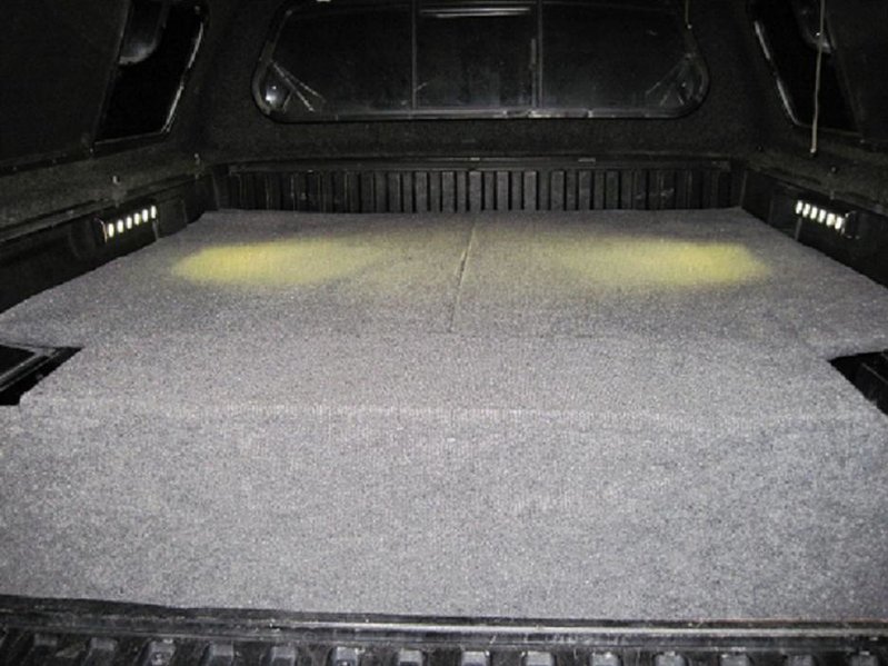

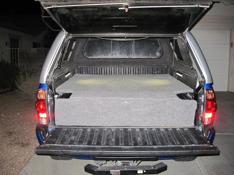

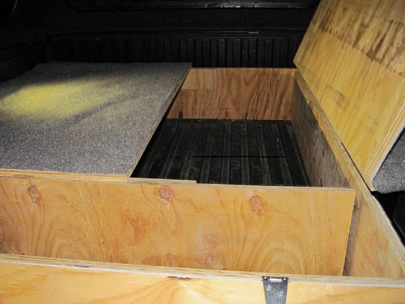

    I threw this together in a couple of hours for my DCSB. Cost less than $100 at Lowes in materials. Didn't know if I was supposed to post here or in the mods forum, but I thought I would post it here. It would be more useful here. It is 3/4" ply, and is 56" X 59". The bed of the truck is 60" long, but if you don't take into account 1" for the track system, you cannot open the door to get underneath. The vertical supports are 9" tall. The first storage bin is 48" long, and the smaller is about 9". You could sleep on top of it, and still have room underneath for camping gear. The top is in four sections, the middle two are 21" X 48, and the middle right one is hinged so you can get underneath to your gear. I left it open on the sides so you can get to the factory cubbies in the bedsides, and the 110V outlet to run things that need to be ran. (Like a small fridge). The lights run on 6AA batteries each, have a common wireless switch, and are $29 at Sam's club. I am planning on getting 2 more of the lights and mounting them on strips from the camper shell, since the switch will run any of these lights within range. The carpet was an outdoor rug that I stapled down and cut with a razor knife. A long bed would almost be the same, just be a little longer, and have room for a couple more doors/storage areas near the cab. PM for details, questions, or comments.

    It's like a truck bed in a truck bed! :cool: :thumbsup:
