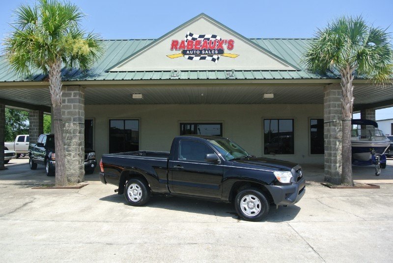

    Disclaimer: I'm brand new to the world of Tacomas -- found a killer deal from a friend who owns a car dealership and will be buying a 2012 2-dr 2WD base model this coming weekend -- I am stoked. (pic from the dealer below)

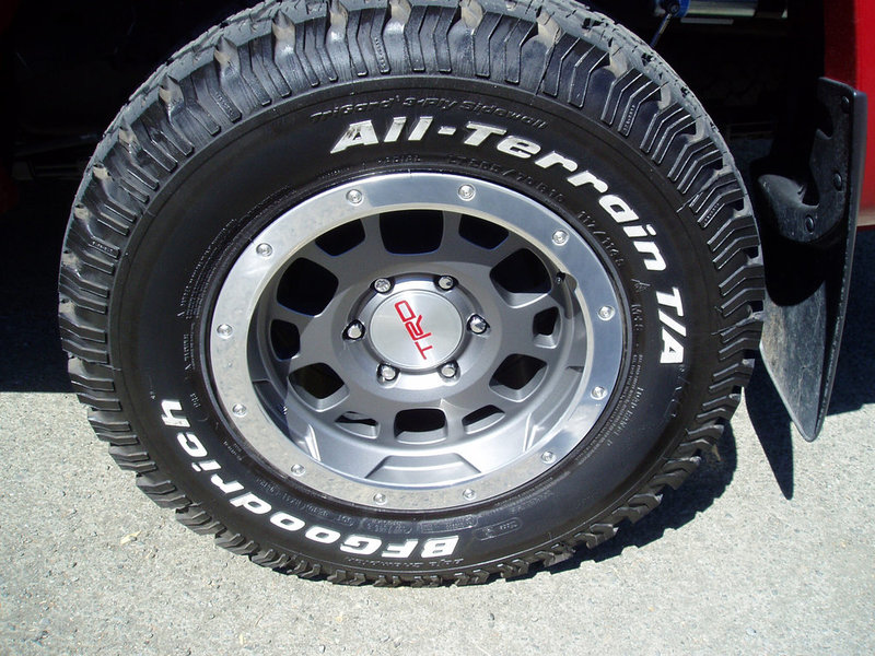

    Help me understand if this is possible: the first order of business is to upgrade the wheels and tires. I really like the 16" TRD wheel w/ the 265/70/16 BFG All-Terrain T/A KOs (as shown in the picture) -- and I had those tires on a Wrangler I once owned and dig them. I realize there is a difference in lug configuration (5lug on my model versus 6lug on the TRD wheel) -- question is: would my model fit those rims and tires? If so, what sort of adjustments would have to be made?

    The best solution is to find some 5lug rims you like. There are a lot of choices for 5lug.
    To run 6lug rims you'd need a 5lug to 6lug adapter. This would not be a good idea. Mainly they are a point of failure and problems, can prematurely damage your wheel bearings, etc.

    Find another wheel that floats your boat. I'm stoked for you, too! Congrats.

    Thanks guys! And yeah I suspected any sort of lug converter would lead to issues -- and that's the last thing I want, after owning a string of German cars with nothing but problems.

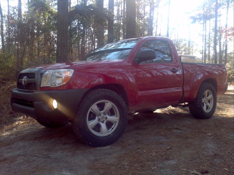

    So here's what I'm thinking leading to my next question -- one of the members (fender104) on here posted his pic -- this is exactly the look I'd like to go for. I would like to buy the 18" XR rims and the tires (285/60/18) that he put on -- but I'm obviously concerned about rubbing. Can I do a smaller lift, like 1 or 2" without going all the way to something like the 2.75 kit from Fat Bob's? I don't really care about major lift or height...just want the look of the tires and wheels without having to do any major retuning or regearing (from what I've read)...just want to avoid tire rub.

    I have a 2014 regular cab 2wd like your future truck. Sounds like you want your cake and eat it too. Xrunner wheels are heavy. But good that you are going with 18" wheels if you plan for future big brake kit. You have to remember that the 2TR-FE motor doesn't have a lot of torque...so unless you want to spend some money... how about you tell us your end game? If you want fenders flares which I like too...but I think my tires are going to be smaller so it would look funny with fenders...you will have to drill holes into your fender to install the flares.
    The 18" wheels with big truck tires are going to be really heavy...so regearing is almost a must unless where you live there aren't a lot of hills...mostly flat lands then you are okay.
    If you really want the big truck route...get a prerunner if you don't want the 4x4 just to get the TRD wheels. Myself since it's more of a street truck, I got 18" wheels that's less weight than the stock 15" steel wheels. Then I'm going with 235/55/18 tires. But you want aggressive tire look...check out Yokohama geolandar a/t-s 225/55R18. The tires are 29lbs...if you get lighter wheels, then it'll equal the weight of the stock 15" 215/70 tires.
    Is your truck auto or manual? Also...if you get too big of tires...you'll have to do black box mod.
    Oh to do 285/60/18...that's a big Fing wheel from stock...regearing is necesary if you live anywhere near hills... A lift probably is required...but black box mod is required for that I size if I remember from other threads.

    Truck is an auto...and yeah mine will be mostly street use -- so you think the 225/55/18 Geolandars would be best?

    I would go for those because it looks like a nice truck tire, but not heavy. If you really want aggressive looks...then read up on black box mod...there's a silly metal box in the fender well that has to be removed to fit a bigger tire. I really like the geolandar because it's just a street tire that looks off road. Most folks will go bigger tire. Good news is your truck is auto so you have 3.58" gears in the back....not the 3.31" gears like my manual truck...so it's dog slow. I had a Z4M before...and BRZ after before I got the truck...so yeah truck is slow for me. with 3.58" bigger wheels may not be such a problem since you are mostly flat lands. Just remember bigger tire means lower gas mileage vs cool factor. I thought the Geolandar would be a compromise, since my 18" wheels are forged racing wheels...it's 20.5lbs and tires can be 29lbs for Geolandar woulbe 49.5lbs. I don't have my notes, but stock tires were 48 lbs if I remember right.
    Best now is one of the TW members who has 3.58 gears with big tires can make suggestion for you. I'm just commenting to tell you got only 180 lb torque and 159 hp and 3300lbs of weight...just take that into consideration when you size the tire/wheel of your desire.
