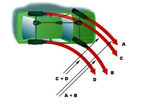

    You can even drive on dry pavement as long as you don't effectuate any turns. Hell, you can throw her in 4Hi or 4Lo (also, remember 4Lo is meant for really really slow driving) and drive in a straight line, throw her back into 2WD to turn around, turn it to 4hi or 4lo again, drive in a straight line, rinse and repeat.

    You'll know if you're binding up the wheels as you'll feel the vehicle shutter and not want to keep going forward, almost like you're in way too high of a gear or you're running out of gas. This will only happen on tight turns, especially on dry ground.
    You'll notice you're doing it wrong before you break something, it's not something that will magically happen out of nowhere. There's no need to drive fast either.
    If you feel like there's something strange going on (aka you're executing a tight turn), just slow to a stop, go in reverse a few feet, engage 2WD and go home.

    You can drive in 4wd on dry roads a few miles a month with zero damage to the 4wd system.. Period. Just don't do it continuously.
    Those who say you will damage the 4wd system doing this do not know what they are talking about.
    I cannot explain it better. The system will not bind if no sharp "parking lot" turns are done. Wet road are fine. Dry roads are fine. Dirt roads are fine.
    If anyone has ever been off road in the rocks, they will realize a dry road in 4HI is super easy on the truck compared to being on a rock in 4LO with your wheels turned all the way. And guess what.... even then, the 4WD system still does not grenade!

    Next time you get in the truck, start driving and when you get to a straight or gentle curve road just switch it into 4wd. It is that simple. Do not leave it there all the time though. Just a few minutes and switch back.
