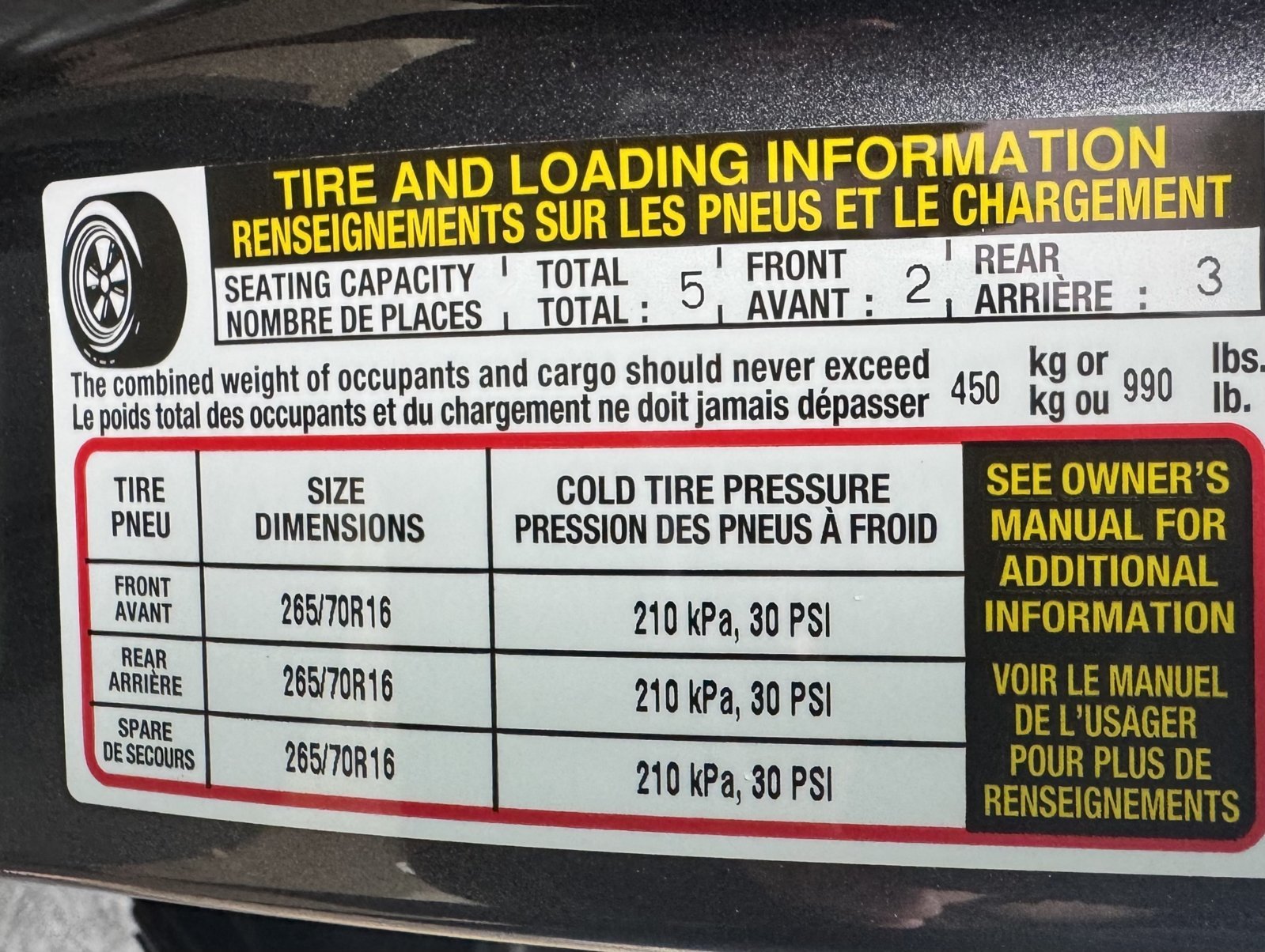

    IMG_0631.jpg For the record a TRD OR door sticker

    They are close, but I’d say it’s enough difference to matter. 265/70R16 on this truck calls for 30 psi. P265/70R16 converted from stock pressure is 27 psi. 10%, that’s enough to consider. He found the results he wanted with even less difference than that so I’d say it does affect the results.

    Toyota goes through so much testing with the tires before SOP, I trust what they say and run with that. Use the door jamb sticker if your setup is OEM. Don’t overthink it.

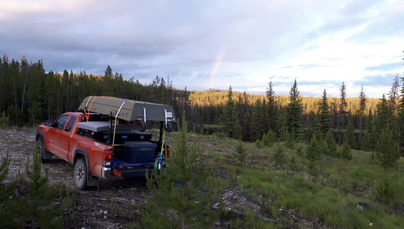

    I have taken my 2016 TRD Off Road on over 100 fishing trips where my combined weight in the cab and bed exceeded 1,000 pounds each trip. That weight not including my 200 lbs.
    I am retired so I do around 40 trips per year, fishing, exploring etc.
    Tires were first KO2 265 70 16, and now at 265 75 16 KO2.
    I have never gone over 34lb even once for any reason. Not on my 3 previous trucks either.
    My daily load when I am not loaded up for a trip is 350 pounds in the back. That from my toolbox and my spare combined. Then my tires at 30lb.
    On those loaded up trips I am also off road on very bad pothole and also ATV style trails.
    Have never had an issue with uneven tire wear or anything like that. Anything over 32lb for daily driving is a no go for me. Normally at 30lb daily as the KO2s at E load are pretty bumpy tires when combined with my Bilstein 5100 shocks.
    No lift kit, but air bags in the rear.
    The stock Wrangler tires the truck came with blew up on my first off road trip. Two with sidewall rips.
    I am currently on my D load 265 75 16 Nokian snow tires. With sand bags in the rear I am at 530 pounds in the bed and the tires at 28lb daily. Better traction at low pressure in snow and off road. Several off road snow trips recently. Second winter with these snow tires, and all 4 are evenly worn.
