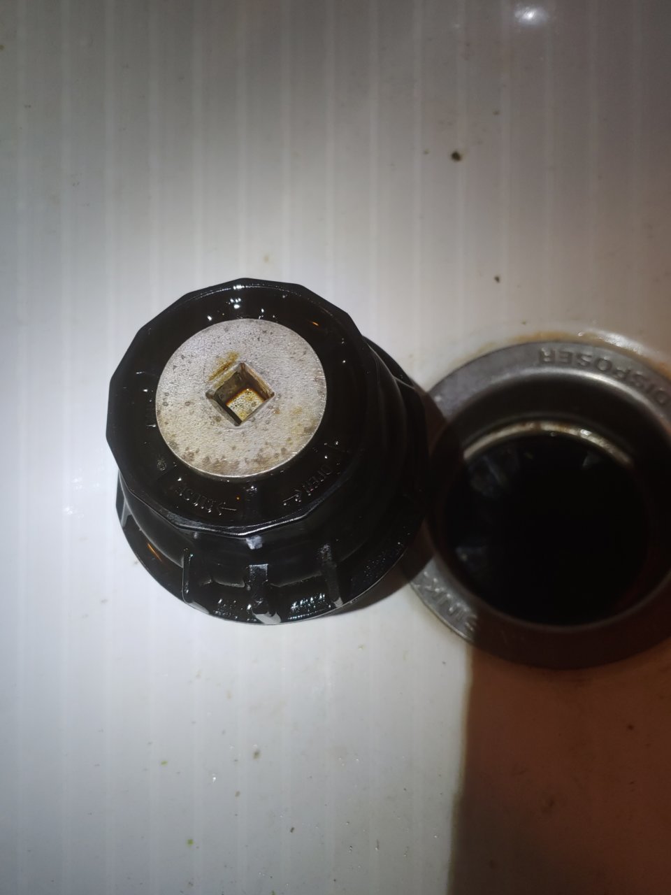

    Is it impossible for anyone else here to get this bolt out?

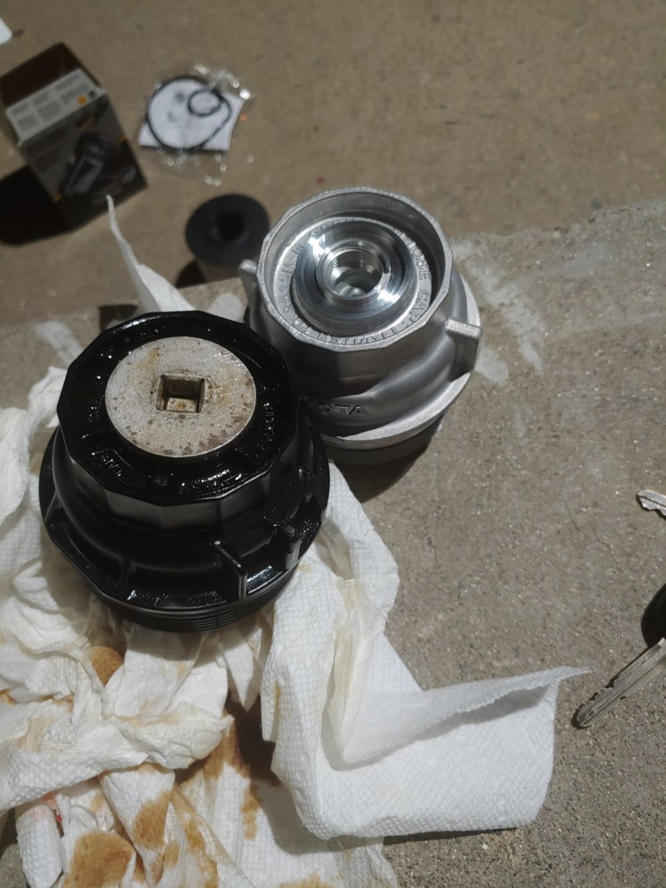

    This shut was 10x easier on my 2nd gen. F U Toyota.

    I'd use an impact gun to blast that 3/8s cap off.
    Or a channel lock to hold it.

    Should be torqued to only 10 ft lbs I believe. I got mine off by wrapping the housing in some shop towels and placing it in a vise. A quick breaking-action with the breaker bar and it came loose. Hardly any torque is necessary when putting it back on, which will save you from having to do it again in the future.

    Ok 10 ft pounds isn't even hand tight is it?
    Glad to be rid of that cheap ass plastic housing....

    I only hand tighten it. The housing itself I do torque down to spec which I believe is 18 ft lbs.
    once torqued properly it should be just fine. My plastic canisters have been plenty durable between other models as well. Dealers don’t care about proper torque spec on them, and that’s when they become troublesome.

    Be sure to saturate the threads with oil. Aluminum on aluminum can do bad things with galling. :devil:
