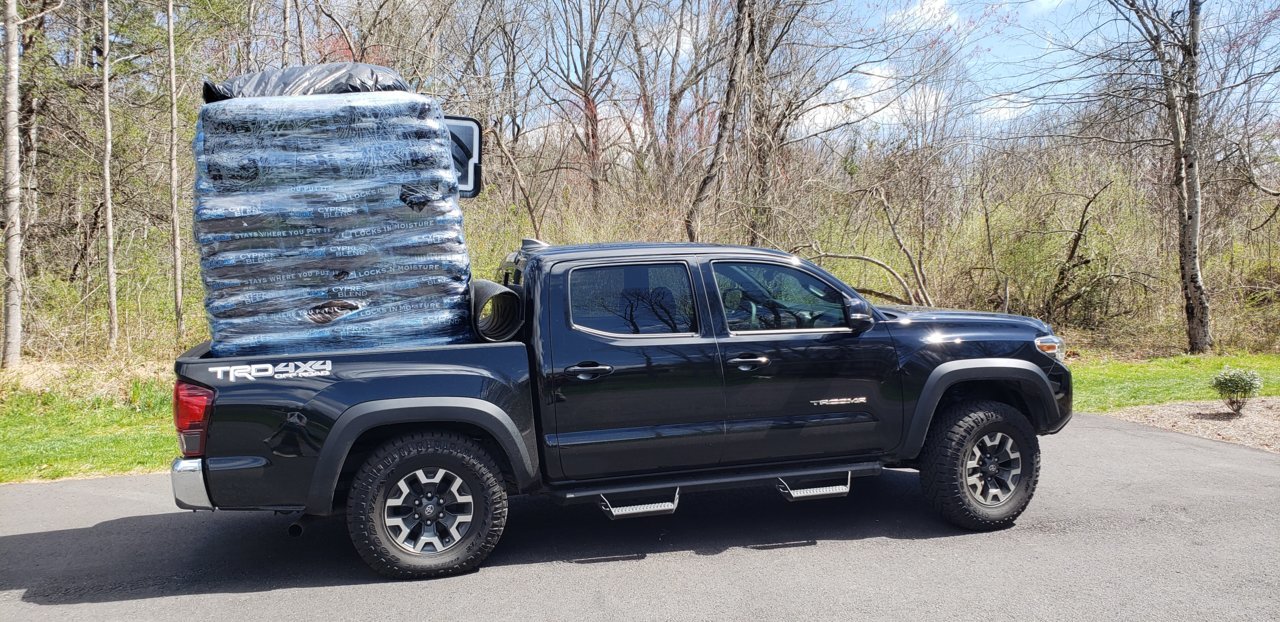

    Terrible idea. Was less then 2 miles though. It ran fine. Definitely won't ever be going near that weight again

    Holy shit! Haha! How much weight was that??

    Was a full pallet of cypress mulch from home depot.... Not sure of the exact weight tho

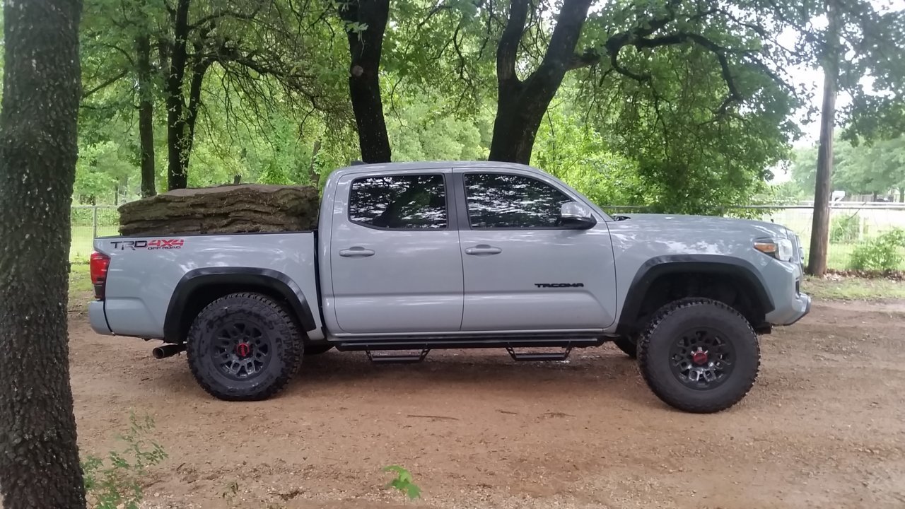

    1 pallet of sod. The guy said it was close to 2000 lbs. Did this twice, for roughly a 40 mile trip both times. No problem...a little white knuckle though!
    SlizzyMcSlizFace and Junkhead like this.

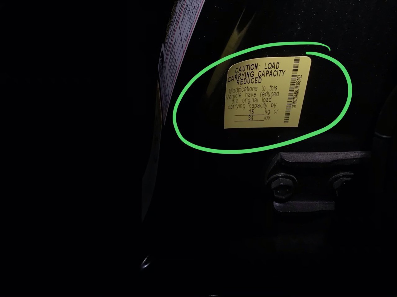

    OP, you received many answers... however none addressed the question completely. Each truck has a “Tire and Loading Information” label on the drivers side door jam. Depending on your specific options, the Never Exceed Combined Passenger & Cargo Weight (some will call that payload) is clearly printed on this label. My truck is a 2018 “Limited” trim model, with factory tonneau cover and tube side steps. Any factory options installed on your specific truck will be deducted from the advertised carrying capacity, and will be reflected in this number. Since my model is fully equipped and has the above options, it’s heavy and thus the printed never exceed weight is only 1000 lbs. So, ALL passengers, aftermarket mods, and other extra items I’ve placed into the cab (like fire extinguisher, tools, etc.), along with whatever I have in the bed, cannot exceed that 1000 lbs. Additional note: if towing, you must also include tongue weight as part of the 1000 lbs (for my specific truck).
    There is also a yellow addendum sticker that may or may not be in the same area as the load info label. In my case, Toyota didn’t include something on my truck which caused the weight to be 34 lbs more than originally calculated, effectively reducing my vehicle’s max “payload” weight to 966 lbs.
    What does that all matter... your vehicle performance and safety capabilities are based in part on published Gross Vehicle Weight Rating. Exceeding the GVWR, 5600 lbs for my year/trim, may result in vehicle mechanical damage and substandard performance, i.e. longer braking distance and potential early brake failure (brake fade) due to overheating at high weights (along with many other potential malfunctions). Failure to observe the published limitations on vehicles could also result in unnecessary consequences from DPS, DOT, and/or insurance companies.
    Bottom line, you should check your specific truck label(s) for “The Combined Weight of Occupants and Cargo Should Never Exceed” weight as printed.
