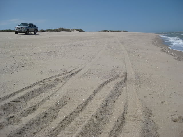

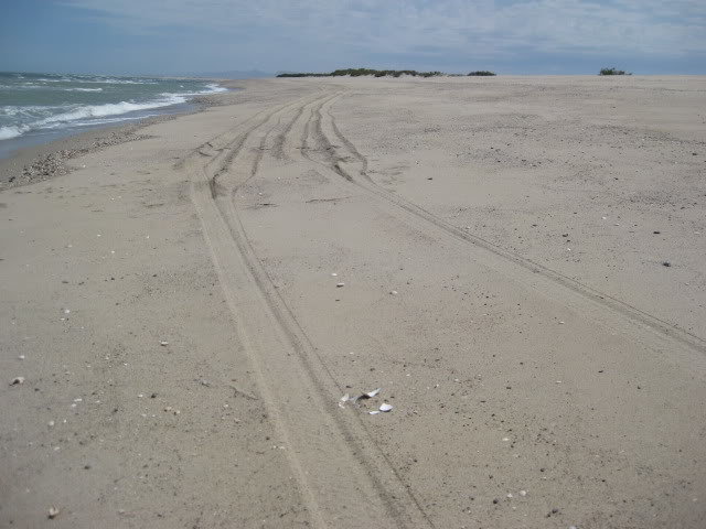

    Depends on what kind of sand... If deep, coarse, and dry (bottomless), then 10 psi... If flat, wet, fine grain... perhaps at street pressure... but keep your speed up if crossing dry sand on the way to wet sand (beach).
    If you get stuck, don't spin your tires thinking you can horsepower out... Once forwrd velocity stops, the downward velocity takes over... That means diging and jacking up.
    If you bog down from the sand, stop and deflate your tires... 10 psi and your truck becomes a dune buggy... well almost... 4WD would be better!
    Have a good precision tire gauge, and an electric air pump to re-inflate the tires after you're out.
    While deflated: do not drive too fast, do not step on brakes with any force, do not turn sharply... all three could cause your tire and rim to seperate at low pressure!

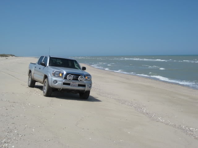

    Photos below are my tracks at 32 psi (digging in) and then at 15 psi (floating)...
    Once youi have floatation, you are free as a bird... of course, I do have 4WD and that makes it a bit easier to drive... being that the heavy weight is in front of a truck, but the drive wheels are in the back... adding drive wheels under the heavy end prevents the truck from knifeing into the sand.

    Thanks for the reply David K. I did mean having more than 2 planks of wood in the truck (maybe 6-10) and a buddy switching them as we roll along. But I am going to get the inflator and do the psi thing. It looks awesome the way it "floats". And I'm glad to hear about the locker since mine has it!
