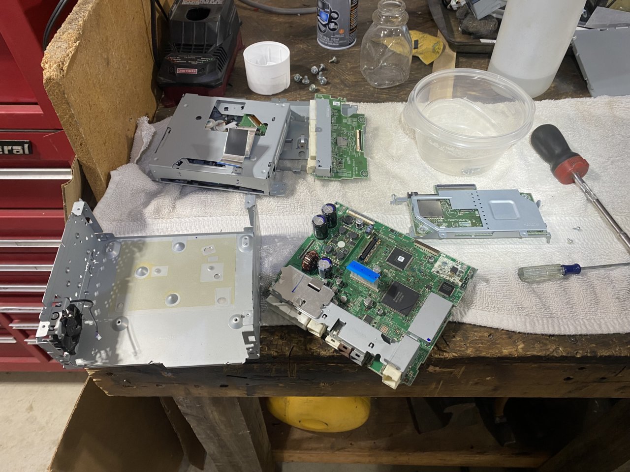

    TL;DR - does anyone know the cause/solution?
    ‘14 non JBL navigation unit.
    Would randomly reset itself. Updated the software a few years ago, seemed to have fixed the problem.
    Recently, it started doing it again. Except it resets and stays off way longer now. Sits overnight, works for a little then turns off.
    I know it’s super common for these radios to have a ton of issues including what I described.
    Has anyone figured out why? Or a have a fix?
    Seems this may be hardware related vs software this time.
    Before dropping 800$ on a replacement, I’d like to attempt to repair this radio.
    I spend most of my day repairing small electronics so fixing it may be a possibility depending on what the issue actually is. I’d rather not go headfirst into this blind though.

    I was told, now don’t quote me, by a fly on Toyota Corporate Bathroom wall, that the circuit board
    cracks in different spots.
  5. Oct 14, 2022 at 7:14 AM

    Thanks!
    Makes sense as to why it works til it warms up.
    I was expecting cold solder joints

    I pulled it all apart. Nothing noticeable.
    Went though and disconnected and reconnected everything I could.
    After all that, while reinstall the radio I noticed the RCA T harness that plugs into the radio side didn’t feel like it seated very well.
    Fucked with it and got it to sit better.
    Plugged everything else back in and it powered right on. It stayed on for almost an hour just sitting in the driveway.
    This morning it stayed on for about 5 minutes before turning off.
    Fingers crossed it’s fixed.
    I’ll find out tomorrow on my hour and a half drive….

    I might concur from my encounter.
    I got a factory refurbished one under warranty when mine started acting up and doing random things.
    I took the refurbished one apart for fun just to see what the fix was and sure enough there was new solder -- and sloppy flux -- in a couple spots that suggested of the 'cold solder' joint cracks I encountered on some early ECUs.
    I would go for it if you got some spare time.

    Stayed on for 5+ hours today. So far so good.
    Wondering if something was just loose.
    cleaned and tested.
