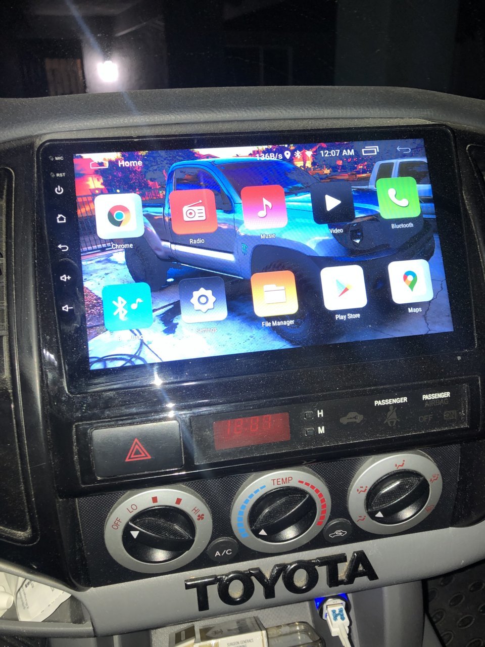

    B49817CC-FD88-475D-A7E6-FCC31800D682.jpg Hello Tacoma world I was wondering if I could install the 2016 Toyota Tacoma premium radio in my 2012 Toyota Tacoma base I have gone through the wiring and everything seems to be plug and play with A few adapters The only thing that worries me would be the space the 2016 radio is bigger and I don’t know if it will fit.

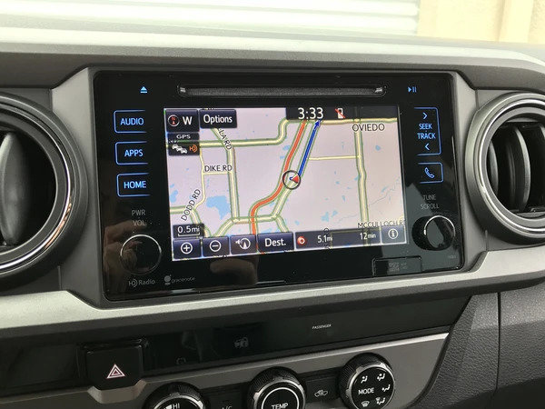

    5B021E19-8C81-4B53-8BC6-844E2688D982.jpg On eBay for $250.00 it’s the 2016 Toyota Tacoma radio.

    Yes you can but you'll need a radio surround and brackets from a 13-15 radio. You'll also need to buy a gps antenna (they're cheap on Amazon) to get the navi to work. You just gotta trim the radio surround to get the new radio to fit. Everything was plug in play for me but mines a 13OR model so I don't know if that makes a difference.

    That is awesome to hear thank you very much I found the plastic bracket and the gps on Amazon looks like I’m doing this.

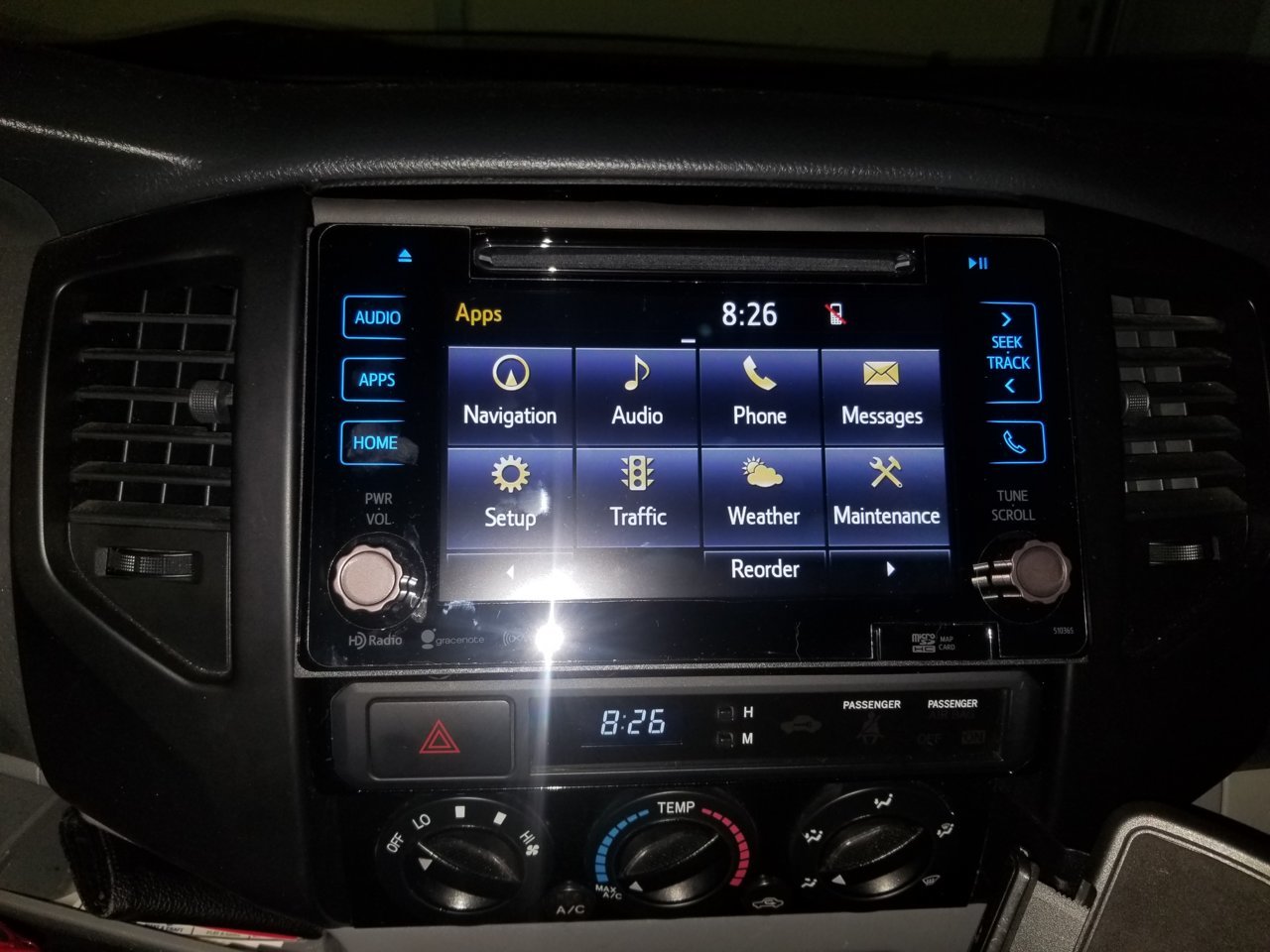

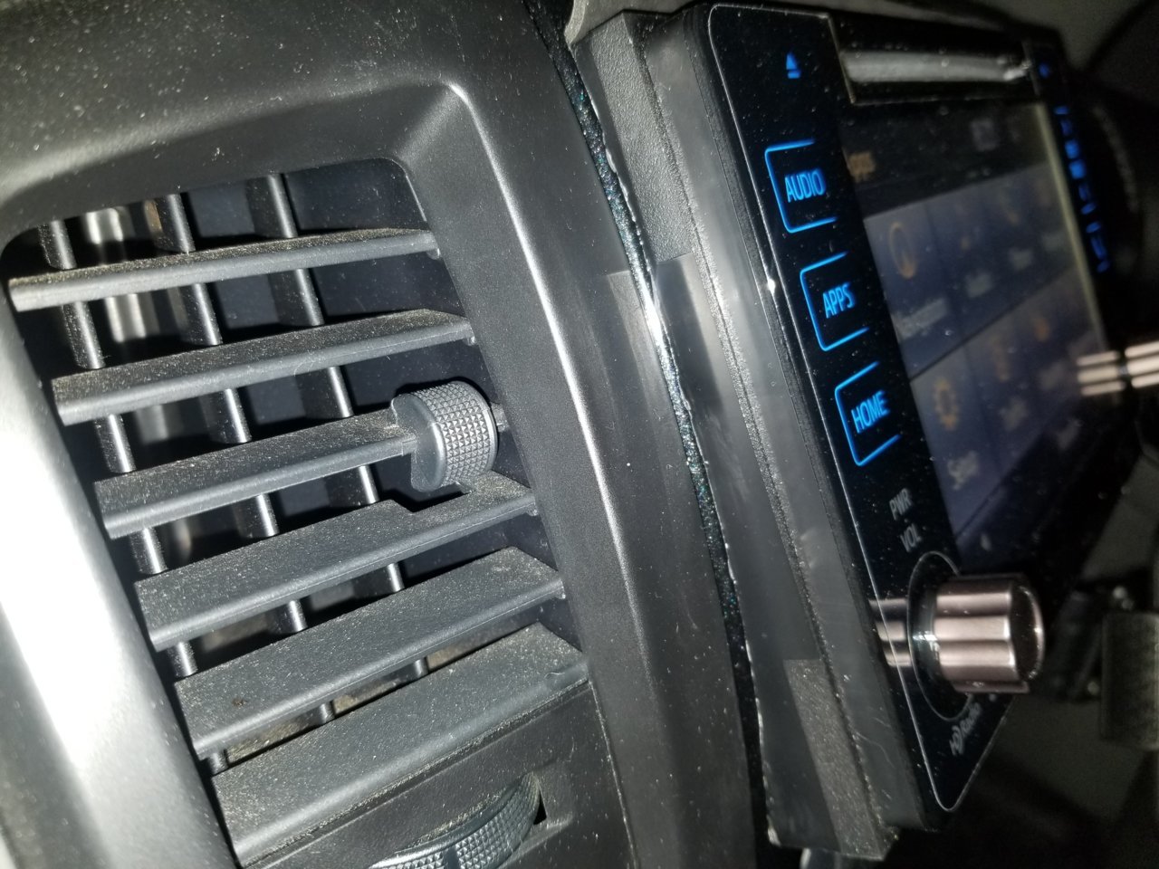

  13. Feb 15, 2021 at 11:48 PM
    Tyurgen
    Tyurgen [OP] Member
    Feb 4, 2021
    #355009
    7
    Allan
    2012 Toyota Tacoma Base
    Headlights, rims, fog lights, LEDS, Tail lights, and coming soon radio.

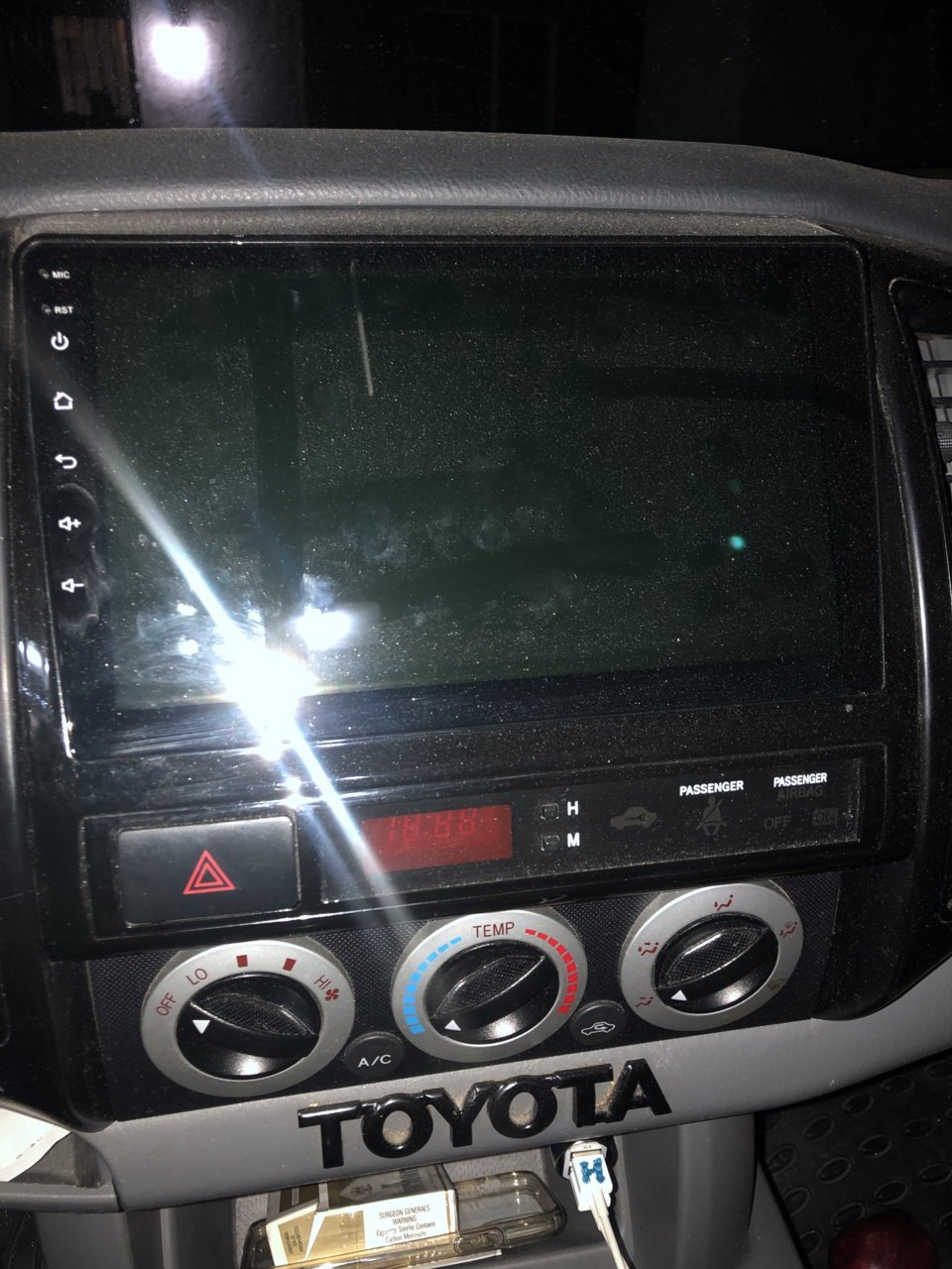

    Well it’s not perfect but it will get the job done my speakers are louder now to.image.jpg image.jpg

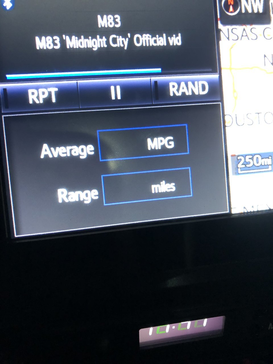

    5280D61F-D811-48BE-8729-C18094D27826.jpg Ryan2103a do you know if you could get the range an average MPG to work on your radio.

    No I couldn't get that to work either.

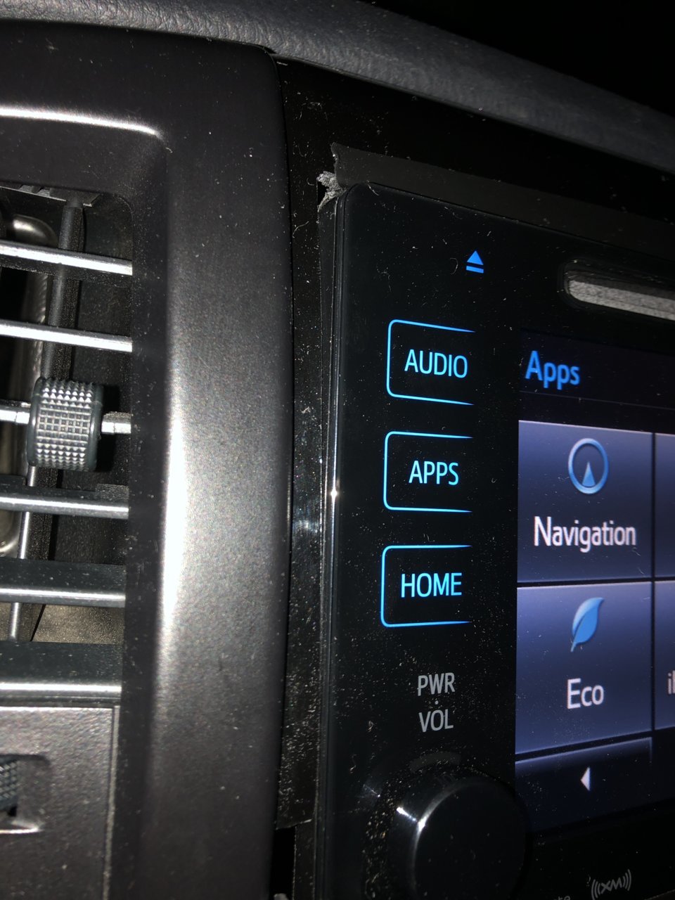

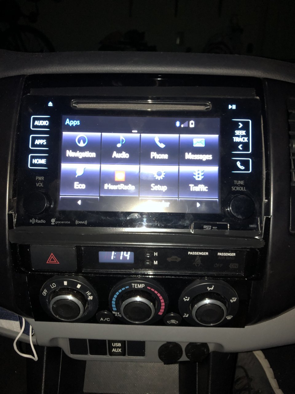

  18. Feb 25, 2021 at 12:10 AM
    #18
    Tyurgen
    Tyurgen [OP] Member
    Feb 4, 2021
    #355009
    7
    Allan

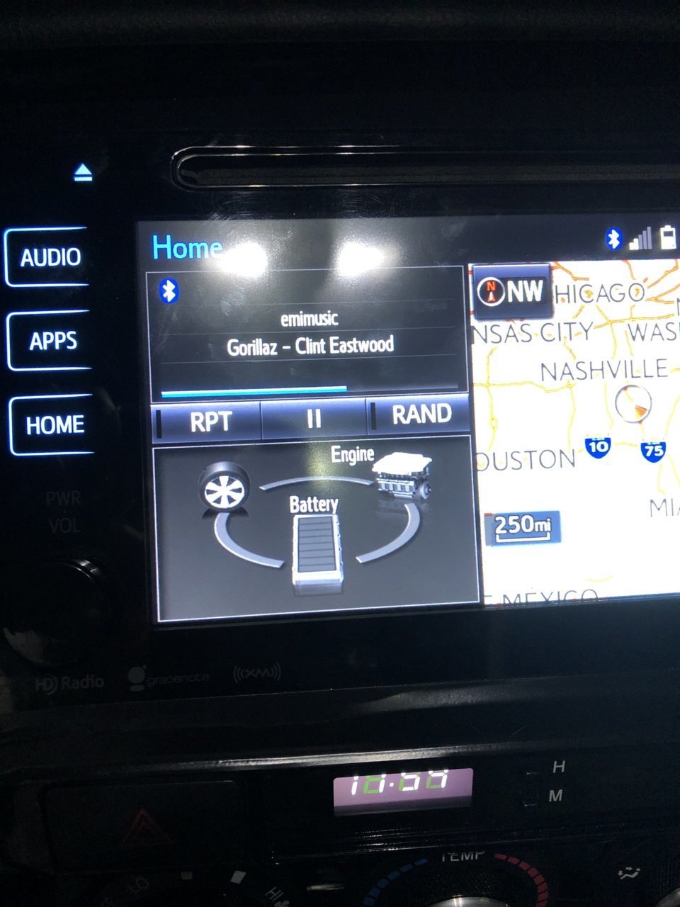

    image.jpg image.jpg ace96 I have two Tacoma’s and I went aftermarket on my 2005 Toyota Tacoma but I didn’t like The quality of the software on the original Toyota radios the software is amazing nice and responsive and on aftermarket radios you just don’t get the same results in the future I will get a custom housing for my 2012 Toyota Tacoma I used to have a 2016 Toyota Tacoma six speed manual 4 x 4 with the radio installed on my 2012 Tacoma and I really liked it I enjoyed it so that’s why I don’t want to go after market on my 2012 Tacoma and you get more volume out of original radio.
