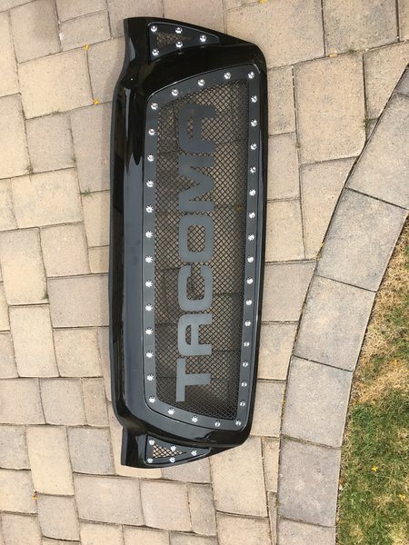

    Well I just finished my own raptor style grille and got some requests to do a write up.

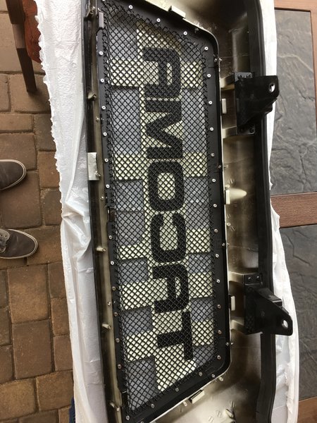

    Rivet mesh insert is sold here https://www.ebay.com/itm/291187474126 This requires destruction of the factory grille and very precise cutting
    There is an alternative option to this which is buying the shell with the insert I got mine from URAUTOPARTS on eBay. If you want chrome try 24HOURAUTOPARTS. I would recommend messaging both asking when they would get them back in stock. Usually he will order another batch. It should be posted in a few weeks.
    Next you want to order the letters from https://www.customcargrills.com/Grill-Lettering.asp

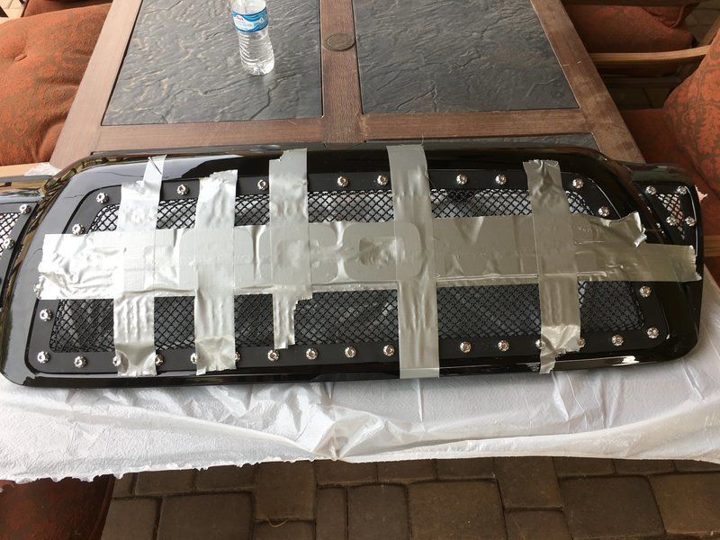

    I recommend lining the letters out on a level to ensure that they are straight. Then take a couple of pieces of duct tape and cover the letters. Finally attach the duct tape to the grille where you want it.
    I attached the letters using J-B weld that can be purchased here: J-B Weld 8270 KwikWeld Industrial Professional Size - 10 oz. https://www.amazon.com/dp/B005UYVIXO/ref=cm_sw_r_cp_apip_WCS5GKEnFqdtv
    I recommend doing one letter at a time because the grille mesh is a bit "arched" which makes it hard to do it all at once
    Finally let dry for 30 min and peel off the duct tape!
    All and all this costs about $200-$250 if you go the premade grille route
    $120-$170 if you do the insert

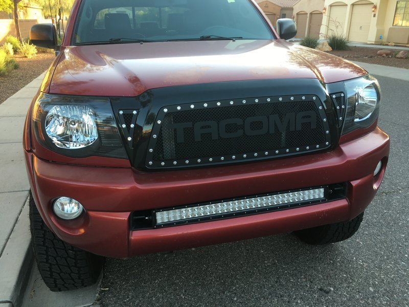

    It looks really good! I think the chrome fasteners make it a bit flashy for me personally but painting them black would make it perfect IMO.
    Really good work though. Any pictures installed? Cost? I want the trd pro grill but at 400$ this might be a good alternative.

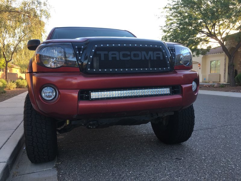

    The cost is at the bottom of the post and I will add pictures installed when I get back to my truck on Wednesday! :)
