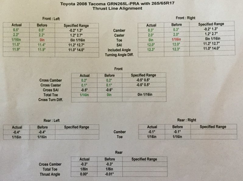

    I don't know jack about the alignment numbers but they told me mine were way off. Looking at the numbers below I don't see anything crazy. I'm guessing these are the "after", not before numbers.

    Doesn't look too bad to me... Ideally 0 toe/camber and your caster looks perfect depending on lift/tire size...
