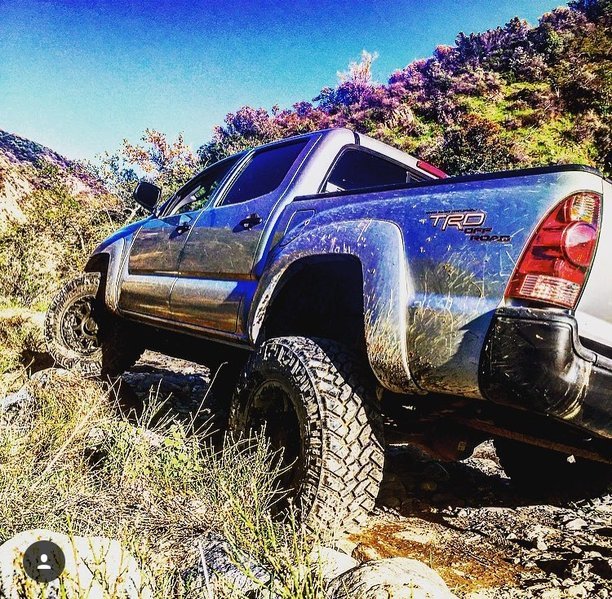

    Hey TacomaWorld! So I have a 2005 TRDOR About a year ago I installed a 3" Pro Comp lift with a add-a-leaf in the rear. Last week I had the leaf spring recall done and they obviously didn't re-install my add-a-leaf. After looking at the new 3+1 they installed my add-a-leaf looks to be too long. Has anyone run into this issue? And what are some options without spending a ton of money? Picture of my Tacoma before the recall for your time.
