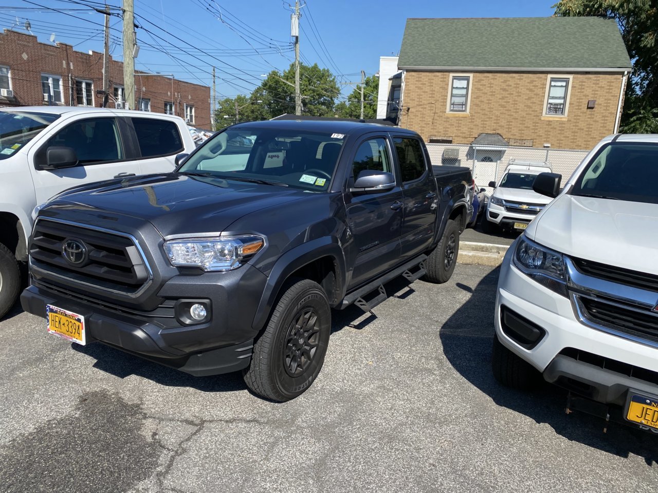

    Dropped mine off at dealer yesterday for inspection they gave me 2022 tacoma sr5 im not impressed with the 2022 rough idle and feels smaller and narrower than my 2015 but great a/c and i like the apple car play. Cant wait to get my truck back
    dealer called me today told me they cannot spray my frame because it is modified they called toyota and said i have to remove my rock sliders, transfer case skid plate and transmission skid plate. I asked what about the engine skid plate, fuel tank skid plate and differential skid plate they no those are fine. The other ones and rock sliders block holes they need access to. They can remove them but no guarantee that nothing will break and they have to charge me $500.
    I said i will pickup my truck and when i get around to it i will remove them and reschedule to bring my truck in smh
