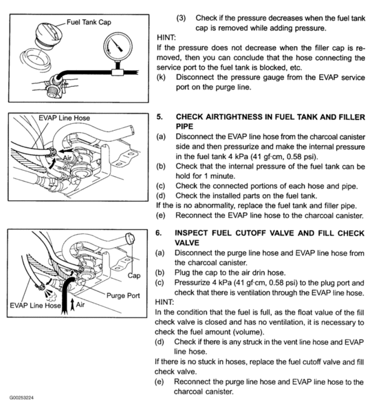

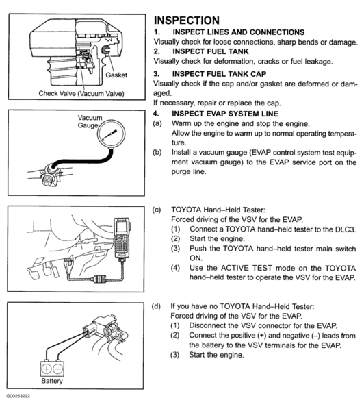

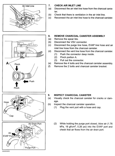

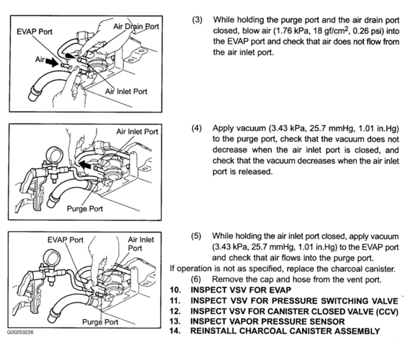

    Here's a flow chart on how to test the entire evap system.
    This one shows the check valve specifically.

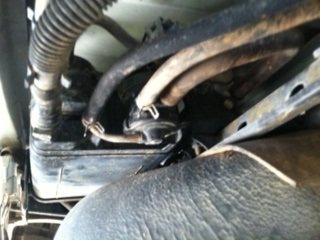

    the last owner did some VSV checks i beleive and i replaced a cutoff valve yesterday ( but its not at the neck base so if theres another there then i havent touched it).im not sure if this will cover all those bases but i just fueled up and in the processs i one by one disconnected each vacuum line going into what i assume is the evap cluster.... nothing has helped.... i did completely write off the idea that there could be something in the filler neck down low out of site since i am able to fuel and 2 times since january it just filled like any normal vehicle.. i wonder if theres something in there or could there actually be a problem with the neck somehow...such a dumb ass/irritating little problem!
    here that evap cluster if it sheds any light for anyone!
