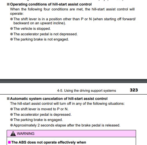

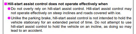

    All this talk about RTFM, Here it is, directly cut and pasted. If your truck is rolling back I would check to make sure I'm not doing any of the items that would cancel it.
