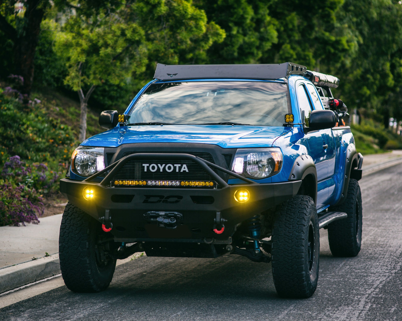

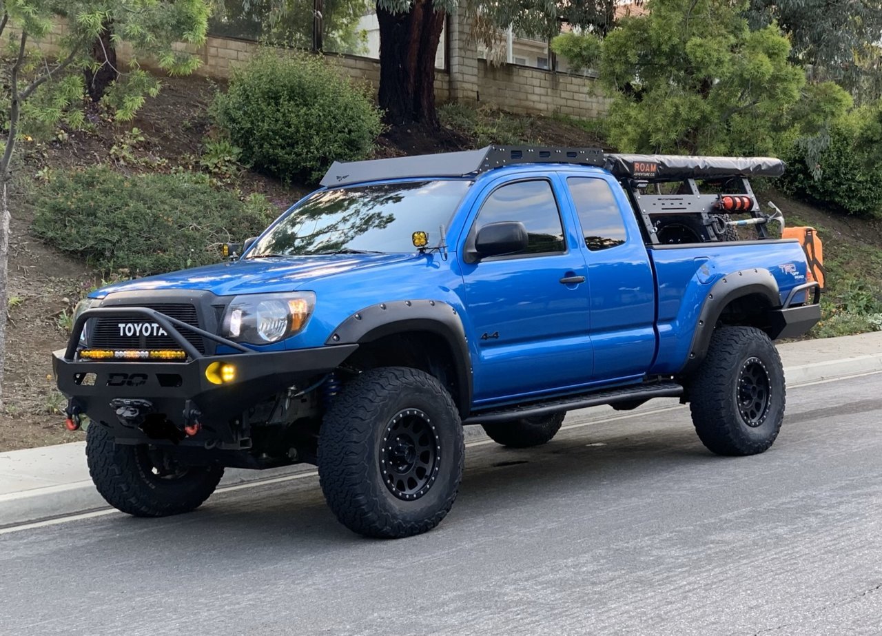

    installed the access cab rack today. Didn’t have to drop the headliner since my truck doesn’t have airbags up there. Pretty easy install overall

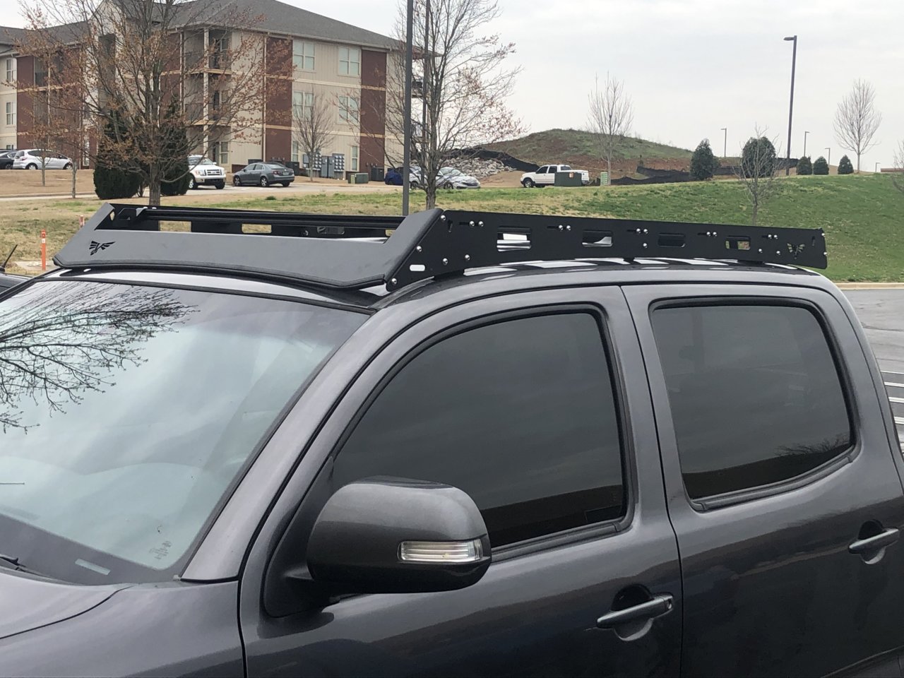

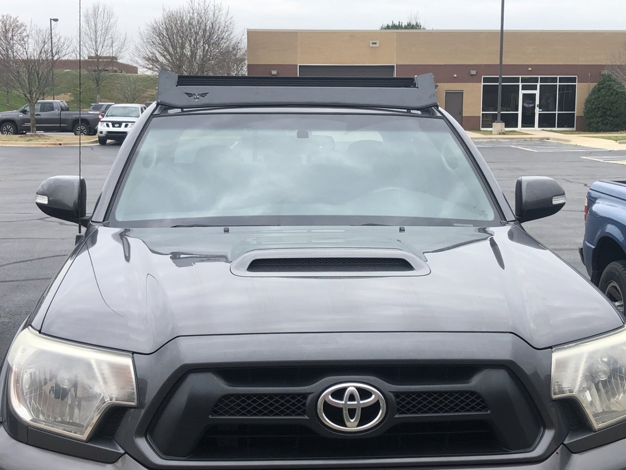

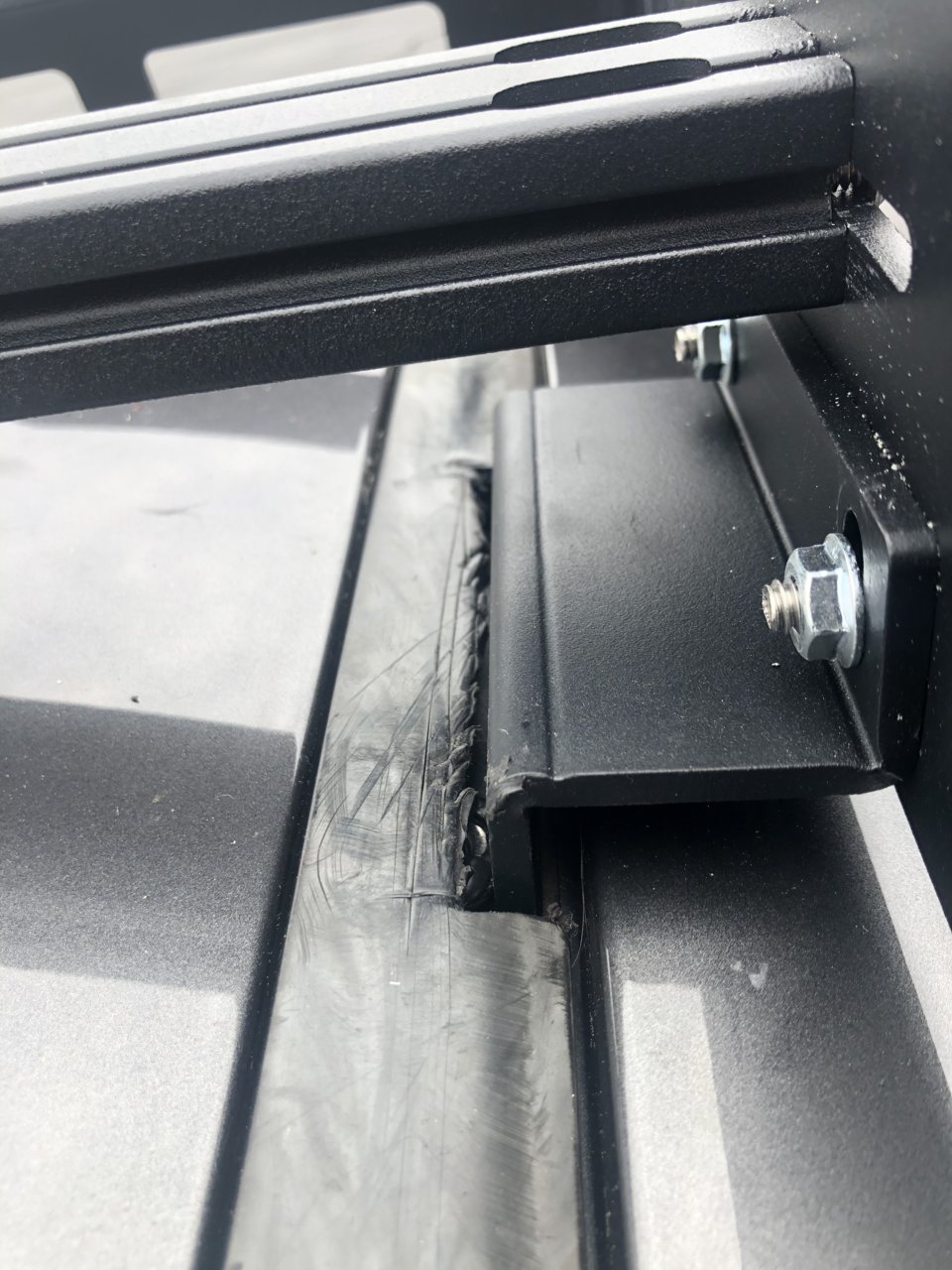

    Alright yall just got the Victory 4x4 Rack installed and its super nice. I have seen where people cut the weather stripping in three different pieces to fit around the brackets but i decided to notch it out to keep it all one piece. It holds in place fine going down the interstate but the middle section is a little flimsy so 3m tape or silicone is definitely needed.

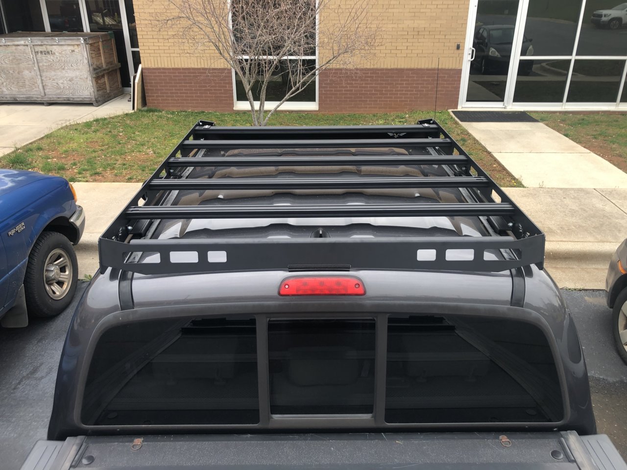

    TIP : You get a long piece of stripping to go on the underside of the front fairing, and you will have a little extra piece left over. Use it on the underside of the rear fairing thing. Look closely and you can see the piece right above the third brake light.
    Thanks @monkeyevil, awesome product at the best price available!

    Looks awesome!
