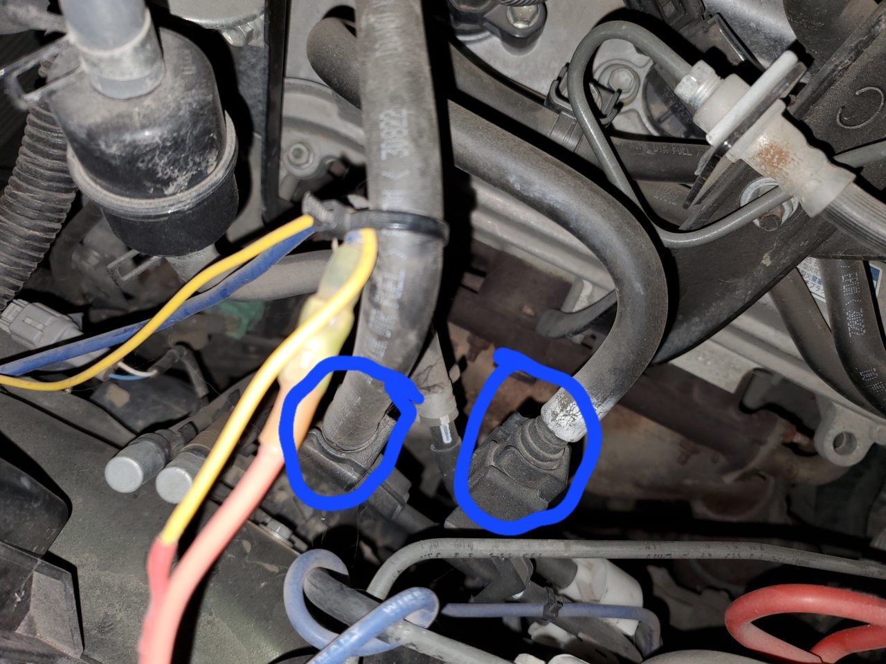

    The easiest place to tee in is on the drivers side where the fuel lines from the engine connect to the steel lines on the frame.
    I believe the forward most line is the pressure line but I'm not 100% on that.

    Toyota says to T in at the #1 fuel pipe. That’s the line that connects to the fuel rail on the drivers side. You might follow that line back to the one @Dm93 posted and try there.
    Pressure should be close to 41 psi.
