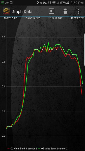

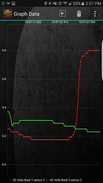

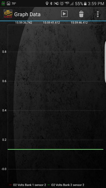

    The first picture is at idle and the others are while driving. Screenshot_20161108-155951.jpg

    Yea, that definitely doesn't look right. Are you sure you uninstalled all pieces of the unichip? Which one do you have?

    The high value in LTFT1 in IDLE and OPEN LOOP is stored in memory. It can be reset disconnecting the batery to let the ECU learn again running. In close loop it is taken from O2 Reading. If the high value is present only in idle and going well in road, as you can notice in the graphs; the cause could be a leaking vacumm. Notice the great amount of air flow at 40 miles. This compensates the leaking. I hope this help you.
