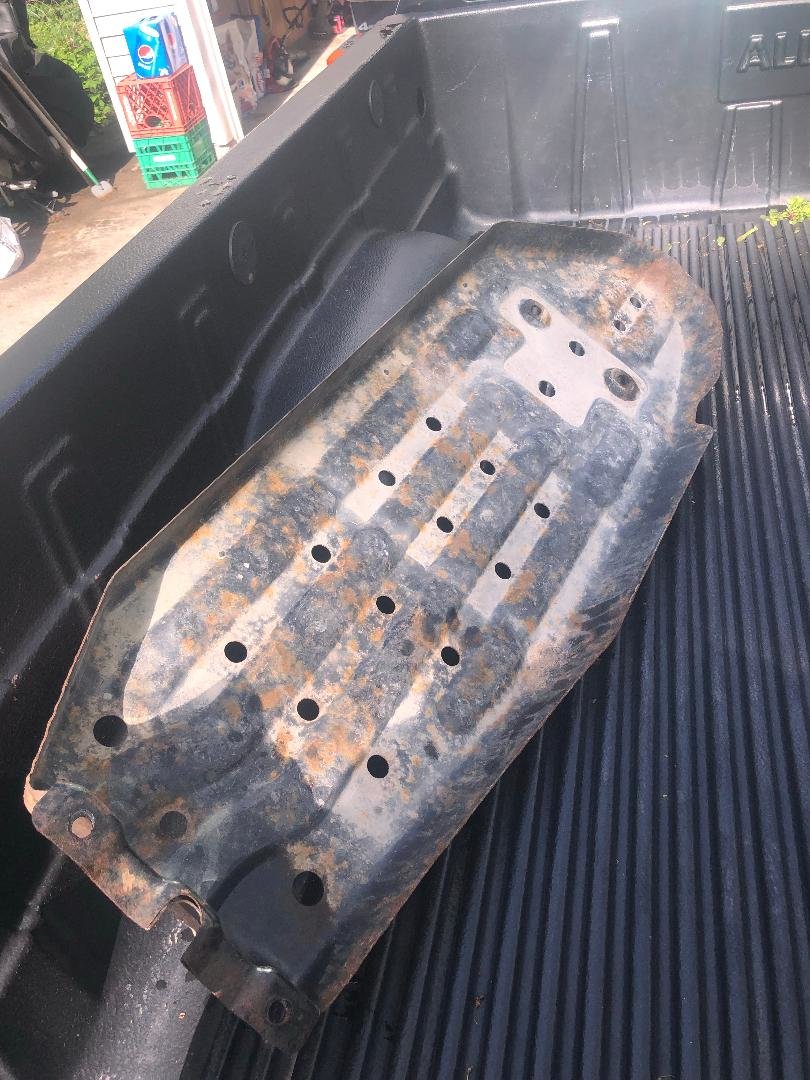

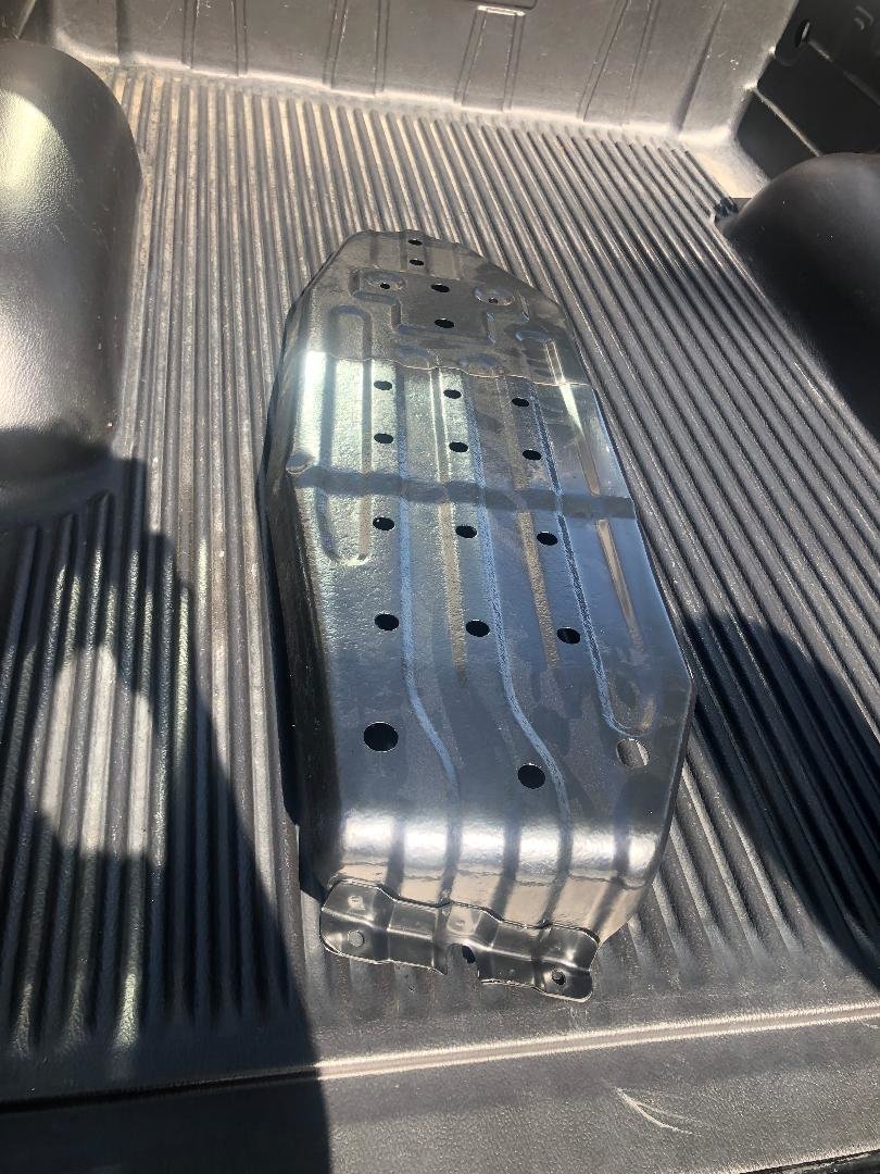

    ... something else for your trucks todo list (in case it wasn't already)
    lower shield/skid on the fuel tank, for some reason its made of a different material than the front and gets icky after the years
    I had mine sand blasted and powder coated this spring so it hasn't seen its first winter yet with the new coating on it.
    i always sprayed it down on the top frequently through the wheel well to get all the winter muck that accumulated between it and the fuel tank but it still got crusty
    after and before pics...
    it was a little awkward taking off and especially putting it back on since its odd long and quite a reach between front and rear bolts
    the joys of the winter Tacoma :cool:
    Jp Sturm [OP] likes this.

    Sweet, thanks for the suggestion. That looks incredibly better too. Where did you have in sandblasted? Company or friend? lol

    a local place
    http://trailperformance.com/
    $45 did not seem bad + some new bolts (uncoated) i just smothered some anti-seize goop all over them in case it needs to come off again
    the original bolts did come out fairly easy after spraying with PB blaster every little bit

    Okay cool, PB blaster will probably help a lot. The local high school has a shop, Ill see if they would be interested in sandblasting it.

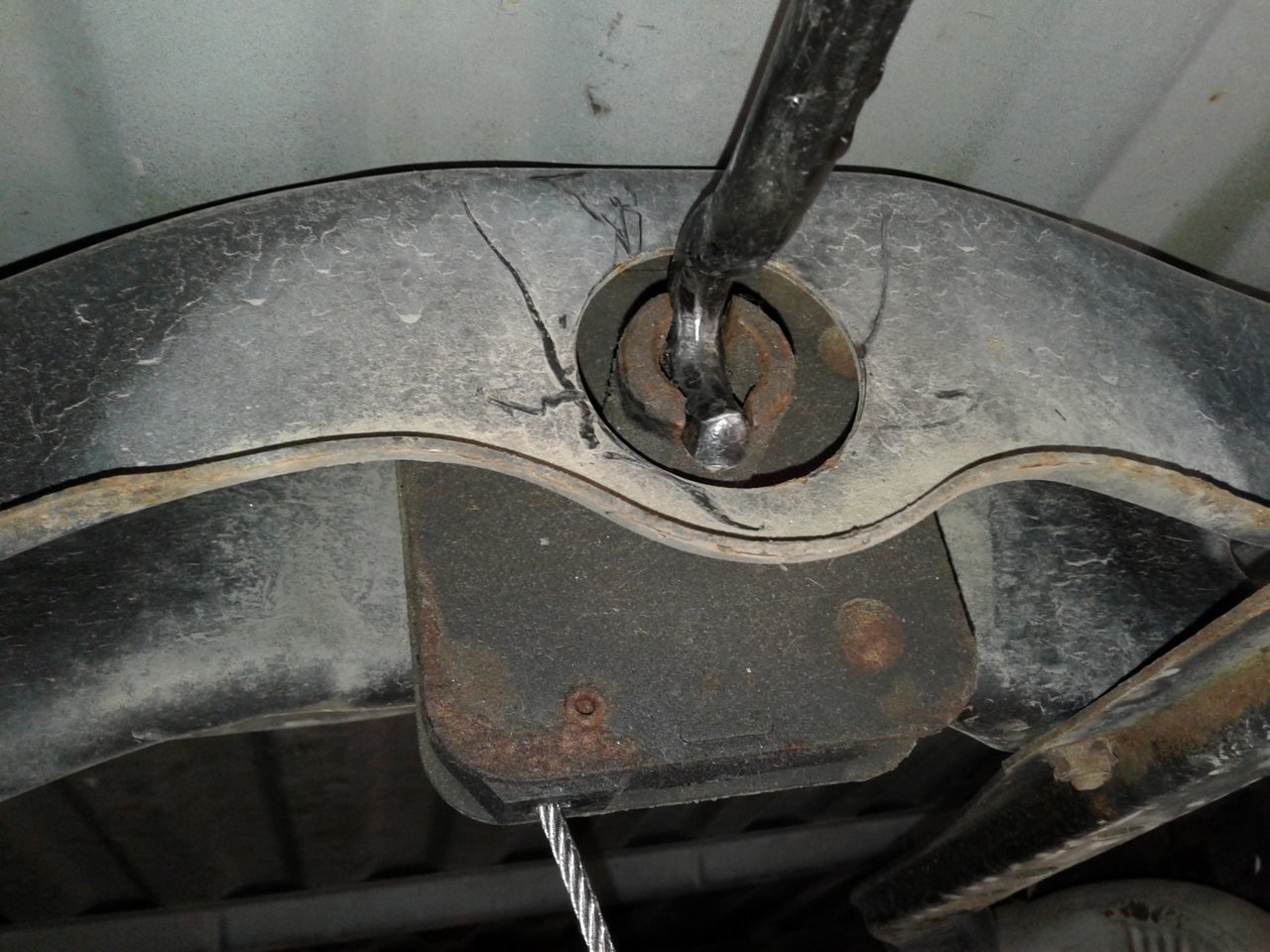

    Jp, got a question for you (if you still have the spare tire out) I have never had to remove mine since I have only had one flat puncture in 22yrs 125k miles, noticed it in my driveway so just took the tire off and took to the tire shop. but i am planning on figuring out how to remove it to see what I got to clean up
    is it possible to take off the spare tire carrier unit without having to remove the bed?
  9. Aug 19, 2019 at 2:49 PM
    #49
    Jp Sturm
    Jp Sturm [OP] Well-Known Member
    Nov 2, 2017
    #234816
    125
    Jp
    Horseshoe Bend Idaho
    95 Sx 5 speed
    Yes, I looked and there are 4bolts. 2 on each side. The bolts can only be removed from the top though. The bottom has 4 nuts welded in place. In the pictures you can only see the nuts.
    Im not sure if the cable part can be removed.
    jammer and GQ7227 like this.

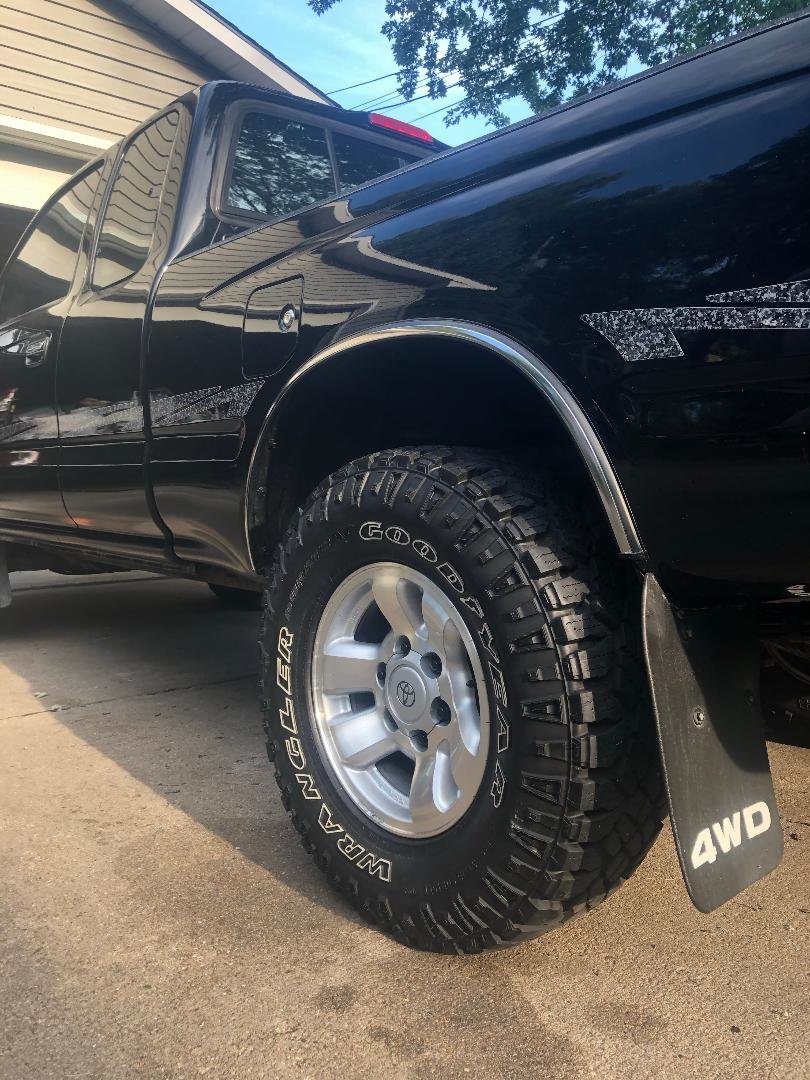

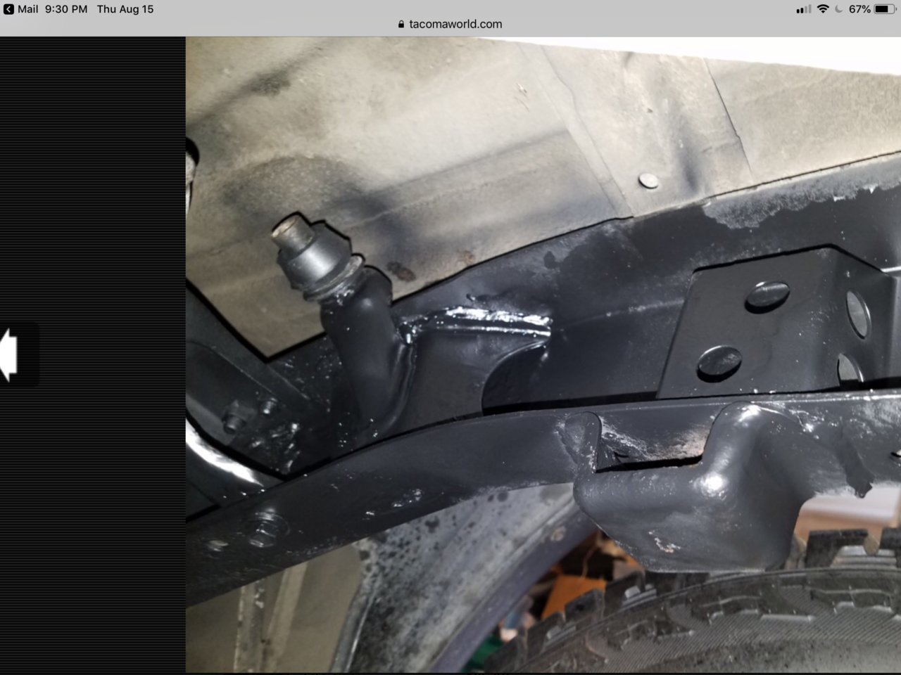

    found a picture with a small glimpse of what the new wheel molding screws will do for you!
    they were brownish and weathered like yours
    my intentions are to spray the new ones with the WD40 specialist anti corrosive spray every now and then after I scrub out the wells, maybe keep them blacker, longer
    sprayed the threads before screwing them back in one at a time
    also shows what the powder coated wheel nuts look like, not sure how long those are gonna last but looks sharp for now
    Jp Sturm [OP] and jammer like this.

    Good question....and Jp is correct. I've still got my spare down from doing the rear brake line a couple of weeks ago. I'm thinking about removing the four bolts to see if if will or can be removed without having to remove the bed.
    When Toyota did the recall or "safety check" on the spare tire carriers a couple of years ago, they stated that the bed had to be removed.
    I'm in the process of prepping the tire carrier for POR15 treatment!
    https://www.tacomaworld.com/threads...e-recall-done-at-the-dealership-today.277878/
