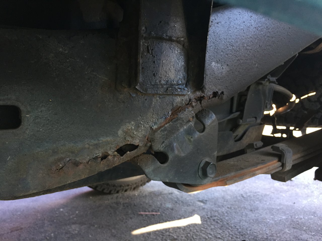

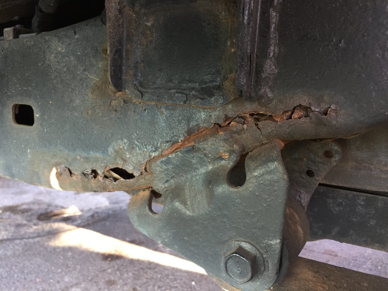

    Hi Everyone,
    I have a 97 Tacoma that I bought 8 months ago near Seattle. When I bought it, I didn't know about the rusty frame issues with 1st Gen Tacomas and the previous owner had painted almost everything under the truck black so I was unable to see the rust. Now I'm down in LA (drove it here) and my frame is cracking where the leaf springs attach. My mechanic referred me to a place called Solo Motorsports, they build/fabricate frames for race cars/trucks that do jumps etc... and they said they would be able to cut out that part of the frame and create a strong bracket or something to put where the damaged portion of the frame is for around 500$. I trust them and I think it will work. It has to be done because otherwise the frame will break there and it's dangerous to drive. What do you guys think? This truck is in immaculate condition otherwise and only has 162,000 miles on it (150 when I bought it). I am worried I may have to get rid of it. I also worry that if I sell it down the line and someone sees the repaired frame it will significantly lower the value. I've attached a few pictures of the rust.

    I think that would be the best option. Unfortunately I think no matter what you do, it will lower the value. If you leave it, then a potential buyer could argue that it has frame rot and refuse to pay asking price. If you fix it, then someone could argue about hidden frame issues. Maybe try stripping the old paint off before taking it in to get fixed, at least then the company can inspect the rest of the frame for amy more problems.

    Thank you! I've only had it for 8 months but I love it. I am really torn up about this issue. I took it in to get new shocks yesterday and the mechanic wouldn't touch it until I get the frame looked at/fixed because it's unsafe to drive. Stripping the paint is a good idea...

    looking at your pics I can see the lower shield/skid for the fuel tank looks in ok very good condition from that angle.
    usually these get very crusty and worse!
    since you have not had your truck for very long you probably would not know if that is the original or not?
    if it is the original then I have no clue what got inside your frame a long time ago to do that to it :confused:

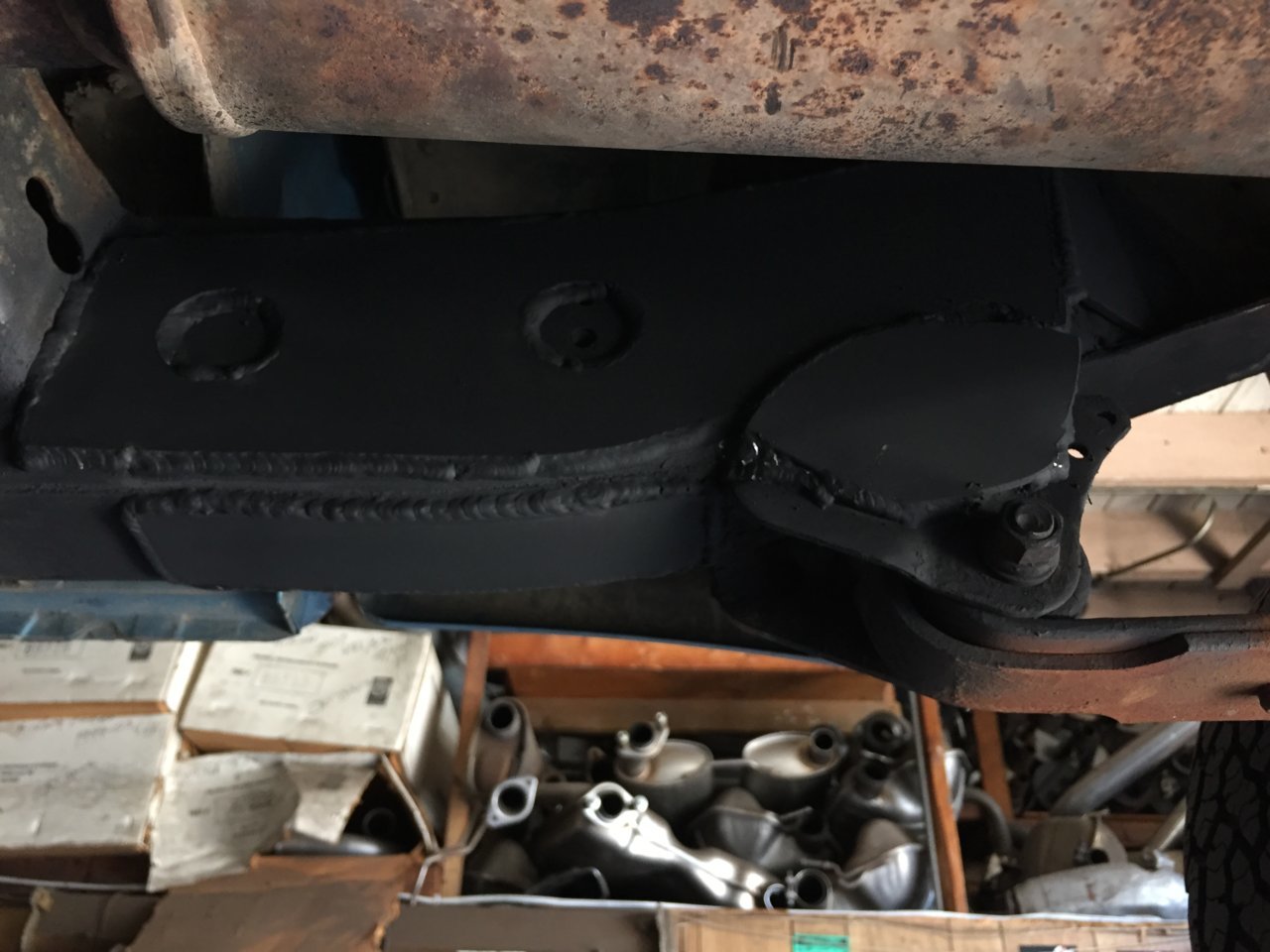

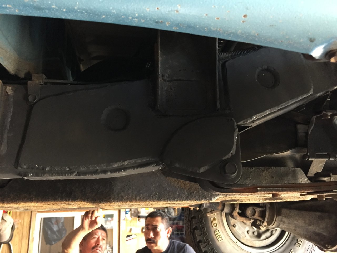

    I got it done. It wound up being slightly more than they expected as they had to take off the gas tank and the rust was worse than I thought. Here are a few pictures, they did a great job. I think I am going to keep the truck, it seems solid and most of the rust has been cut away and the rest of the frame looks ok.

    Awesome! It looks very sound and professional. Glad you decided to keep it!
