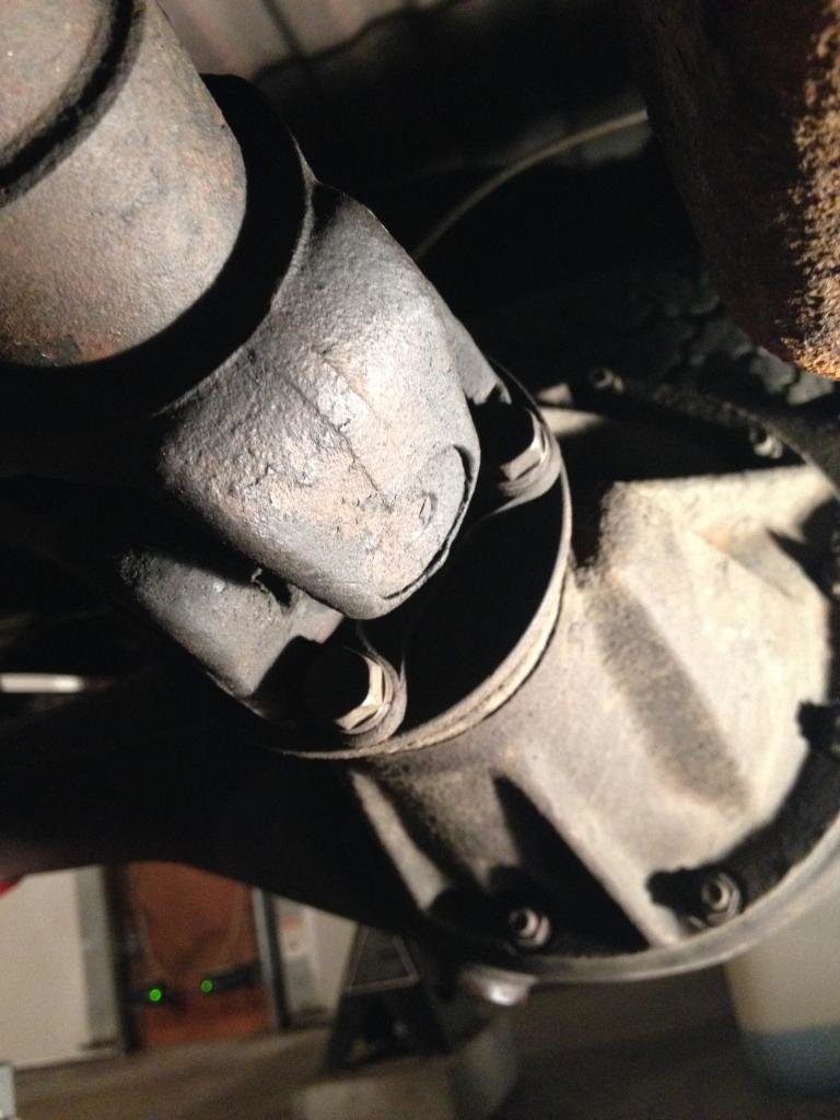

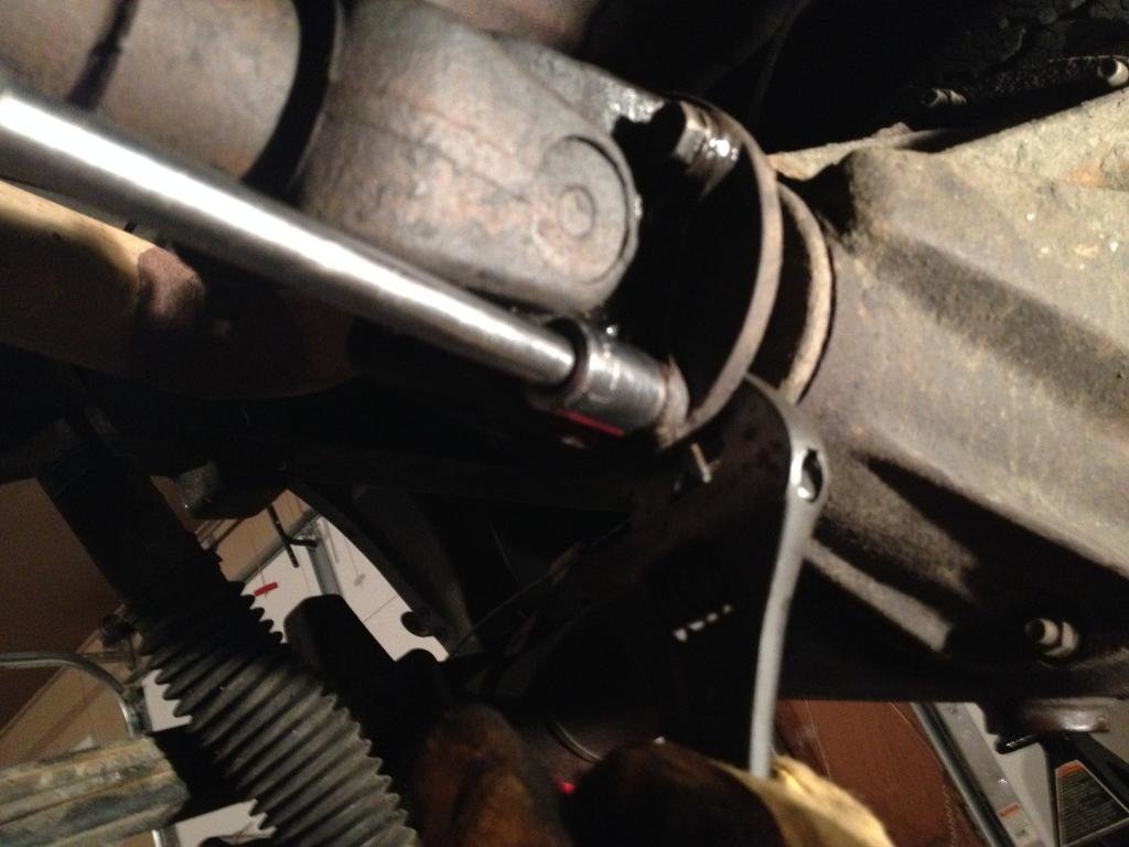

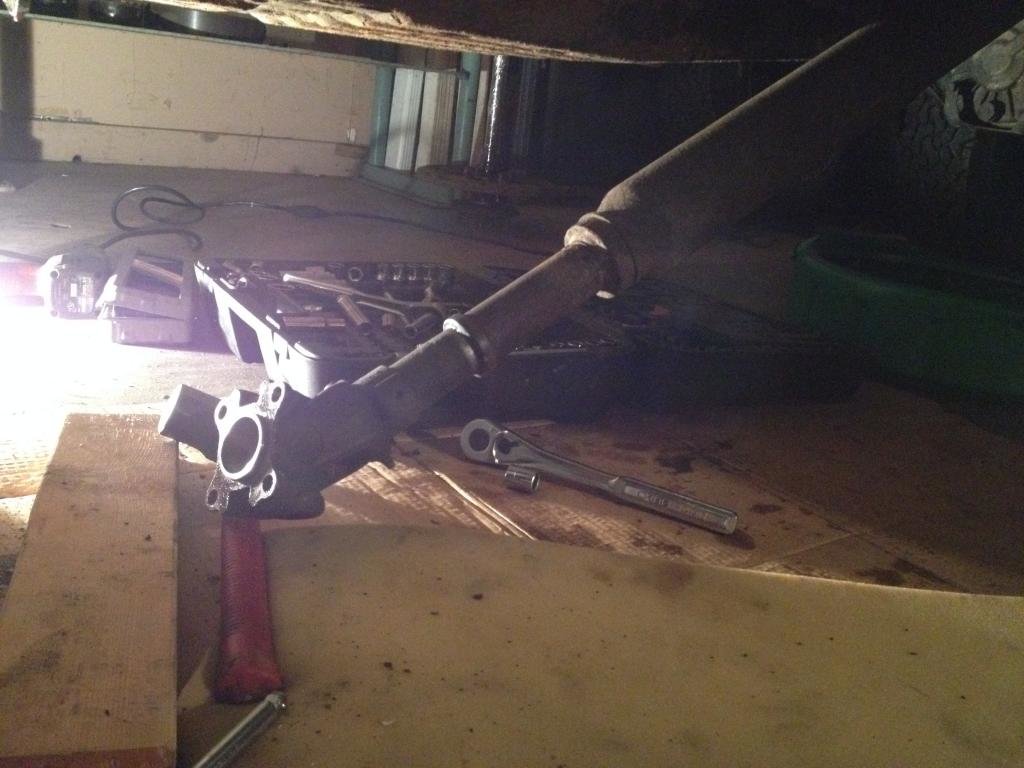

    Now I could work on removing the third memeber with both axle shafts out.

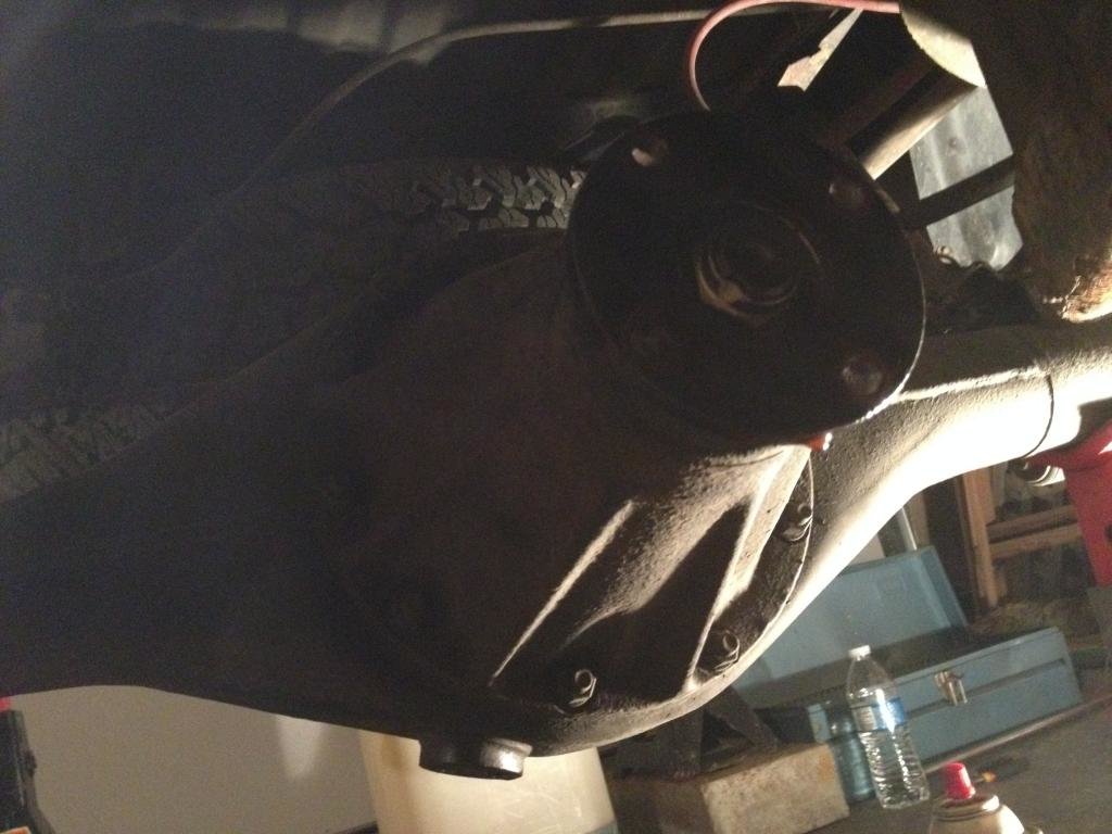

    Started by removing the drive shaft from the flange.
    Once the bolts are off, I used a rod to push the drive shaft back and it seperated from the flange.

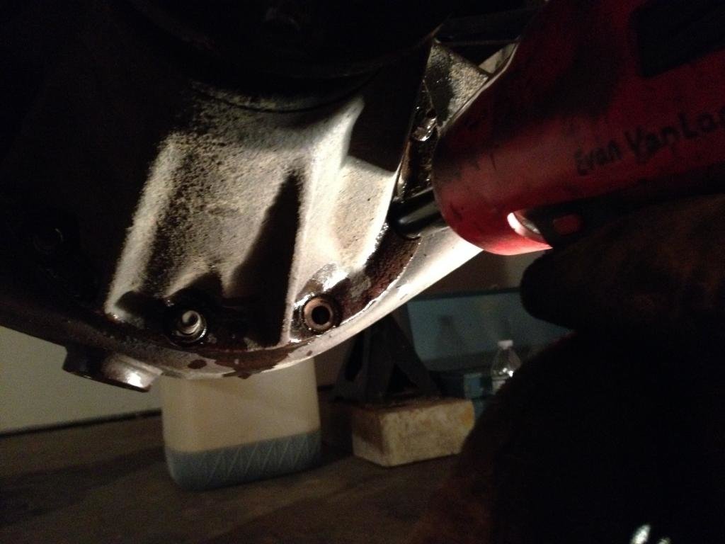

    Then I zipped off the nuts holding the third member. Some of the studs came off along with the nut.
    Ta-da

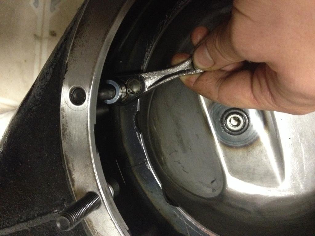

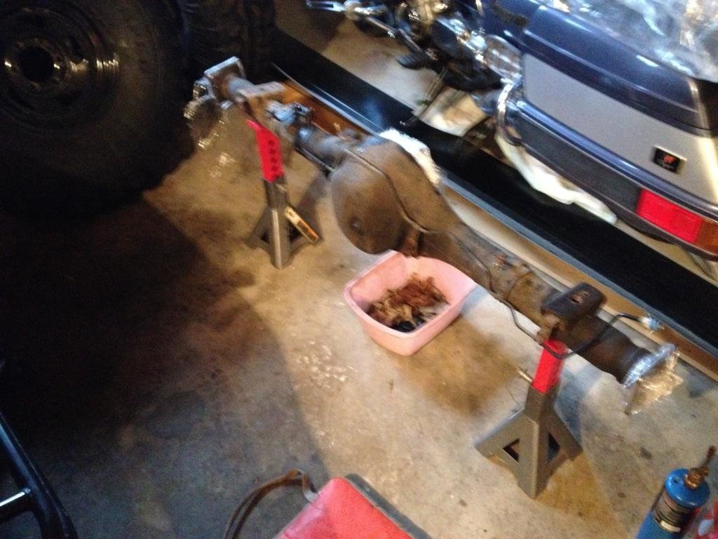

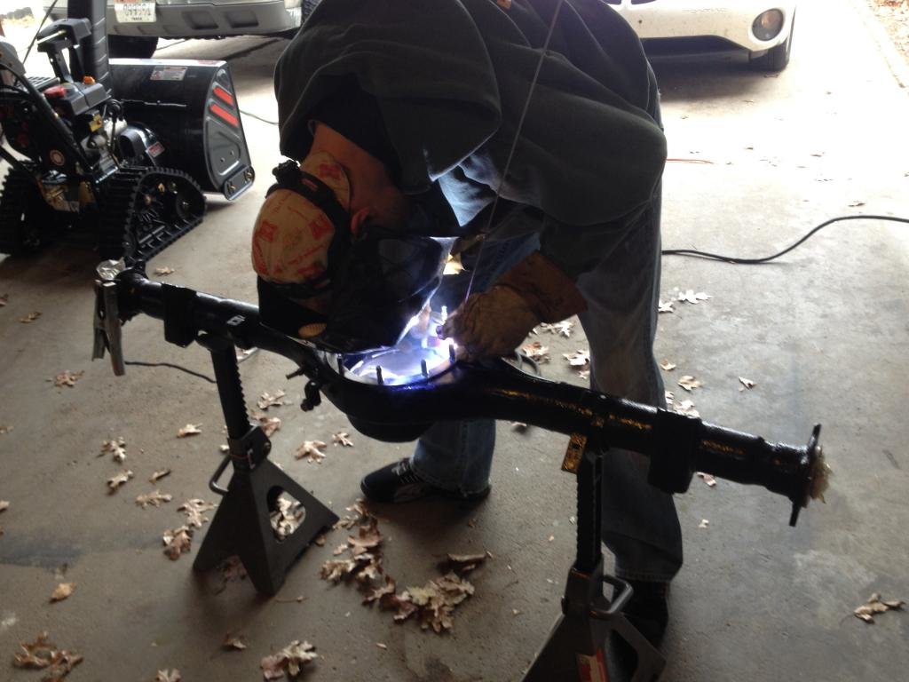

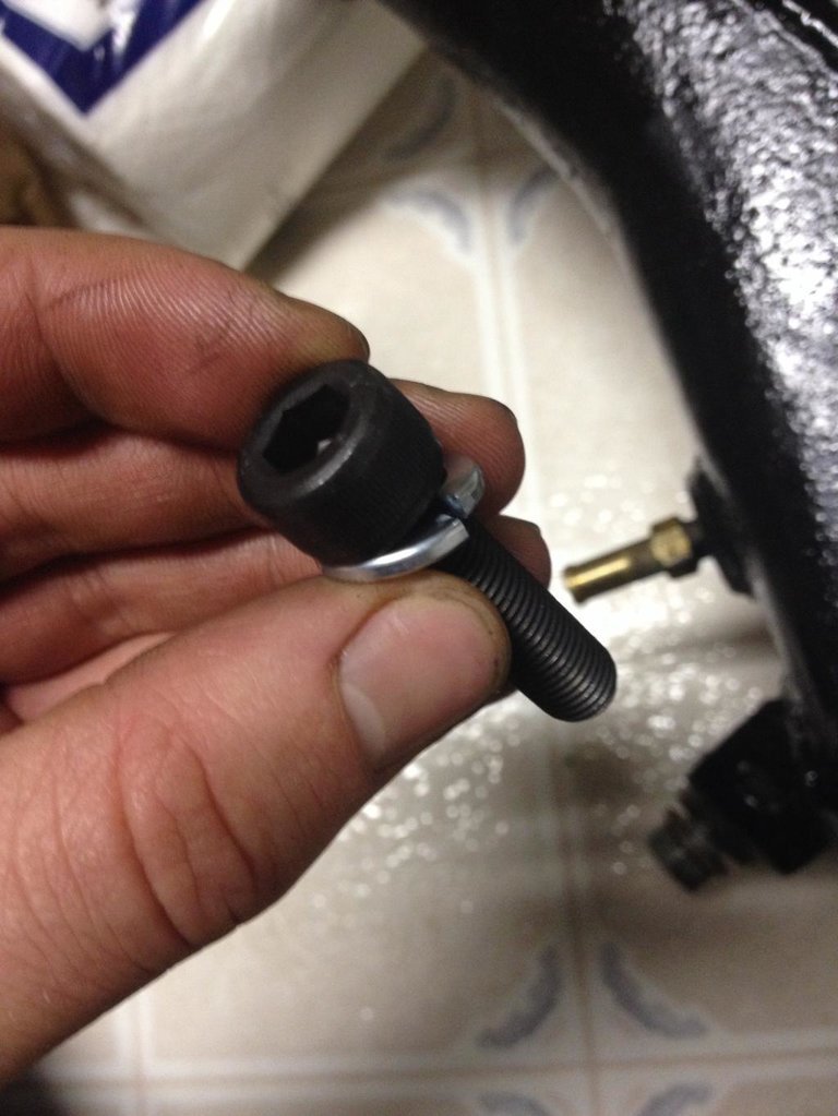

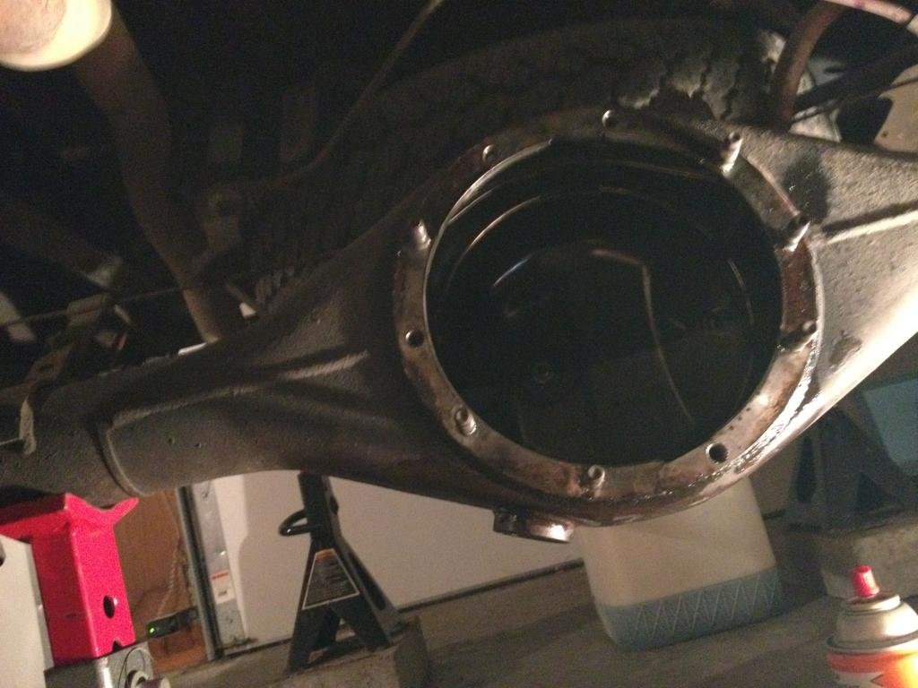

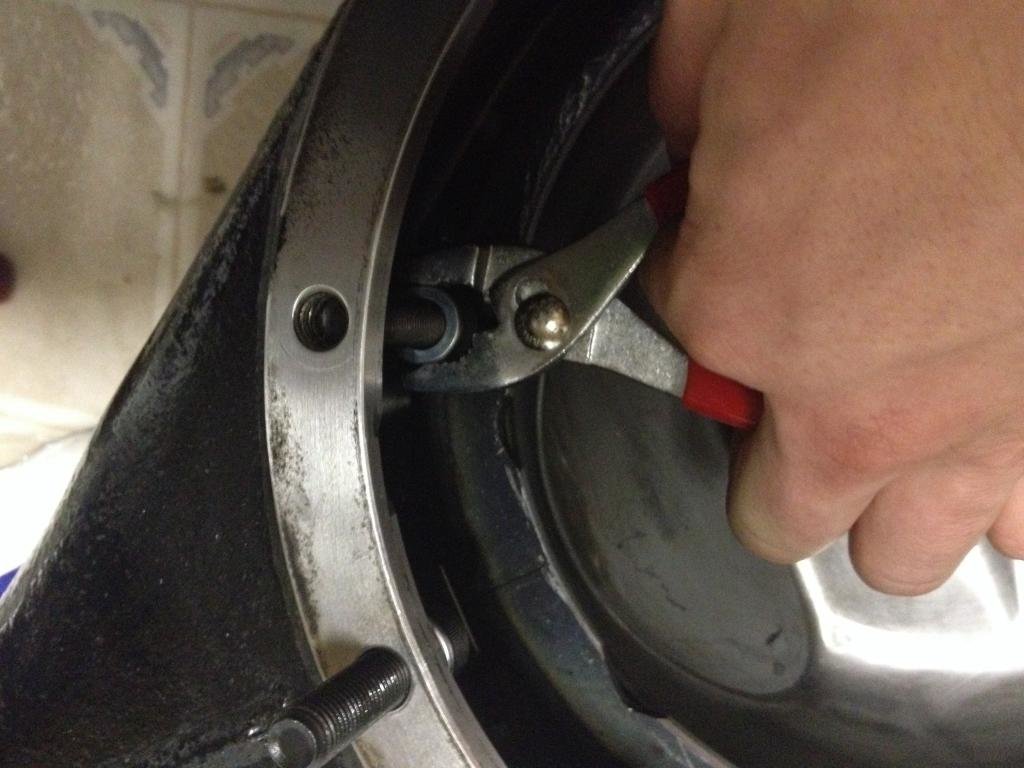

    Rear axle off. Removed brake lines and began cleaning it up.
    Figured I would do a stud eliminator kit while I was at it.
    Just went to a local fastener supply shop and picked up the 10mm - 1.25mm hex nuts and bolts including lock washers (10 each).
    The head of a 1/4" socket wrench fits
    Had my buddy weld the studs in place from the backside. I don't think it was necessary but just an added insurance.
    Ritchie likes this.

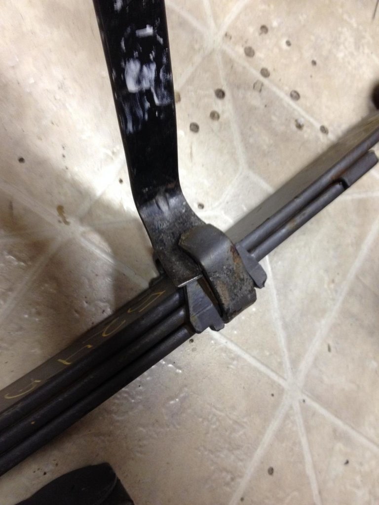

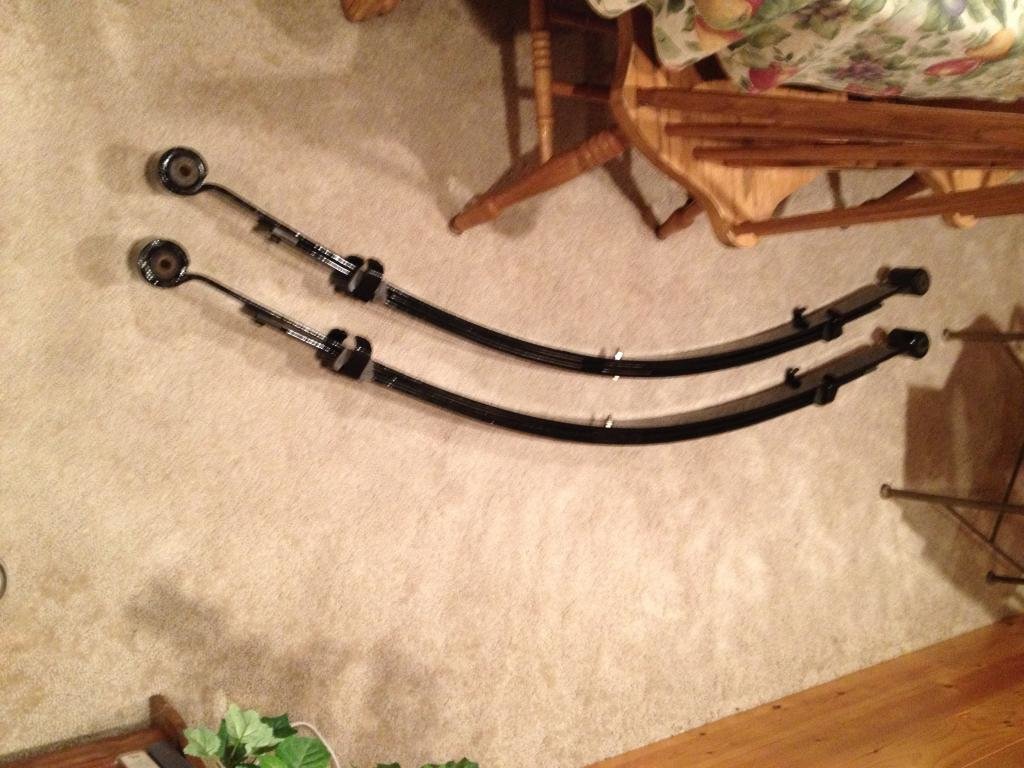

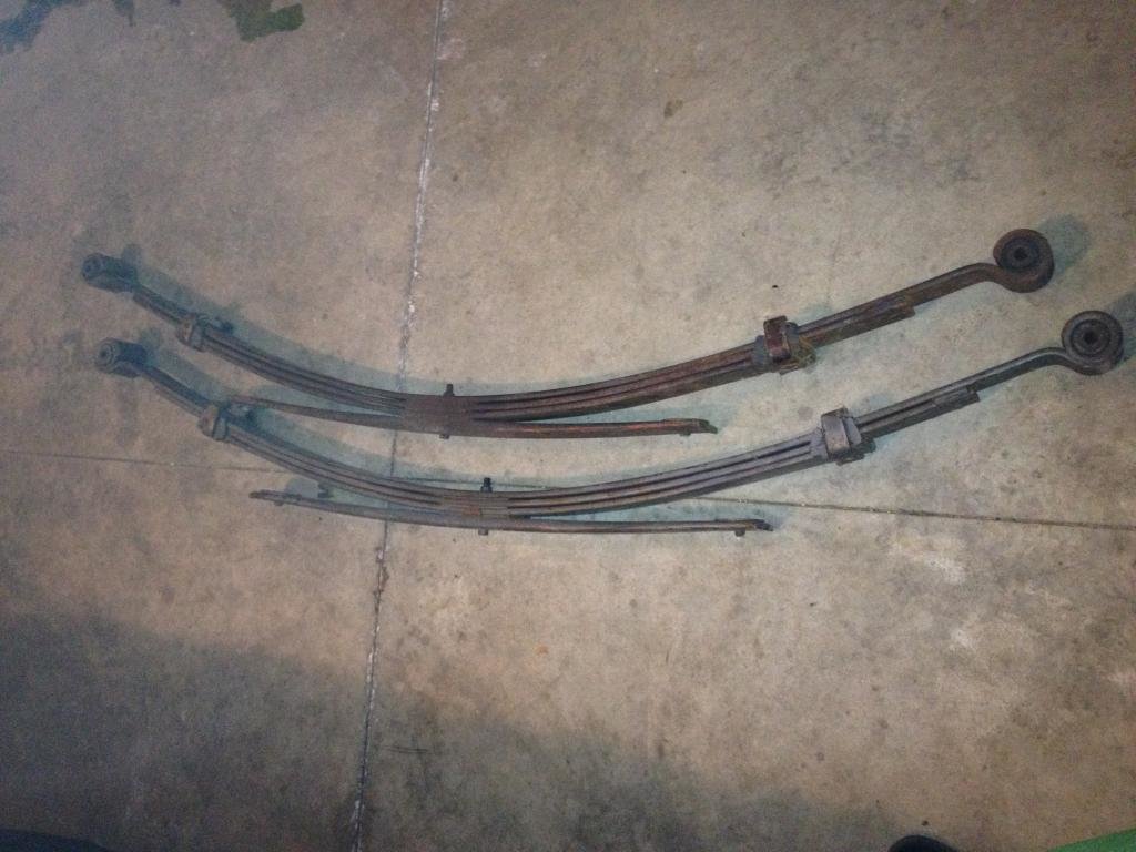

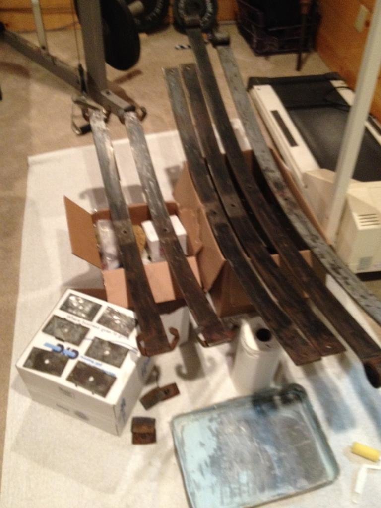

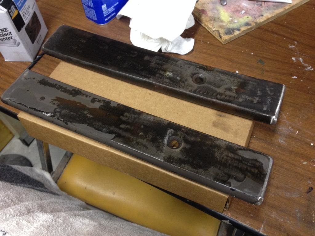

    Also cleaned up the 60" Chevy springs.
    Pirhett likes this.

    Lookin good man! I was gonna ask about the heads on those bolts since I was lookin at doin something similar with an elocker axle I'm building up. There's no clearance issues with that bolt head being so thick? I know the stud eliminator kit has bolts that have a more flush head on them.

    There doesn't seem to be any clearance issue. The only stud eliminator kits I could find had 8mm nuts and bolts. I needed 10mm for my axle, so I had to go this route. It's been done before.

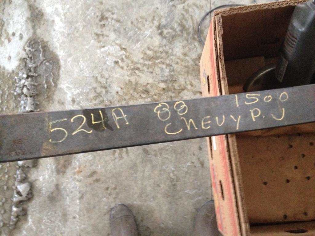

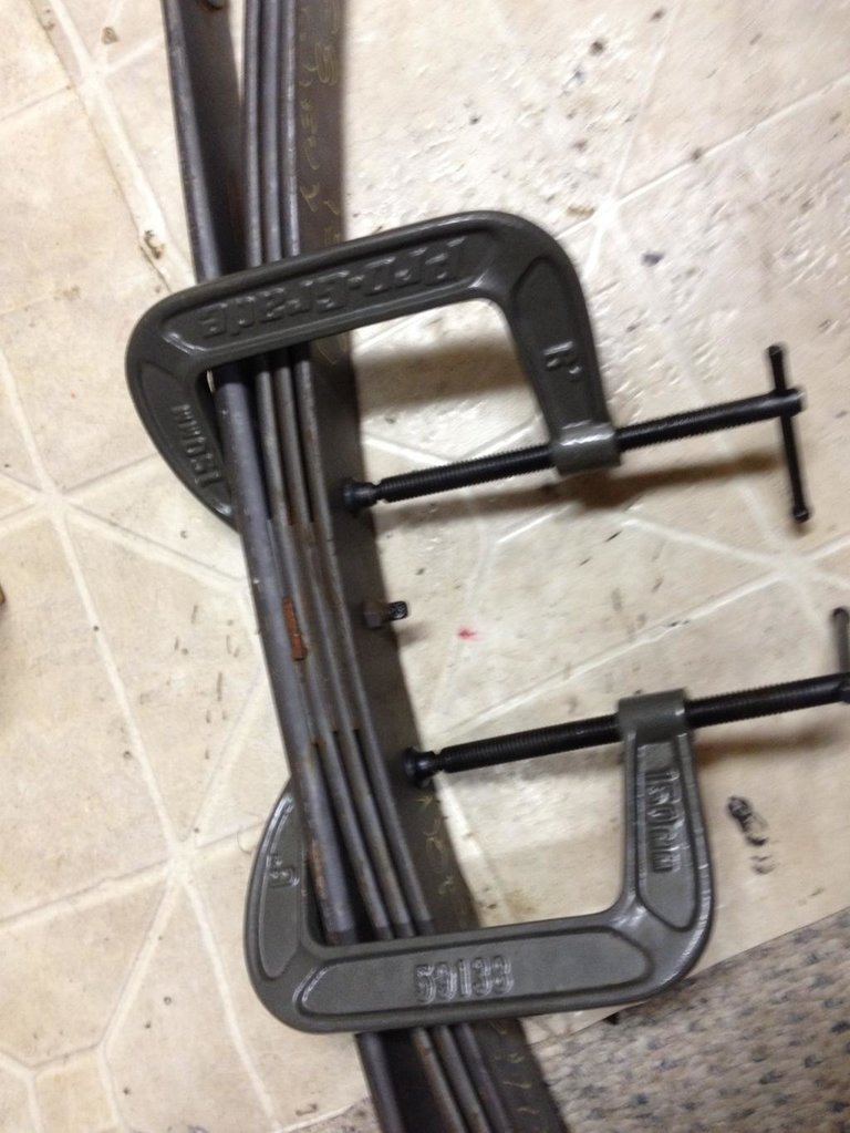

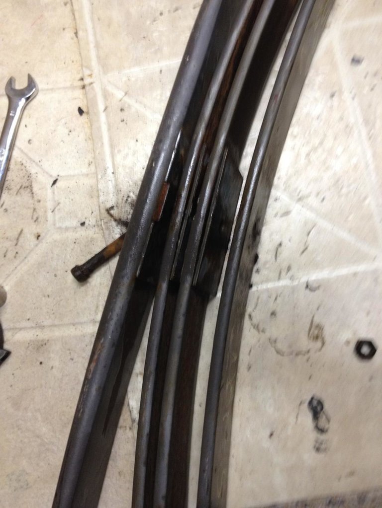

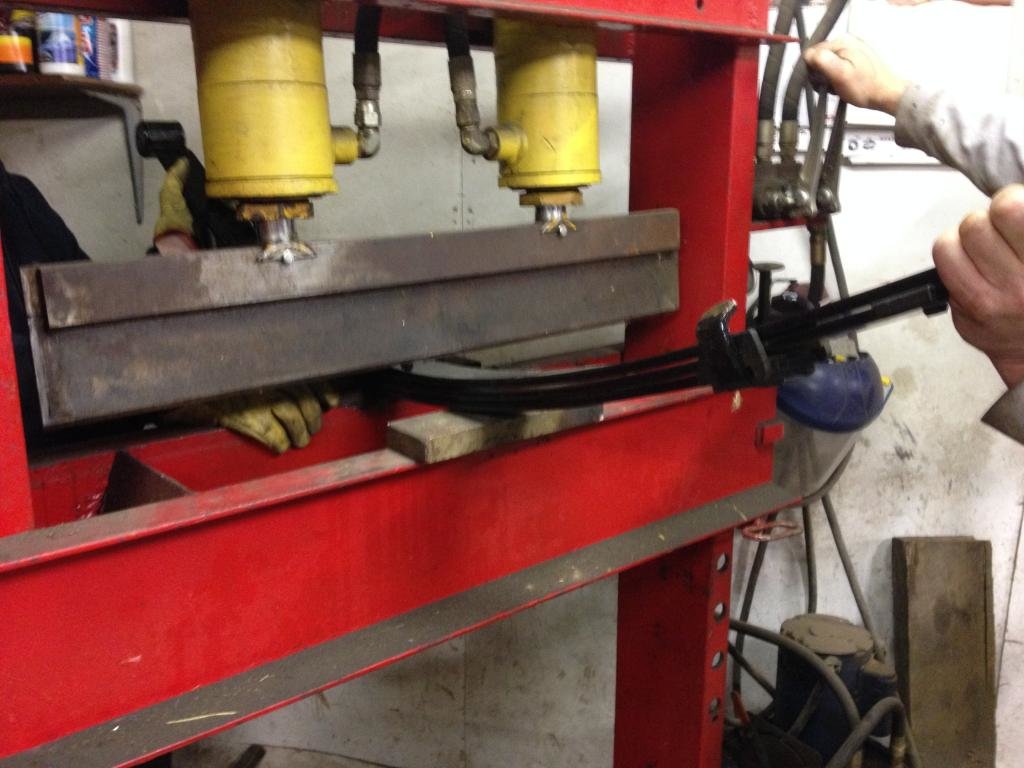

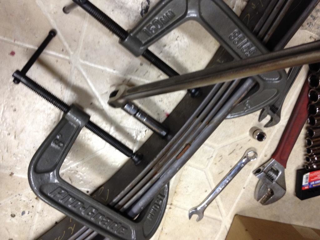

    To get a little more lift out of those chevy springs, I had them arced 2 more inches using a large press.
    The overload leafs could also give me about another 1" of lift so I cut them down enough that they wouldn't get hung up on anything while on the trail.

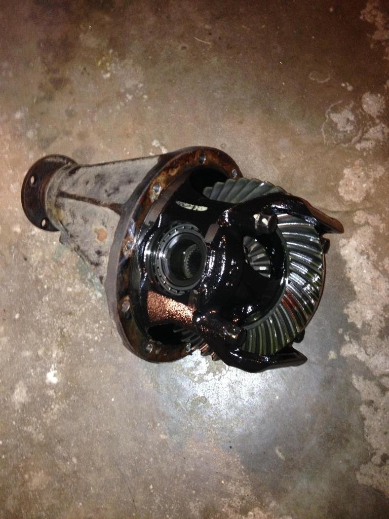

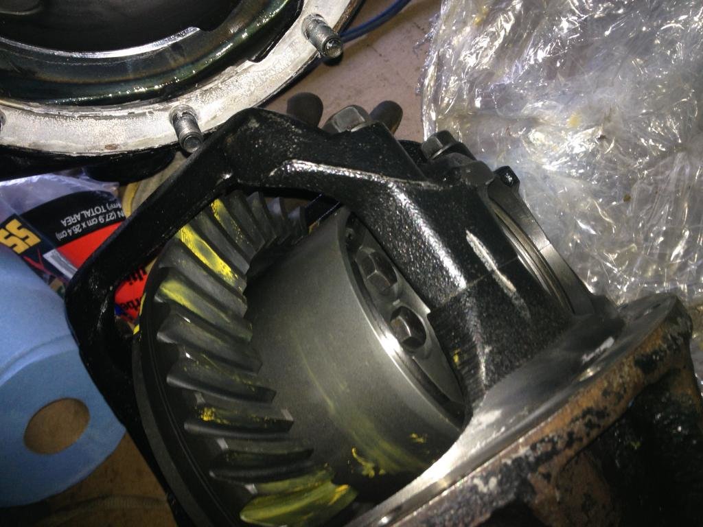

    Rear differential with new 5.29 gears and TrueTrac limited slip case.
    National Drivetrain.com
    5.29 Ring and Pinion (Motive Gears) $207.99
    Master Install Kit $230.00
    TrueTrac Limited Slip Case $403

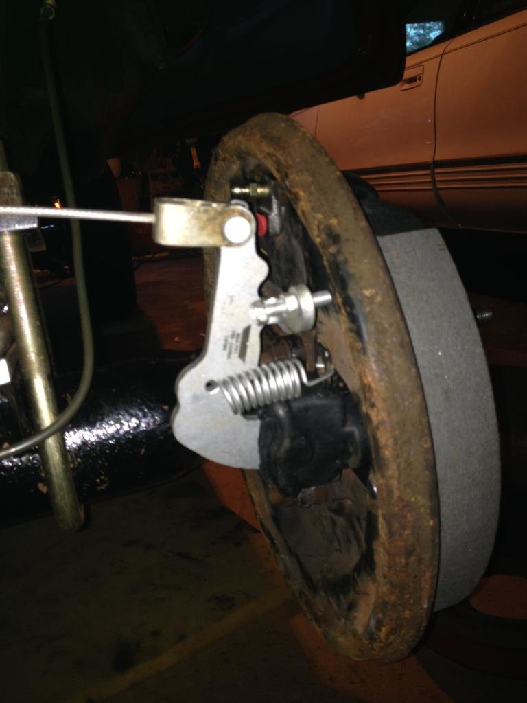

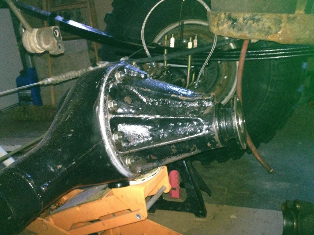

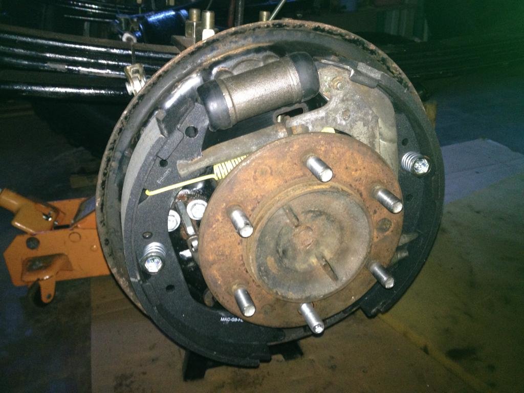

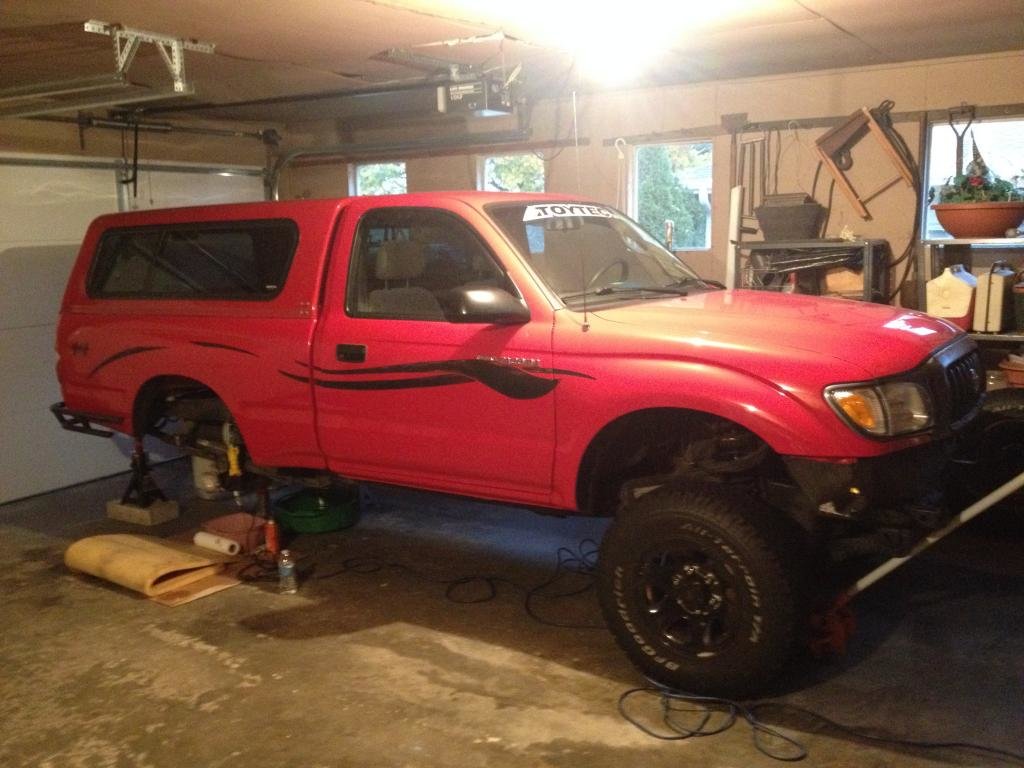

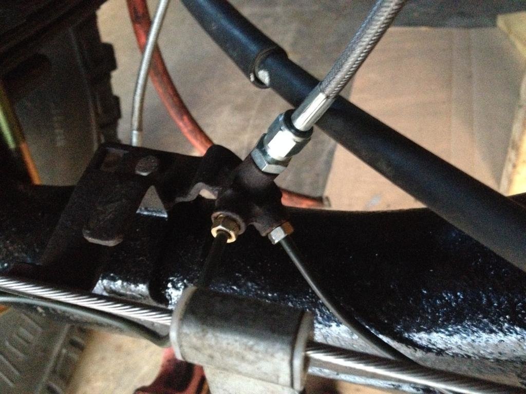

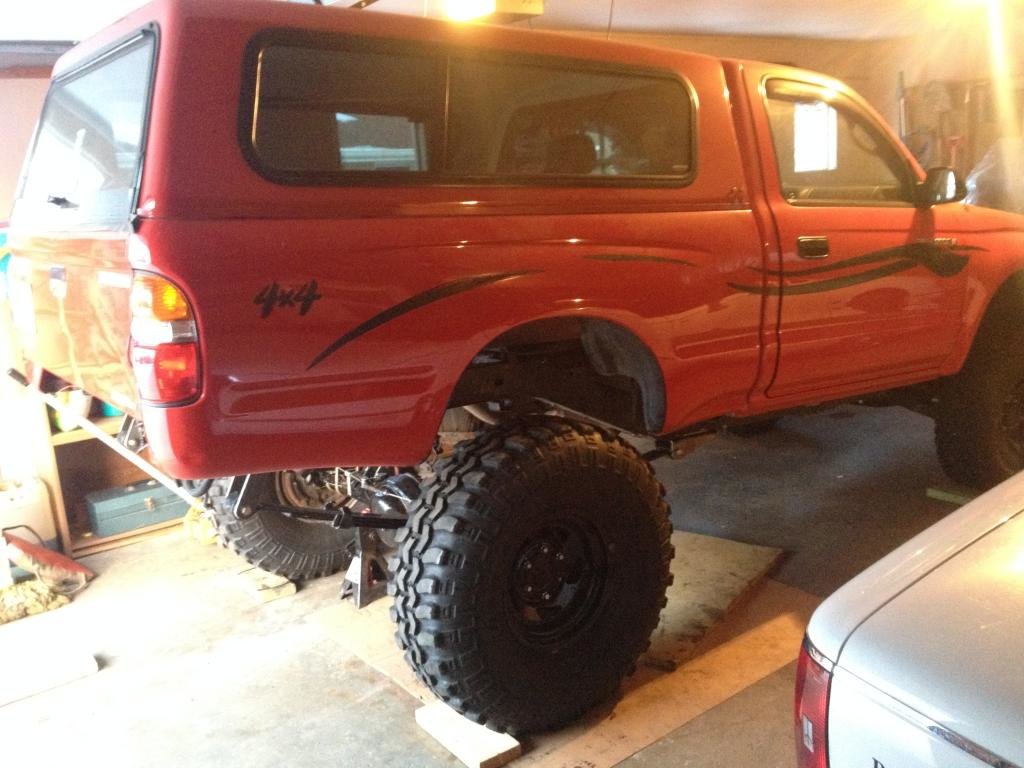

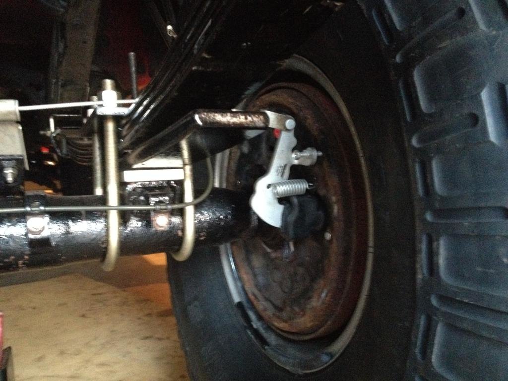

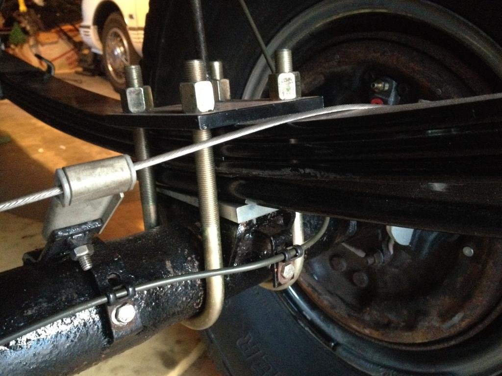

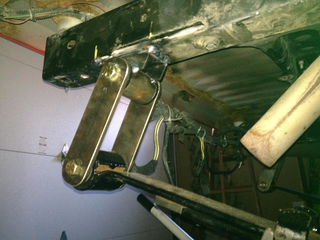

    My buddies and I got the rear springs mounted and the axle underneath the truck. I also installed the new parts for the e-brake and drum brakes.
    Sorry for the lack of pictures. We got most of this done in one night and my phone died quickly in the cold garage.
    Before we cut off the stock springs we wanted to make sure the center point of the new springs would stay in the same place. So we took a laser and marked on the frame where the original springs sat at the center pin.
    After the stock springs were cut off, I put the hangers and the shackles on the chevy springs and we set them up underneath the truck and tacked them in place.. measuring constantly.
    Front spring hangers from Budbuilt.
    Shackle hangers from WFO Concepts. Shackles custom made (3/8" x 2" x 7" steel flat bar)
    Put 4 degree shims under the leaf packs.
    New brake lines and brake hose.
    24" Brake hose from Front Range Off Road
    New e-brake bell crank.
    Fixed up the drum brakes. New springs and brake pads.
    Third member back in place.
    Rear axle sitting under it's own weight.
    Pirhett likes this.
