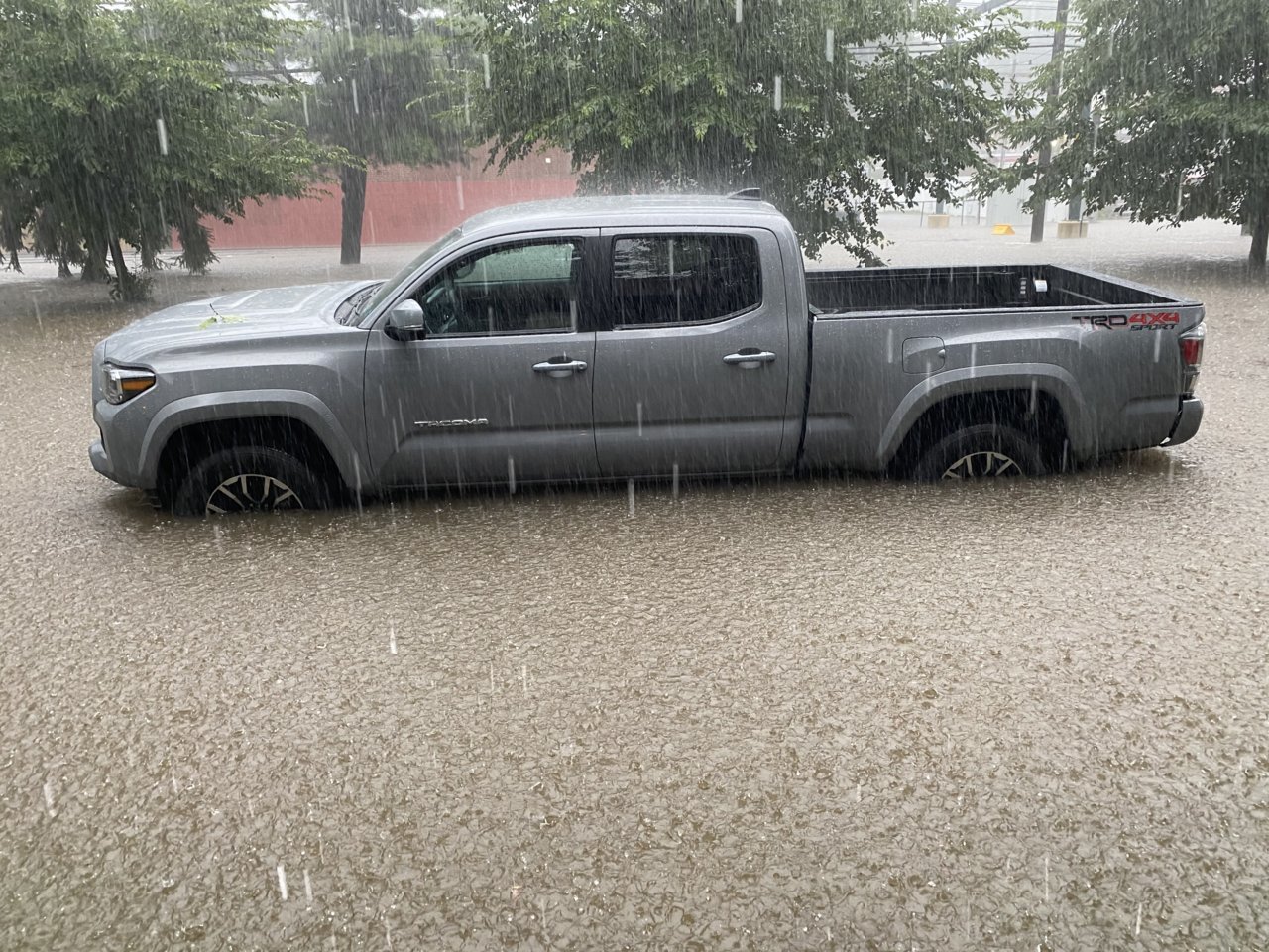

Tacoma sat in Isaias water. Any issues?

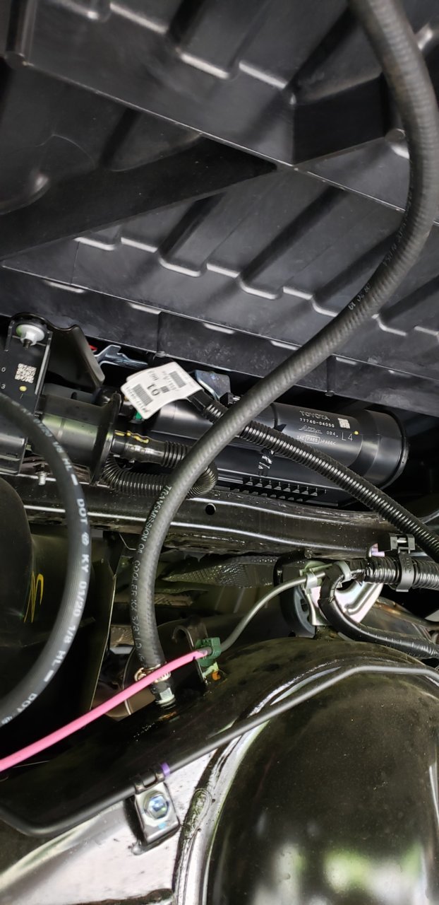

    Extend the rear diff breather.

    Local creek flood, car was parked. I’m not close to any salt water sources.

    OP, you’re over thinking it. Can never tell who is trolling or not on here with some of these replies. It sat for 10 minutes in what I don’t consider that deep of water.
    It’s fine, just drive it

    How high does the rear diff breather goes ?, do you happen to have a picture of it ?...thanks

    Stock wheels and suspension. Random "utilitarian" mods featured on this great forum.
    Picture with the breather mod installed. The oem one is halfway between axle and top of the pumpkin. Water he was sitting in doesn't look like it got above the axle line. Still, if there was rushing water and it did make it past seals, I'd maybe consider doing both diffs but there are guys on here that wheel through way worse and are 'fine'.

    About the centerline of The rear tire.
