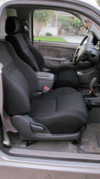

    Swapped to Manual Trans & 4x4
    2005 Scion XB Seats

    What is involved in getting these to fit? Welding?

    You can do it with just a grinder and a dremel but your chair will fall of the tracks. It's not an ez swap with it without a welder.

    Hi, i do have exactly same thing on same truck Tacoma 96 xtracab with split bench I do have the new seats and center console I'm just thinking and over thinking about if ther fit exactly in there, do exactly fit there and what did you do on the center console to make it fit. Thanks for you time
