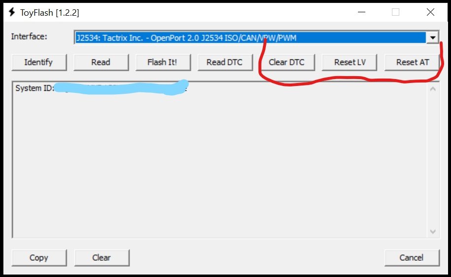

    Mine was consistently 0.5mpg high on the computer (about a 2.5% error). It was so consistent that I could plan fuel stops with it any day. Since I did the DTC and Learn Value Resets with OVT, it has been within 0.1mpg of hand calcs. These same Resets can be done with TechStream. You might want to give that a shot?

    Tonered, what are Dtc and learned value re-sets with OVT?

    If you are dongleless, it is in the ToyFlash window:
