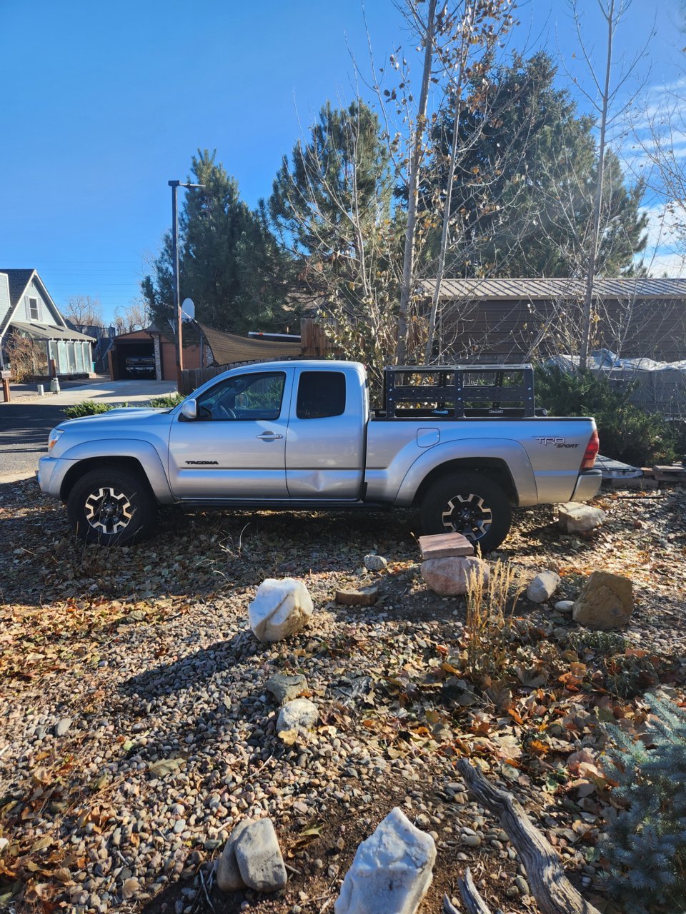

    You only get a half inch raise in the nose switching from Sport to Offroad shocks. And truthfully the sport shocks are better then the offroad for everything except trail (off road) riding. But you won't get a lift just changing the shocks.
    Here is my sport with 2022 OR shocks and front coils. You might be able to see the 1/2 inch in the front. The rear shocks made no change (as expected)
