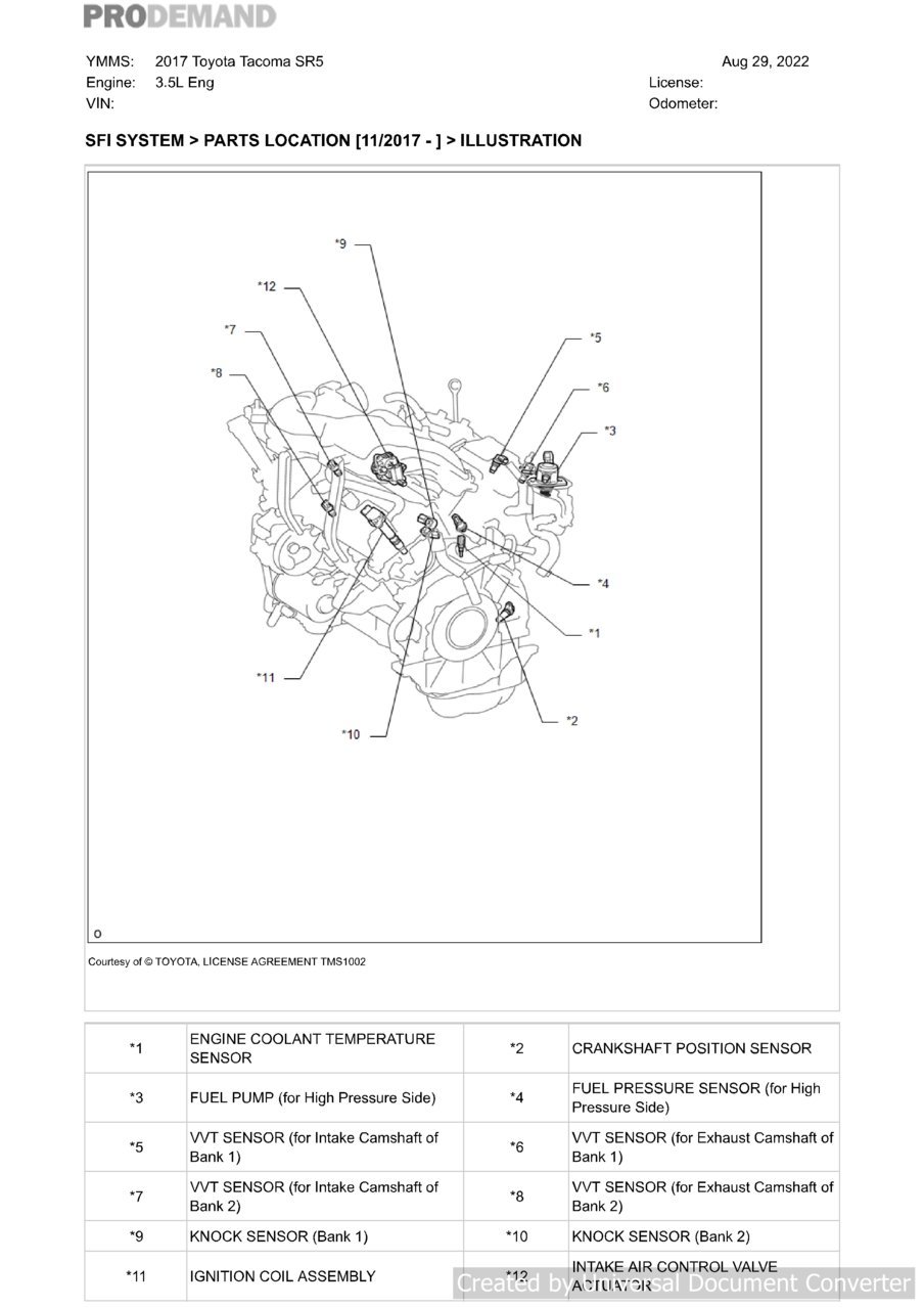

    my 2017 tacoma trd sport showing obd11 code P0128 Coolant temp 157 F degree Engine heater will blow hot air where is the Coolant sensor location on the 2017 tacoma 3.5 engine

    Thermostat might be stuck open

    Thought of that ,engine heats up fairly quick wanted to check coolant temp sensor but have no idea where it is

    I'm thinking probably thermostat as well.
    2GR-FKS Parts Location 1.jpg.

    Thank you will test hopefully it is a faulty sensor little less mess
