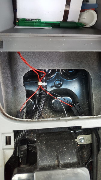

    20170511_172815.jpg the lead off of the ignition wire splits at the shifter with a 7.5 fuse on each side then looks like they it go under the front seats.

    You shouldn't have this type of connections.

    I know somone installed it but what wire is it spliced into...black with red stripe from ignition

    That doesn't look factory. I'm betting that cause of your stalling was most likely the wires exposed and touching each other.

    That's why there is no CEL on. The ECM only reads off sensors and doesn't know what is going on with wires shorting out.

    Man just disconnect all that shit, resolder your wires and properly heat shrink and then figure out what the fuck the PO j-rigged

    Maybe it had a kill switch

    Maybe, but two bundles of wires seems excessive for a kill switch.
    Aftermarket underseat lights or something?

    If the wires aren't cut, just get some good electrical tape like Scotch 33 and go to town.
