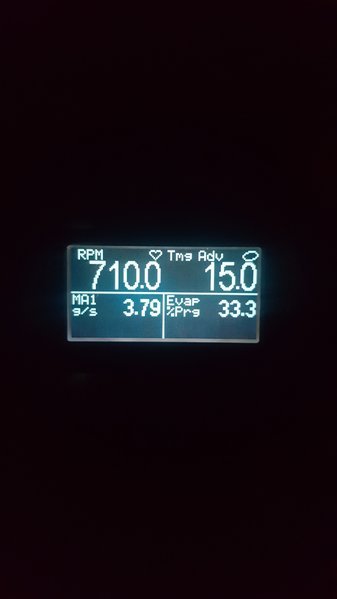

  11. May 11, 2017 at 7:14 PM
    #211
    Reddie2nv
    Reddie2nv [OP] Well-Known Member
    Dec 16, 2014
    #144409
    126
    Charlotte NC
    08 PreRunner TRD Off Road
    20170511_221313.jpg rpm at idle. What should i look for?

  13. May 11, 2017 at 7:16 PM
    #213
    b_r_o
    b_r_o Gnar doggy
    Nov 17, 2016
    #202672
    14,041
    Alex
    WA
    2015 DCLB
    If the rpm is zero that's a bad crank sensor.. The maf is good at around 3 grams at idle. It should go up as you accelerate..
    The real info will come when it stalls , watch closely when it does..
  14. May 11, 2017 at 7:17 PM
    #214
    b_r_o
    b_r_o Gnar doggy
    Nov 17, 2016
    #202672
    14,041
    Alex
    WA
    2015 DCLB
    Don't worry about the timing or the evap pid..
  15. May 11, 2017 at 7:18 PM
    #215
    b_r_o
    b_r_o Gnar doggy
    Nov 17, 2016
    #202672
    14,041
    Alex
    WA
    2015 DCLB
    Check the oil!

  16. May 11, 2017 at 7:19 PM
    #216
    Reddie2nv
    Dec 16, 2014
    #144409
    126
    Charlotte NC
    Ok so i gave it a little gas and as the rpms went down it stalled.
  17. May 11, 2017 at 7:21 PM
    #217
    b_r_o
    b_r_o Gnar doggy
    Nov 17, 2016
    #202672
    14,041
    Alex
    WA
    2015 DCLB
    So crank it again.. if it doesn't start tight away keep cranking make sure the rpm is reading something at least 200 to 300..
  18. May 11, 2017 at 7:23 PM
    #218
    Reddie2nv
    Dec 16, 2014
    #144409
    126
    Charlotte NC
    Cranked right up rpm at 7ish
