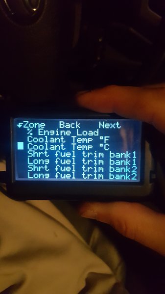

  6. May 11, 2017 at 7:32 PM
    #226
    Reddie2nv
    Reddie2nv [OP] Well-Known Member
    Dec 16, 2014
    #144409
    126
    Charlotte NC
    08 PreRunner TRD Off Road
    It has a lot of shit to choose from. Ill check
  7. May 11, 2017 at 7:34 PM
    #227
    b_r_o
    b_r_o Gnar doggy
    Nov 17, 2016
    #202672
    14,041
    Alex
    WA
    2015 DCLB
    Look for fuel trims in a percentage.. a 02 voltage may be useful but trims are better

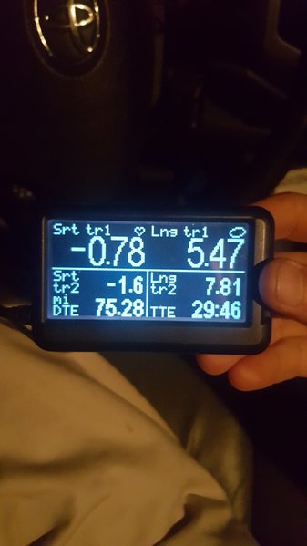

  10. May 11, 2017 at 7:37 PM
    #230
    Reddie2nv
    Dec 16, 2014
    #144409
    126
    Charlotte NC
  11. May 11, 2017 at 7:38 PM
    #231
    Reddie2nv
    Dec 16, 2014
    #144409
    126
    Charlotte NC
    Fluctuate from -1.6 to -0.78
  12. May 11, 2017 at 7:40 PM
    #232
    b_r_o
    b_r_o Gnar doggy
    Nov 17, 2016
    #202672
    14,041
    Alex
    WA
    2015 DCLB
    The trims look pretty good man.. they're close to zero.. that means that the fuel system has pretty good control of the fuel consumption, that rules out a maf sensor or fuel pump or oxygen senspr..

  14. May 11, 2017 at 7:42 PM
    #234
    b_r_o
    b_r_o Gnar doggy
    Nov 17, 2016
    #202672
    14,041
    Alex
    WA
    2015 DCLB
    Know what I mean.. if the engine was gasping for fuel it would have positive trims like as hi as 20 to 25 percent.. asking for more fuel but not getting it..

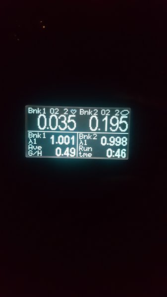

  17. May 11, 2017 at 7:52 PM
    #237
    b_r_o
    b_r_o Gnar doggy
    Nov 17, 2016
    #202672
    14,041
    Alex
    WA
    2015 DCLB
    Those are just 02 voltages.. they're normal. That's where the fuel calc stuff gets it's info.. if the trims(fuel calc) are normal then the 02s are doing what they are supposed to do..

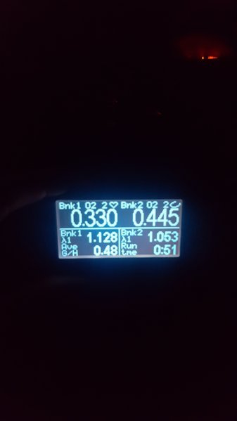

  18. May 11, 2017 at 7:54 PM
    #238
    Reddie2nv
    Dec 16, 2014
    #144409
    126
    Charlotte NC
    20170511_225324.jpg right before stall the o2 went up to this
  19. May 11, 2017 at 8:02 PM
    #239
    Reddie2nv
    Dec 16, 2014
    #144409
    126
    Charlotte NC
    This time trying to restart was like there was no key inserted.
  20. May 11, 2017 at 9:15 PM
    #240
    b_r_o
    b_r_o Gnar doggy
    Nov 17, 2016
    #202672
    14,041
    Alex
    WA
    2015 DCLB
    That looks good tho.. 02s are normal, right below where is says 1.028 and the other number to the right are both fuel calc numbers similar to the short and long trims. They are both close to a value of 1.0 (good, fuel calc under control)same thing as when your trims are around zero (plus and minus). Basically it looks like the engine is getting all the fuel it needs ..
