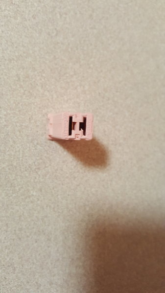

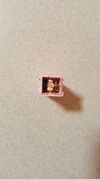

    20170520_151156.jpg 20170520_151156.jpg 20170520_151245.jpg i think i found the problem. This is my 30a AM2 fuse. Looks like one end of the fuse didnt slide over the pin and pushed it up not making a good connection and was probably triping my c/opn relay.

  9. May 20, 2017 at 12:55 PM
    #309
    b_r_o
    b_r_o Gnar doggy
    Nov 17, 2016
    #202672
    14,628
    Alex
    WA
    2015 DCLB
    Looks like it pushed the female terminal up!
  10. May 20, 2017 at 12:59 PM
    #310
    Reddie2nv
    Reddie2nv [OP] Well-Known Member
    Dec 16, 2014
    #144409
    126
    Charlotte NC
    08 PreRunner TRD Off Road
    Definitly did. Wish me luck. Thanks for all the help.
  11. May 20, 2017 at 1:00 PM
    #311
    b_r_o
    b_r_o Gnar doggy
    Nov 17, 2016
    #202672
    14,628
    Alex
    WA
    2015 DCLB
    Good job man..

  16. Aug 19, 2021 at 4:11 PM
    #316
    BernTaco05
    BernTaco05 New Member
    Aug 19, 2021
    #374664
    05 Taco
