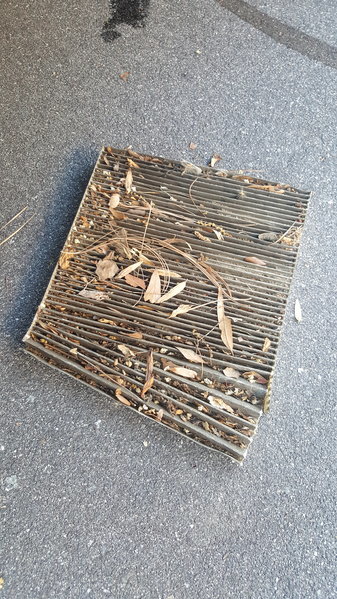

    20170510_175914.jpg thought everyone would get a kick out of this as well. Starting to get really worried about my purchase.

  12. May 10, 2017 at 3:05 PM
    #132
    tcjacado
    tcjacado Well-Known Member
    Aug 29, 2016
    #195947
    41,570
    I think there might be a relic from the dark ages in there. :rofl:
    lynyrd3 likes this.
  13. May 10, 2017 at 3:05 PM
    #133
    b_r_o
    b_r_o Gnar doggy
    Nov 17, 2016
    #202672
    14,628
    Alex
    WA
    2015 DCLB
    No that's fine.. it's just sorry because it's been doing it's job
    tcjacado likes this.
  14. May 10, 2017 at 3:05 PM
    #134
    b_r_o
    b_r_o Gnar doggy
    Nov 17, 2016
    #202672
    14,628
    Alex
    WA
    2015 DCLB
    It's just dirty...
  15. May 10, 2017 at 3:06 PM
    #135
    tcjacado
    Aug 29, 2016
    #195947
    41,570
    It's sorry too, that it couldn't last another week.
