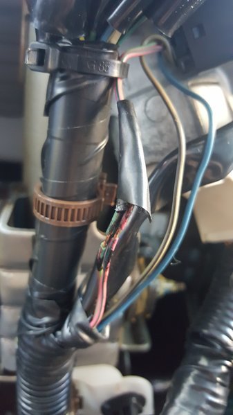

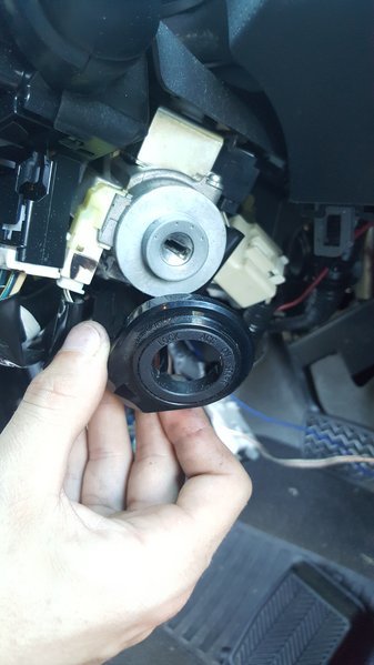

    The pink and green wire go to the black LOCK ACC ON START ring. But what does that piece do for the ignition?

    The ring around the ignition is there to recognize a coded chip in the ignition key

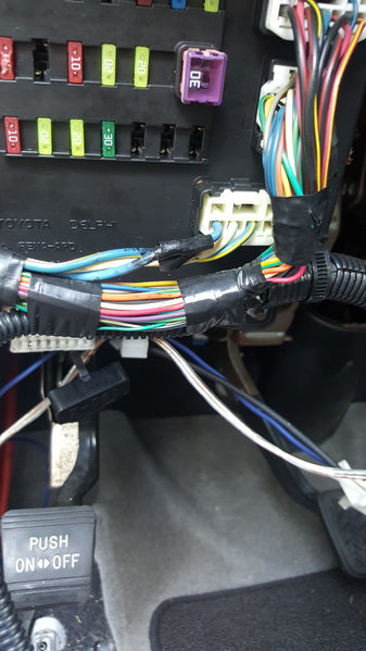

    I am not sure op, it looks as if those wires are supposed to be there. Clean them up. I would start with a good round of electrical tape and see if problem goes away. If it does then go back and solder and clean up proper like.

    You might be right there at the problem, fix the wires carefully. What you're looking at is encouraging to see

    Hold on to your crank sensor. The crank sensor can only work as good as the wiring going to it from the computer and the computer can only work as good as the wiring powering it up from the ignition switch
