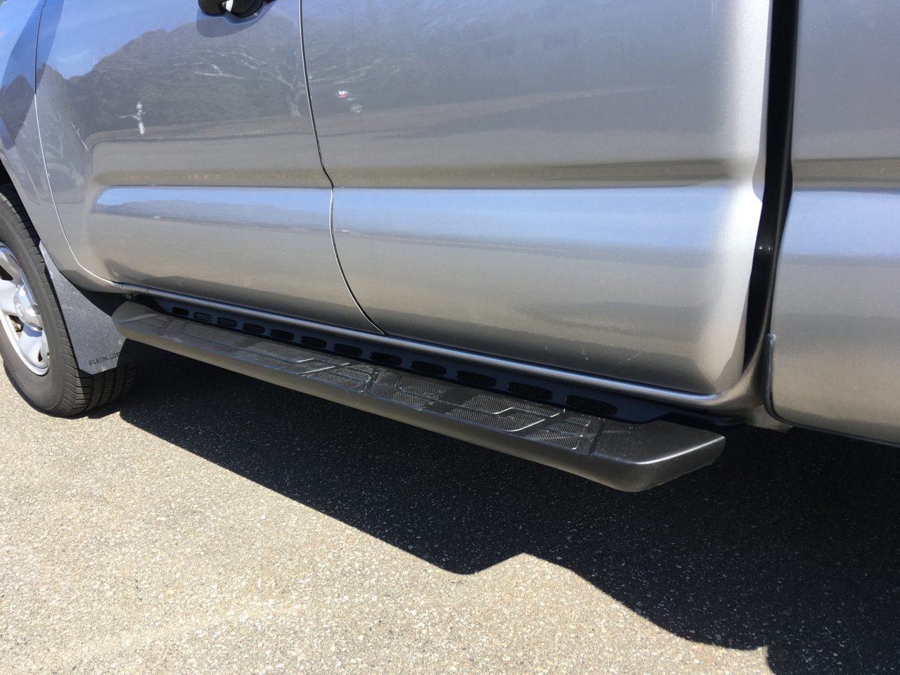

    Tip:
    2'nd generation OEM steps fit 3'rd generation Tacomas, even though Toyota says they won't. Bolt right up without any drilling.

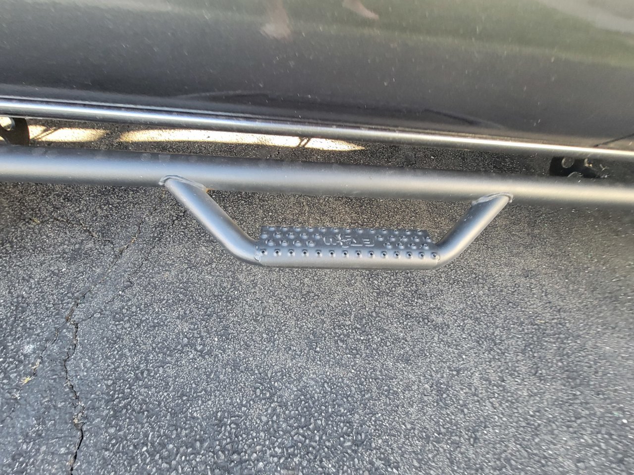

    These work great for little people.

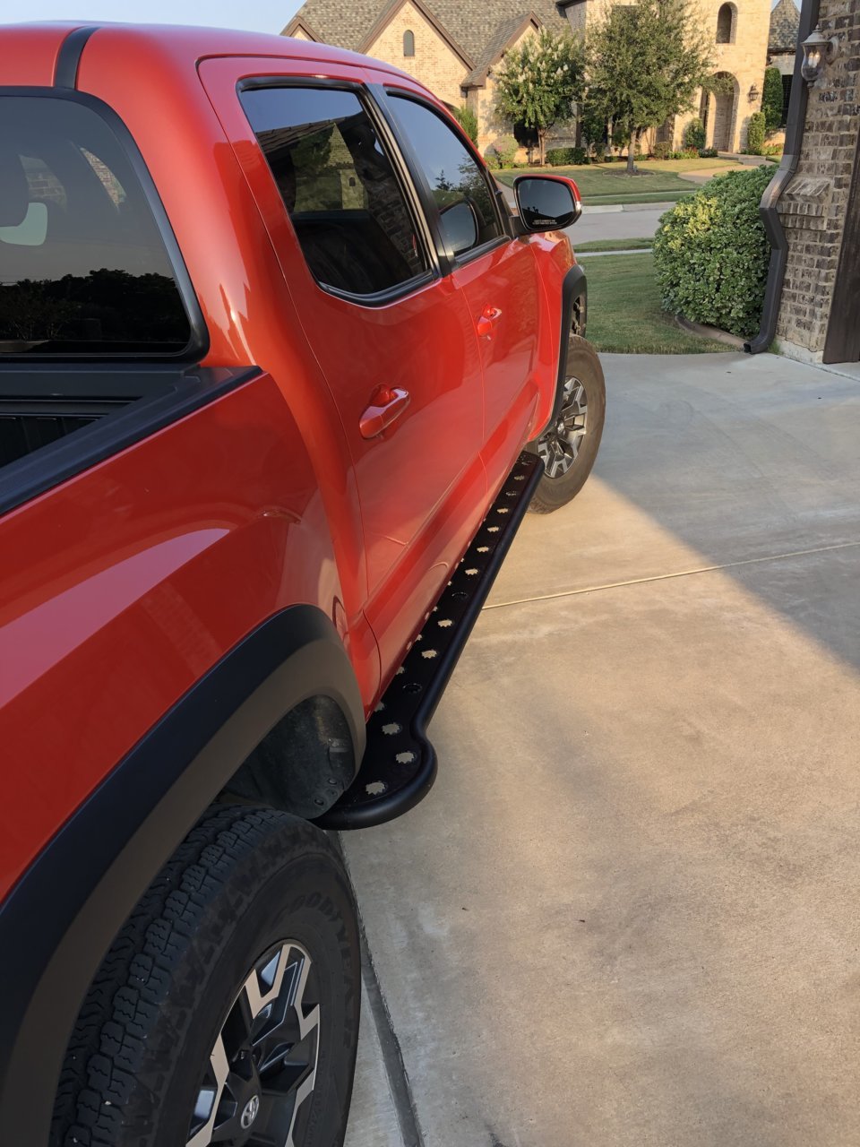

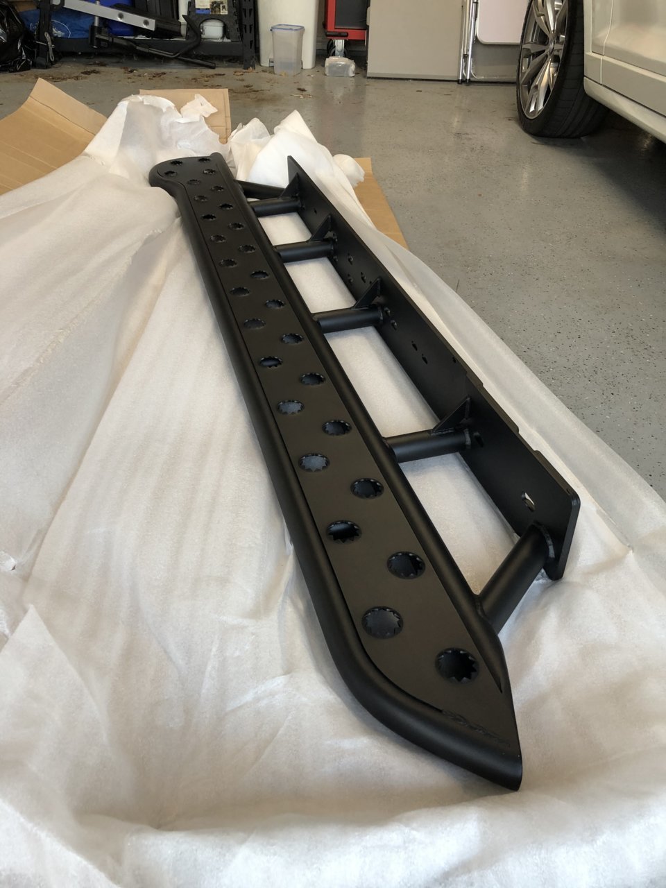

    As said previously, any slider that’s large enough to step on is going to be in the way if you don’t want to use it. I had a pair of custom sliders made and I was very particular about the extension. They are *just* big enough to stand on with your toes tucked up against the rocker panel. And I can *just* get in and out without dragging my slacks on them. My wife… not so much. She’s keeps a really clean spot on them on her side from where she rubs against them getting in and out.
    I’ve considered moving down to simple rock rails. In short, you can get some custom work done but in the end it may not fit the criteria; i.e. the two needs may not be compatible. And it’ll be expensive!
